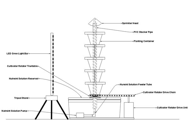

I have a load, my cultivator unit, that will be about 3' - 4' tall, maybe 12" to 18" in diameter and weigh between 20 and 40 lbs. The whole thing will be mounted on a lazy susan style turntable. The plan is to have a gear or pulley at the bottom that will be used with a hight torque stepper motor, and chain or belt, to rotate the cultivator. I'm using a stepper motor because they are pretty efficient and can be controlled very easily at very slow speeds. I want the rotation speed to be maybe 3 to 4 revolutions per day. A stepper would work well for this I think.
I have no idea how to properly size the motor. I see them speced at anywhere from 10s of oz-in to 1000s of oz-inches of torque. I get the concept of torque being rotational force. And that required torque has to do with acceleration time up to the desired RPM. But I have no idea how to relate this to my requirements.
I'm a 'puter software with some dangerous electronics knowledge guy! HELP!!! And feel free to tell me this just a stupid idea and I should be using a washing machine motor or something if that's the case.
For reference, here's a drawing of the rig. Note the drive at the bottom right. Please excuse the misspelled labeling. I haven't gotten around to correcting it yet. lol...

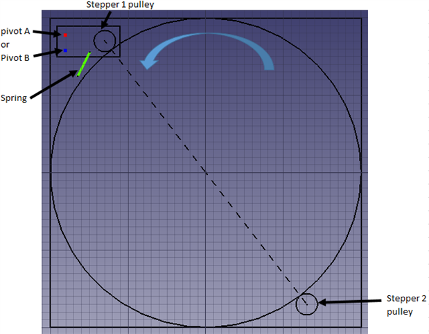

    mcb1 over 11 years ago in reply to RWReynolds
    RWReynolds
    It looks like your design is coming together.
    Two comments.
    The stepper I linked to, Terry made this comment.
    This means your pulse number might be lower. (half)
    With the geared output you already have increased the step angle by 64, so you don't require 8 steps ...
    The output angle per pulse is close to 0.178 deg.

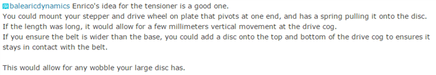

    balearicdynamics Enrico's idea for the tensioner is a good one.
    You could mount your stepper and drive wheel on plate that pivots at one end, and has a spring pulling it onto the disc.
    If the length was long, it would allow for a few millimeters vertical movement at the drive cog.
    If you ensure the belt is wider than the base, you could add a disc onto the top and bottom of the drive cog to ensures it stays in contact with the belt.
    This would allow for any wobble your large disc has.
  • RWReynolds
    RWReynolds over 11 years ago in reply to mcb1
    Thanks for the info mcb1.
    I will take into account the info on the steps per revolution. On one of the sites where I researched the motor it did say 4096. I will have it connected soon to a Raspberry Pi for testing. Then I can work out the exact pulse count and timing required.
    I was planning to mount the motor in such a fashion as to allow for some spring tensioning against the timing gear. I just have to work out the mount now.

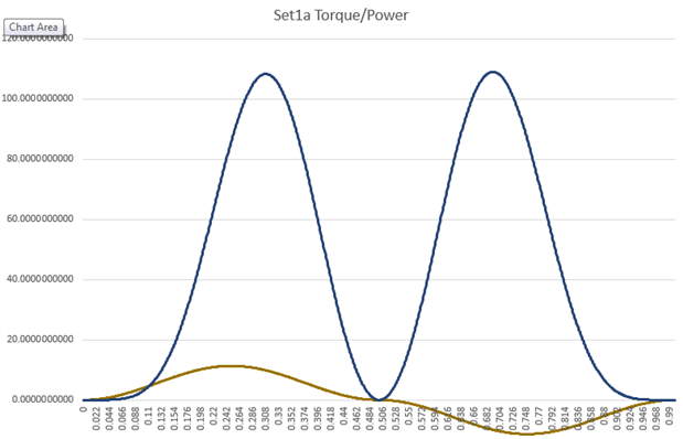

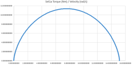

    Fist post here. I hope it's ok to continue on an old thread - there are some similarities to my current project.
    It's a long time since I attempted any angular motion calculations - so please forgive any obvious mistakes...I have ignored friction below on the assumption it will be negligible compared to torque/power required for acceleration (not sure if that is wise though).

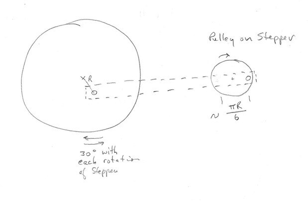

    I'd like to use a stepper (or steppers if needed) to rotate a plywood disk (with a person standing on top) of 1200 mm dia 30° in 1.25 secs. The timing belt drive disk will be 1160 mm dia as the centre of a 1200/1160/1200 mm sandwich with a lazy susan on the bottom. I plan to use something like the AccelStepper library (not sure if providing a link to that is ok?) to do:

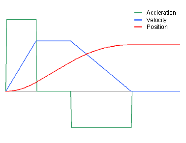

    1. from rest provide constant acceleration for 0.5 secs
    2. constant angular velocity for 0.25 secs
    3. const decelerate for 0.5 secs to rest
    I calculated the approximate moment of inertia (plywood + person as 100 kg point load on perimeter of disc) as 39.16kgm2
    Torque/Power Calculation:
    Say, use Accelstepper Library to apply the above:
    (i) constant acceleration, α, (from 0 rad/s) for 10° to maximum ω rad/s. Say time taken = 0.5 secs
    (ii) zero acceleration for 10° to 20°. Say time taken = 0.25 secs
    (iii) constant deceleration , α,  from 20° to 30° for 10° (from  ω rad/s to 0 rad/s). Say time taken = 0.5 secs
    i.e. total time taken is 1.25 secs for 30° start-to-stop
    Considering only item (i) for now:
    Angular Displacement, θ = 10° (or  0.1746 rads)
    For rotational motion with constant Angular Acceleration:
    θ = (1/2)(ω0 + ω)t
    since ω0 = 0 rad/s
    0.1746 = 0.5 (0 + ω) 0.5 -> ω = 0.1746 / 0.25 -> ω = 0.6984 rad/s
    α = (ω - ω0)/t -> α = (0.6984 - 0)/0.5 -> α = 1.3968 rad.sec-2
    Torque required to produce this stated radial acceleration:
    τ = Iα -> τ = 39.16 x 1.3968 Nm -> τ =  54.7 Nm (Max)
    Force required to produce this Torque:
    τ = Fd so F = τ / d
    "d" for the disk with the glued on timing belt is = 1160mm/2 = 0.58m
    therefore
    F = τ / d -> F = 54.7 / 0.58 -> F = 94.31 N
    Work done by torque τ is W = τ x θ
    Power, P = d/dt(W) = d/dt( τ x θ ) = τ x dθ/dt
    since ω = dθ/dt
    Power = τ x ω
    Power = 54.7 x 0.6984 -> Power = 38.2 Watts (Max)
    Question(s):
    I have a rough idea how a stepper works but i'm not really sure how to specify a particular stepper/gearing ratio to "make this happen" - any ideas along that route would be most appreciated (based on quoted power alone I have a feeling I may need 2 x Nema 42!!).
    Other:
    of related interest - using an 80MHz processor (compared to a 16MHz Arduino Uno) increases the Accelstepper acceleration 5 fold e.g. https://www.youtube.com/watch?v=Hsl3dbRPLTw
    ...that e.g. used a bipolar nema 34 at 1.8°/step (200steps/rev)
    jw0752 over 10 years ago in reply to e14 Contributor
    Hi Andrew,
    Your person standing on the turntable makes any specific calculation of the torques involved very difficult. The structure of the human body will absorb the movement and only follow a 1.5 second rotation in an elastic manner. To smooth out the rotation I would consider 15 degrees of acceleration and 15 degrees of deceleration. This will slightly improve the amount of torque needed and should improve the overall feel of the rotation to the subject. Foot position of the subject on the disk should not affect overall torque but an imbalance of weight distribution may make friction in the bearings a factor that needs to be considered. Foot position may also affect the amount of elasticity in the bones and muscles of the body and hence change the dynamics of the rotation. By over engineering the problem you should be able to make it work.

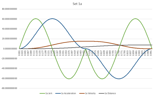

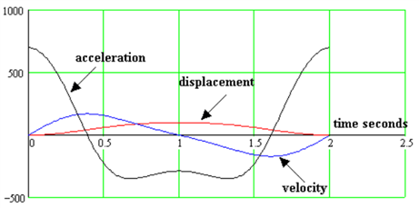

    I'd prefer something approaching a sinusoid (i.e. zero, slight +ve, large +ve, slight +ve, zero, slight -ve , large -ve, slight -ve, zero) for the acceleration profile but I haven't looked in detail whether that can be approximated by a series of steps through the AccelStepper library yet.

    Having reviewed the "trapezoidal velocity profile" produced by the the positive accel pulse / zero accel / negative accel pulse i'm no longer sure the sinusoid accel profile I had referred to would be any better than this:

    The reason I suggested a steadily accelerating and decelerating program is that for any time frame it will have the lowest dv/dt. Any time spent at constant velocity is a waste and only creates the need for higher torques and higher accelerations at the beginning and ends of the cycle.

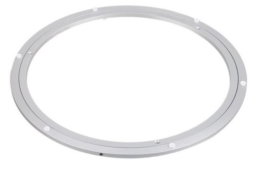

    Well, I received my 390mm dia lazy-susan a while back (image attached) but it'll sit in a corner some more yet.
    Reading lots that I hadn't been aware of e.g "inertia-matching" it seems direct-coupling of gearhead/stepper to the turntable may be preferable (neither had I been fully aware of the reduction in reflected load inertia by the square of the gearbox ratio).
    While a direct coupling scenario does work around some complexity (belt-drive redundancy / no requirement for circular ply) I can't say that the lazy-susan bearing is the most accurate "circle" i've ever come across (the bearing is a little sticky at a point to rotate by hand).
    Perhaps the accuracy that would be required via a direct coupling from the gearhead output to the underside of the plywood make this newly conceived contrivance impractical?
    If someone where to comment on this point it would be useful. However, if the idea where seen as potentially practical then any hint to the nature (by example) of a gearhead shaft to underside of plywood "coupler" would be appreciated as I have very little idea what that could be.
