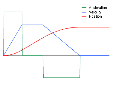

    I'd like to use a stepper (or steppers if needed) to rotate a plywood disk (with a person standing on top) of 1200 mm dia 30° in 1.25 secs. The timing belt drive disk will be 1160 mm dia as the centre of a 1200/1160/1200 mm sandwich with a lazy susan on the bottom. I plan to use something like the AccelStepper library (not sure if providing a link to that is ok?) to do:
    1. from rest provide constant acceleration for 0.5 secs
    2. constant angular velocity for 0.25 secs
    3. const decelerate for 0.5 secs to rest
    I calculated the approximate moment of inertia (plywood + person as 100 kg point load on perimeter of disc) as 39.16kgm2
    Torque/Power Calculation:
    Say, use Accelstepper Library to apply the above:
    (i) constant acceleration, α, (from 0 rad/s) for 10° to maximum ω rad/s. Say time taken = 0.5 secs
    (ii) zero acceleration for 10° to 20°. Say time taken = 0.25 secs
    (iii) constant deceleration , α,  from 20° to 30° for 10° (from  ω rad/s to 0 rad/s). Say time taken = 0.5 secs
    i.e. total time taken is 1.25 secs for 30° start-to-stop
    Considering only item (i) for now:
    Angular Displacement, θ = 10° (or  0.1746 rads)
    For rotational motion with constant Angular Acceleration:
    θ = (1/2)(ω0 + ω)t
    since ω0 = 0 rad/s
    0.1746 = 0.5 (0 + ω) 0.5 -> ω = 0.1746 / 0.25 -> ω = 0.6984 rad/s
    α = (ω - ω0)/t -> α = (0.6984 - 0)/0.5 -> α = 1.3968 rad.sec-2
    Torque required to produce this stated radial acceleration:
    τ = Iα -> τ = 39.16 x 1.3968 Nm -> τ =  54.7 Nm (Max)
    Force required to produce this Torque:
    τ = Fd so F = τ / d
    "d" for the disk with the glued on timing belt is = 1160mm/2 = 0.58m
    therefore
    F = τ / d -> F = 54.7 / 0.58 -> F = 94.31 N
    Work done by torque τ is W = τ x θ
    Power, P = d/dt(W) = d/dt( τ x θ ) = τ x dθ/dt
    since ω = dθ/dt
    Power = τ x ω
    Power = 54.7 x 0.6984 -> Power = 38.2 Watts (Max)

    jw0752 over 10 years ago in reply to e14 Contributor
    Hi Andrew,
    Your person standing on the turntable makes any specific calculation of the torques involved very difficult. The structure of the human body will absorb the movement and only follow a 1.5 second rotation in an elastic manner. To smooth out the rotation I would consider 15 degrees of acceleration and 15 degrees of deceleration. This will slightly improve the amount of torque needed and should improve the overall feel of the rotation to the subject. Foot position of the subject on the disk should not affect overall torque but an imbalance of weight distribution may make friction in the bearings a factor that needs to be considered. Foot position may also affect the amount of elasticity in the bones and muscles of the body and hence change the dynamics of the rotation. By over engineering the problem you should be able to make it work.

    "15 degrees of acceleration and 15 degrees of deceleration"
    I'd prefer something approaching a sinusoid (i.e. zero, slight +ve, large +ve, slight +ve, zero, slight -ve , large -ve, slight -ve, zero) for the acceleration profile but I haven't looked in detail whether that can be approximated by a series of steps through the AccelStepper library yet.

    Edit:
    Having reviewed the "trapezoidal velocity profile" produced by the the positive accel pulse / zero accel / negative accel pulse i'm no longer sure the sinusoid accel profile I had referred to would be any better than this:

    The reason I suggested a steadily accelerating and decelerating program is that for any time frame it will have the lowest dv/dt. Any time spent at constant velocity is a waste and only creates the need for higher torques and higher accelerations at the beginning and ends of the cycle.

    Understood John - while that will keep torque down i'm equally concerned about the effect (on the  person) of the sudden change from +ve accel to -ve accel (not mitigated by the period of zero accel). Of course, the fact the shorter periods of accel/decel must be harsher may offset the benefit I refer to...perhaps a short period of zero accel will help.

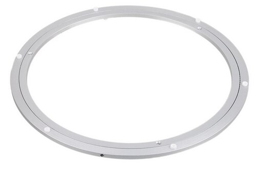

    Well, I received my 390mm dia lazy-susan a while back (image attached) but it'll sit in a corner some more yet.
    Reading lots that I hadn't been aware of e.g "inertia-matching" it seems direct-coupling of gearhead/stepper to the turntable may be preferable (neither had I been fully aware of the reduction in reflected load inertia by the square of the gearbox ratio).
    While a direct coupling scenario does work around some complexity (belt-drive redundancy / no requirement for circular ply) I can't say that the lazy-susan bearing is the most accurate "circle" i've ever come across (the bearing is a little sticky at a point to rotate by hand).
    Perhaps the accuracy that would be required via a direct coupling from the gearhead output to the underside of the plywood make this newly conceived contrivance impractical?
    If someone where to comment on this point it would be useful. However, if the idea where seen as potentially practical then any hint to the nature (by example) of a gearhead shaft to underside of plywood "coupler" would be appreciated as I have very little idea what that could be.
