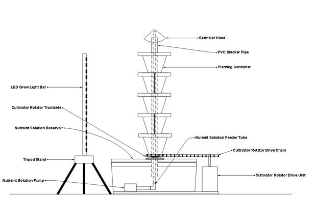

I'm not a mechanical engineer by any stretch on anyone's imagination. I have one mechanical design issue that I'm not sure how to approach. I kind of know the theory, but I have no idea how to approach it practically.
Here's the problem...
I have a load, my cultivator unit, that will be about 3' - 4' tall, maybe 12" to 18" in diameter and weigh between 20 and 40 lbs. The whole thing will be mounted on a lazy susan style turntable. The plan is to have a gear or pulley at the bottom that will be used with a hight torque stepper motor, and chain or belt, to rotate the cultivator. I'm using a stepper motor because they are pretty efficient and can be controlled very easily at very slow speeds. I want the rotation speed to be maybe 3 to 4 revolutions per day. A stepper would work well for this I think.
I have no idea how to properly size the motor. I see them speced at anywhere from 10s of oz-in to 1000s of oz-inches of torque. I get the concept of torque being rotational force. And that required torque has to do with acceleration time up to the desired RPM. But I have no idea how to relate this to my requirements.
I'm a 'puter software with some dangerous electronics knowledge guy! HELP!!! And feel free to tell me this just a stupid idea and I should be using a washing machine motor or something if that's the case.
For reference, here's a drawing of the rig. Note the drive at the bottom right. Please excuse the misspelled labeling. I haven't gotten around to correcting it yet. lol...

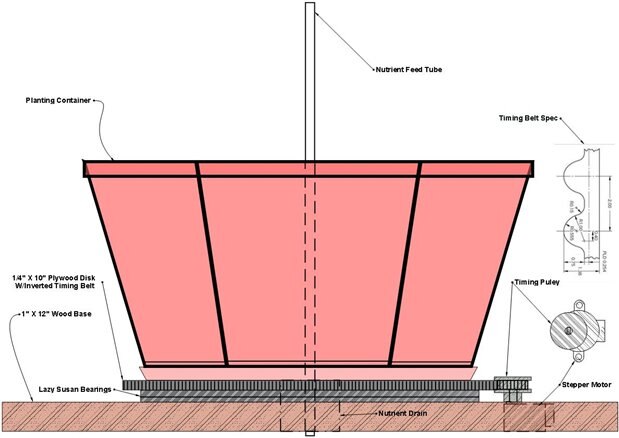

    Here's my design for the rotator. All this will be in the updated detailed design document on my next blog post.
    A little explanation... The 1/4" X 10" plywood disk will have standard GT2 6mm timing belt inverted and fastened to the outer edge. This will form a timing gear if you will. The timing pulley on the stepper will be pressed up against the "timing" disk. Who knows, maybe it'll work? I've calculated that around 40,000 pulses will rotate the turntable once. Honestly, I don't know what would be optimum but just for the sake of argument let's say 4 revulotuins per day. That's 160,000 pulses per day/86,400 sec = 1.9 pulses per sec.  I think the MCU will handle that, no matter how I may decide to split all that up. My main concerne is that the whole system is stable enough so that the gear and pulley remain in contact all the time. The Lazy Susan bearings are rated at 750lbs so it should be plenty stable. But getting the timing disk and Lazy Susan bearings centered to each other is super critical, so we'll see. If not then I have a backup plan to move the motor back and use an actual tensioned timing belt around the timing disk and pulley. I just want to see my wonky inverted timing disk work though.image

    Hi, I have played in different projects with timing belts in similar configuration and the mechanic scheme is correct. The only thing that may improve is an external tensing pulley that will be pressed on the belt when it is in position and locked with a screw on the axis. I have found this very useful for final regulation when setting all and helpful to keep in place

    The drawing in my post is based on a beltless design. The timing gear and pulley are actually in contact with each other. But I don't know if I can build the mechanism accurately enough to achieve that. So, there's a backup plan to slide the motor back a few inches and incorporate a belt. In that case, I will definitely take your advice. I have already located the parts for a small tensioning system. A single small timing pulley and a tensioner spring should do the trick.

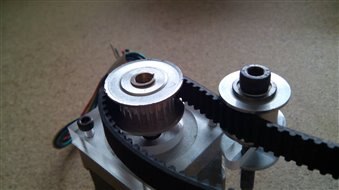

    thank you for the answer. The reason I will use in a case like this a timing belt is for the smooth moving respect the direct traction, always speaking of very slow moving. Anyway, if it is helpful for you I attach an image showing how I have applied the timing belt solution, in a very cheap way.
    Just another question: how is done the mechanics of the rotating base? To you use a central axis with a ball bearing or a recirculating ball bearing? I suppose that the rotating base should support a considerable weight.
    Cheers, Enrico.

    Hi Rick, I had to reread about the lazy Susan bearing. As a matter of fact I discovered that I have done the same for a camera rotation base. But I had not idea of what was the name image I attach here a picture just to explain what I mean. The principle is the same and testing it I saw that is very good for stability and weight support. In my case it was smaller and more precise but the principle it is almost the same.
    Instead the push pulley is not with tension. I have read - before buying - then directly tested that as a matter of fact the timing belts are almost like gears with very few flexibility and they didn't tend to loose their tension in time. So after placing the engine and the belt, the pulley is adjusted for the right pressure then the axis is locked with a self-locking nut.

    For the beltless design my only concern with the timing belt is this. I am going to be stretching the belt backwards around the diameter of the 10" disk. I know this will stretch the teeth of the belt apart by some degree. I hope that the 2mm pitch pulley still engages the belt teeth correctly. If not I may have to increase the pitch of the pulley.
    In the belted design I think that the timing belt will mesh correctly with the disk belt because it will be somewhat flexible.
    balearicdynamics over 11 years ago in reply to RWReynolds
    The belt is few flexible but not so much to create a serious difference between two teeth so I think it is almost meaningless for the movement. Obviously all depends on how much do you need to stretch the belt. But in theory your disk perimeter should be a multiple of the teeth spacing, +/- 1/10 teeth. In my opinion you should try and if it is the case you can lathe very few the disk circumference just to reduce the stretching. I have no idea of what kind of timing belt you are using and the teeth step (the distance between two teeth). Take in account that the shaft gear and the belt gear are not perfectly angular as the physics of the movements transforms a linear movement in rotational movement; to maintain a continuous contact between the two teeth series the gear is rounded, not perfectly angular.
    If you can give me some more information on the kind of belt maybe we can check but the most important parameter is the distance you should stretch the two belt ends.
