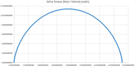

    "Most DC motors would have some form of curve (Torque v speed/rpm) and the shape of that curve would vary."
    For the record, here's the Torque/Speed profile for my 1 second move (Set1a) - the original model assumed zero friction (perhaps stiction in angular talk?) and a 14.5 gearhead reduction:

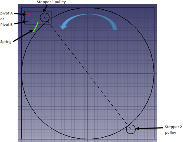

    In considering that in connection with multiple stepper motors:
    If in fact 4 steppers were used it seems Torque & power of each (approx 2.83Nm / 27 W) may be readily available.
    Is there any benefit between having the pivot at point "A" or point "B" on the plate?
    Is any particular placement of the spring preferable and how might it's "strength" be calculated/selected?
    Should I assume the plate itself should, at least, be Aluminium?
    Any comment (other than it will be expensive image) appreciated.
