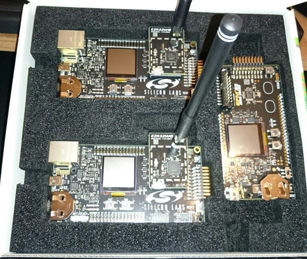

im having issues connecting the dev boards to my pc I have recently upgraded to windows 10 (not the best idea in the middle of a project) has anybody else encountered this issue or have any suggestions?

    no error messages windows makes sound to acknowledge usb item inserted then in simplicity I refresh detected hardware and says no hardware found not getting any errors just nothing when connected for any…

    yea i have the wireless kit aswell it came with the rest of the kit might have been as i had the 868mhz (800 and something) kit

    thanks everyone for the help problem was drivers needed to be reinstalled and then re install simplicity studio after installing the driver software now i can access all of the boards

    That would be great help I'm at that stage now also when u get your ezr32wg if you cut a small section out of the case you can fit the boards into the box with the wireless adapters attached aswell aswell as the other board thought this would be a safer option rater than keep removing them while I haven't attached them to the build yet
