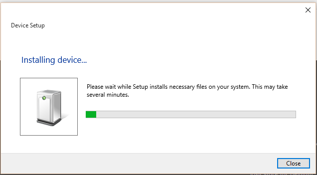

im having issues connecting the dev boards to my pc I have recently upgraded to windows 10 (not the best idea in the middle of a project) has anybody else encountered this issue or have any suggestions?

    Try installing the driver for Windows 8.1 - the 'updated' windows 10 driver that comes from M$ doesn't seem to be working
    https://www.silabs.com/products/interface/Pages/interface-software.aspx

    0 Jan Cumps over 11 years ago
    I'm going to test a Zero Gecko with my Windows 10, upgraded from Windows 8.1.
    Hang on...
    0 Jan Cumps over 11 years ago in reply to Jan Cumps
