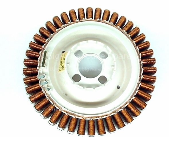

Hi
I am working on a project where I want to use a Smart Drive Motor (Found in Fisher and Paykel washing machines, and also in LG and Samsung machines) as a motor, and then as a generator.  The problem I am having is getting the motor to work.  It needs a motor controller, but I haven't found anything in a post or anywhere that provides a list of parts and schematic. I am hoping to have the capabiltiy within the system to switch between a motr and a generator.
Given my level of capability I would really like a start to end project description.
Does anyone know of such a description or is anyone able to help me out with building this project?

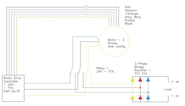

    Hi
    I have drawn up the schematic as I see it at this point.  Points to note are that the motor is in a 3-phase star configuration.  I have also drawn in a relay to allow to switch between the motor and generator wiring.  The hall sensors from the motor to the motor controller will also have a switch to disconnect them so that in generator mode the controller does not receive spurious signals.
    I have also attached a drawing of the wiring of the motor as it is configured at the moment in regard to the coils.
    I would like to know what controller I would need to be able to run this.  (And perhaps it is the one in the link above suggested by Don, but this does seem like it manages more power than I have), and any additional detail with how to install control the controller would also be appreciated.
    Look forward to your comments.
  • colecago
    0 colecago over 12 years ago in reply to e14 Contributor
    What is the motor rated at for current, power, voltage, etc?

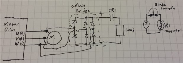

  • michaelkellett
    0 michaelkellett over 12 years ago in reply to e14 Contributor
    I haven't time to go into all the details of this motor but it is seriously weird - quite possible just perfect for a washing machine but absolutely NOT your standard BLDC. For a traction/regen application you need a motor intended for the purpose where all the phases are the same - otherwise you will need to design a controller completely on your own ( there isn't a lot of stuff on the web to help you.).  Get  a normal BLDC motor and then you can use all the kits and design stuff (loads of it) on the web.
    I'm also worried by your earlier post where you refer to the wind turbine - are you hoping to keep the vehicle moving by extracting energy from it's passage through the air ?

    How many power wires are thre coming from the coils of the motor.
    MK

    0 e14 Contributor over 12 years ago in reply to michaelkellett
    Hi Michael
    There are three wires into/out of the motor for power and 5 for the hall sensors.  Here is a pic of it without the hall sensors.
