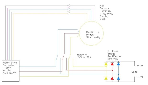

Hi
I am working on a project where I want to use a Smart Drive Motor (Found in Fisher and Paykel washing machines, and also in LG and Samsung machines) as a motor, and then as a generator.  The problem I am having is getting the motor to work.  It needs a motor controller, but I haven't found anything in a post or anywhere that provides a list of parts and schematic. I am hoping to have the capabiltiy within the system to switch between a motr and a generator.
Given my level of capability I would really like a start to end project description.
Does anyone know of such a description or is anyone able to help me out with building this project?
Thanks
Simon
    e14 Contributor over 12 years ago in reply to colecago +1
    Hi I have drawn up the schematic as I see it at this point. Points to note are that the motor is in a 3-phase star configuration. I have also drawn in a relay to allow to switch between the motor and generator…
    e14 Contributor over 12 years ago in reply to michaelkellett +1
    Hi Michael, Due to me still being a newbie in this area, I can only offer up the info I have gleaned from the internet. I think the reason this is not a simple stepper is because of the arrangement of…
    e14 Contributor over 12 years ago in reply to e14 Contributor +1
    0 e14 Contributor over 12 years ago in reply to colecago
    Hi
    I have drawn up the schematic as I see it at this point.  Points to note are that the motor is in a 3-phase star configuration.  I have also drawn in a relay to allow to switch between the motor and generator wiring.  The hall sensors from the motor to the motor controller will also have a switch to disconnect them so that in generator mode the controller does not receive spurious signals.
    I have also attached a drawing of the wiring of the motor as it is configured at the moment in regard to the coils.
    I would like to know what controller I would need to be able to run this.  (And perhaps it is the one in the link above suggested by Don, but this does seem like it manages more power than I have), and any additional detail with how to install control the controller would also be appreciated.

    0 colecago over 12 years ago in reply to e14 Contributor
    What is the motor rated at for current, power, voltage, etc?
    Hi
    The info I have on the motor is as follows.
    Electric Supply
    Operating Voltage 220/240 V AC 50Hz
    Maximum Current 2.8 amps
    Motor
    Electronically commutated direct drive 3 Phase brushless DC Motor.
    Motor resistance
                                  Per Winding                    Phase to Phase
    Phase 1                    1.3 ohms @ 20degC          2.6 ohms @ 20 degC
    Phases 2 to 4            6.1 ohms @ 20 degC         12.2 ohms @ 20 degC
    Phases 5 and 6          16 ohms @ 20 degC          32 ohms @ 20 degC
    Below is a link that has the info on the motor.  It is the manual for the washing machine it comes from.  I also have a pdf that describes the same motor in relation to its use as a generator.  It doesn't seem to be available online anymore and I can't see where I attach files within the post, only images and links.  I can email it if it would help.
    Anyway, I hope the link to the motor manual helps.
    http://www.eserviceinfo.com/downloadsm/60779/Fisher%20&%20Paykel_Several%20-%20MW%20GW%20etc.html
    I appreciate the help.

    0 michaelkellett over 12 years ago in reply to e14 Contributor
    I haven't time to go into all the details of this motor but it is seriously weird - quite possible just perfect for a washing machine but absolutely NOT your standard BLDC. For a traction/regen application you need a motor intended for the purpose where all the phases are the same - otherwise you will need to design a controller completely on your own ( there isn't a lot of stuff on the web to help you.).  Get  a normal BLDC motor and then you can use all the kits and design stuff (loads of it) on the web.
    I'm also worried by your earlier post where you refer to the wind turbine - are you hoping to keep the vehicle moving by extracting energy from it's passage through the air ?
    MK

    0 e14 Contributor over 12 years ago in reply to michaelkellett
    Hi Michael
    Thanks for your comments.  I am discovering that this is not an easy motor to run as a motor.  Fairly easy to run as a generator though.
    Perhaps if I explain my scenario some more you will see why I want to stick with it.
    I am using this generator because of its shape and size.  I am building a demonstration model of a new transmission system that I have invented.  I want to be able to prove the invention works so I can move forward in seeking investors and going towards commercialisation.  I have already built the transmission system to fit this generator, and as I have tolerances of 3 mm in some places, I am sure you can appreciate that swapping the motor/generator at this stage is not an option I wish to consider.  At the time I chose the generator, I had not anticipated the difficulty involved in running it as a motor.
    You needn't worry about me wanting to put a wind turbine on a car to power it. 'I ain't that daft'.  :-)
    The turbine reference is because that is what the transmission system is likely to be suited to.  The car comment was in relation to another comment about the motor swapping between motor and generator, as in a hybrid car.  But this is not going on a car.
    I do have an article that outlines much of what is needed, but they do not stipulate the motor controller needed, just an indication of the sort of controller I should use.  As mentioned before, this is not an area of technology I am very familiar with so I do not want to buy the wrong equipment and either find it is unsuitable, or underrated.
    I look forward to any other info you can add to the discussion..

    How many power wires are thre coming from the coils of the motor.
    MK
