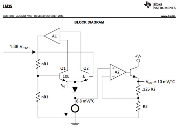

I was experimenting with the lm35 dz temperature sensor to see if it would work like a transistor. Amazingly, it acted the same as a PNP transistor. Can someone tell me why this is?

    Well, it is a diode temperature sensor, and the adj terminal does modulate the output.

    If you look at the block diagram of the datasheet, you will see that the output of the sensor is a PNP transistor, where the colector is tied to VCC, and emitter tied to the output, so you can see the PNP transistor behavior when acting on the GND pin as it was the base pin of the transistor.image
    But for such a purpose better use PNP transistors... image

    That is right Don, just in the end the transistor is NPNimage, point adj terminal..., I am joking image, dislike figthing. It is the combination with the opamp, where the internal diode of the base-emitter in the loop of the op amp, what makes the 'PNP behave'.

    Obviosly, it can not act as a PNP, for example if you polarize it as a PNP working at saturation point, to voltage on the output will depend on the resistor un the base, the current that LM35 draws from VCC to its GND...etc
