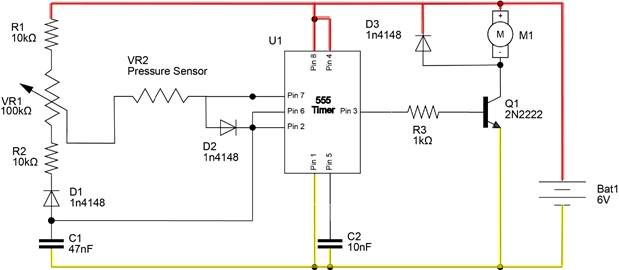

    Not sure if this will help. This is the circuit diagram from the TLC episode that just came out where I made a mask with a spinning pinwheel on it. It's a small motor controller that uses a pressure sensitive…

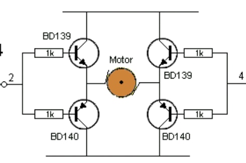

    At a glance, it is possible to tell this is a 'H-bridge' circuit, due to the shape looking like a H. It is used to switch power in either direction. It could have been drawn totally different, but people don't do that - they try to draw it in this style. It becomes an easy pattern to recognise in a larger circuit. Also without any labels, by convention it is possible to guess that the top line is a positive supply rail, and the lower is 0V. This convention wouldn't be assumed when constructing the circuit (since then precision about it is required), but it can be initially assumed when trying to guess what a schematic does.

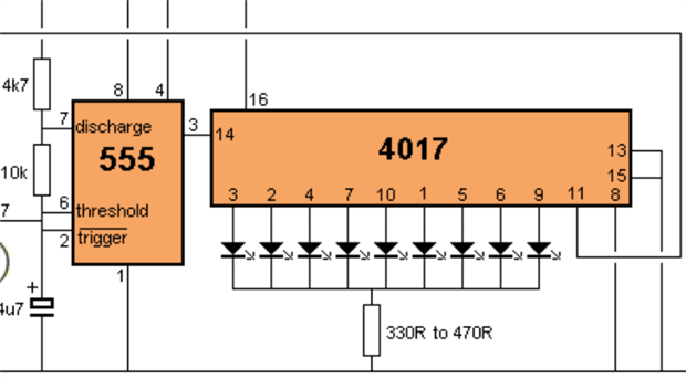

    Even though this is just part of a circuit, it is instantly recognizable as something that will pulse and flash LEDs in a sequence. This is because the 555 is a well-known chip for generating a single or stream of pulses, and the 4017 is well-known to convert an input pulse stream into ten outputs in sequence.

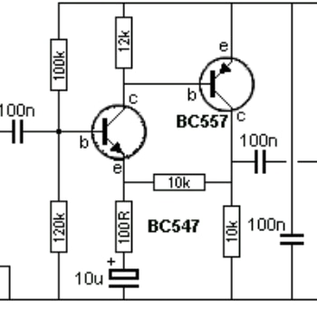

    The circuit above can be assumed to be some sort of amplifier, with two stages, since that's a normal use of a transistor. It look designed for amplifying AC signals, since there are capacitors on the input and output that would block DC.

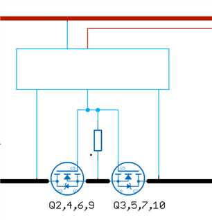

    I've tried in the past to color-code some wires, but I've only found it usable for very small circuits, such as this one:
    It can sometimes look fine, but although there are three black lines at the bottom, they are actually separate wires that are not electrically connected, they are connected to MOSFETs. So the color code can get confusing too if done in this way (and there are not enough easy-to-identify shades for most circuits, to have one shade per net).
    This circuit uses red to indicate positive, and the three black lines are 'kind of' negative, but they are all different negatives. The left black line is a permanent negative, and the other two are switched negatives. It would be hard to convey this meaning with separate colors, but can be explained in a text explanation of the circuit, or perhaps by recognizing the pattern of two MOSFETs and resistor as shown.

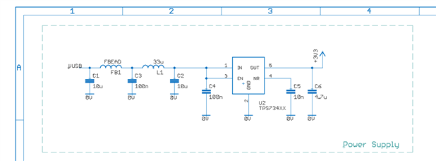

    I prefer when circuit diagrams look like this; here the section is identified, it is clear that it is the power supply sub-circuit that is part of a larger circuit, because it has its own box and title, within a larger schematic sheet. Do you mean this dashed box ought to be shaded in a single color, so that the sub-circuit is identified by color?
