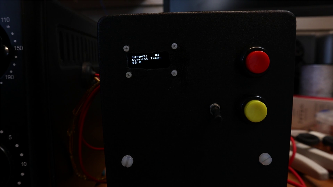

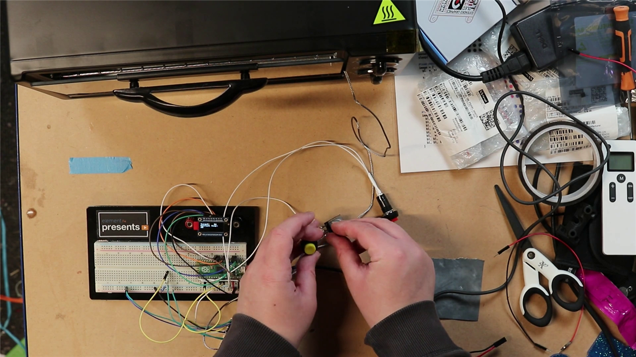

Katie's attention shifts to the toaster oven's temperature control mechanism, which she suspects might not accurately reflect the actual temperature output. The oven's operation involves adjusting the desired temperature and time, but Katie aims for more accuracy. To address this, she opts for a Raspberry Pi Pico and a spare thermistor. However, the thermistor's leads fall short of reaching outside the oven, necessitating soldering. Since the solder's melting point is near the curing temperature, Katie anticipates potential connection challenges.
The project's crucial stages encompass adapting a kitchen thermometer probe for precise temperature measurement and managing the oven's heating elements. Katie delves into the inner workings of the toaster oven, discovering the series connection between the timer and temperature control. She plans to replace the original control system with her design, integrating an Omron power relay to handle mains voltage switching. She acknowledges the requirement for a separate 24V power supply for the relay coil.

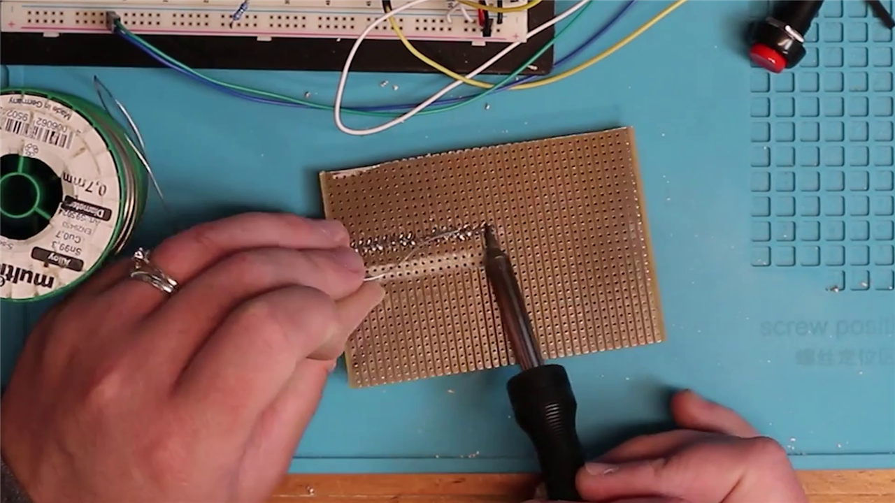

Constructing a detailed circuit and programming the Raspberry Pi Pico are fundamental steps in Katie's project. She successfully incorporates temperature readouts, buttons for setting and initiating oven functions, and a relay for heating element control. During testing, Katie observes that the temperature remains within a 10-degree range of the set value, marking a significant improvement over the original controller. Impressed with the results, she highlights the potential for wider applications beyond resin curing.
Subsequently, Katie addresses practical issues, such as preventing the K-Type thermocouple from coming into contact with grounded metal, which could disrupt temperature readings. She develops a protective insulation approach and further optimizes her control setup. Replacing loose connections with Wago block connectors enhances reliability and safety, mitigating grounding concerns. Throughout her journey, Katie demonstrates resourcefulness in troubleshooting and determination to create a refined and user-friendly DIY solution.
Ultimately, Katie successfully crafts a compact and functional control box for her toaster oven project. While acknowledging potential aesthetic improvements, she celebrates her accomplishment in developing a cost-effective and dependable tool for resin curing. She encourages fellow makers to explore this versatile modification, adaptable to various oven systems. Katie's experience showcases the potential of elevating everyday appliances with technical skills, while also addressing the challenges she overcame in achieving her goal.

    Yeah, as you dial in more accuracy by modeling the characteristics of the oven and element you'll want to use something like PID, since the relay will end up clicking on and off more and more frequently as you get close to the set temperature.
    The other thing, that dougw hinted at below, is with the small thermocouple you'll want to make sure the temperature it measures is more representative of the whole oven's temp - optimally a convection fan, but I suspect that would push the easy-hard meter much further right.
    Finally, you might be able to avoid earthing the thermocouple with a pair of silicone washers. I think the max temp would be ~200ºC in that case tho
