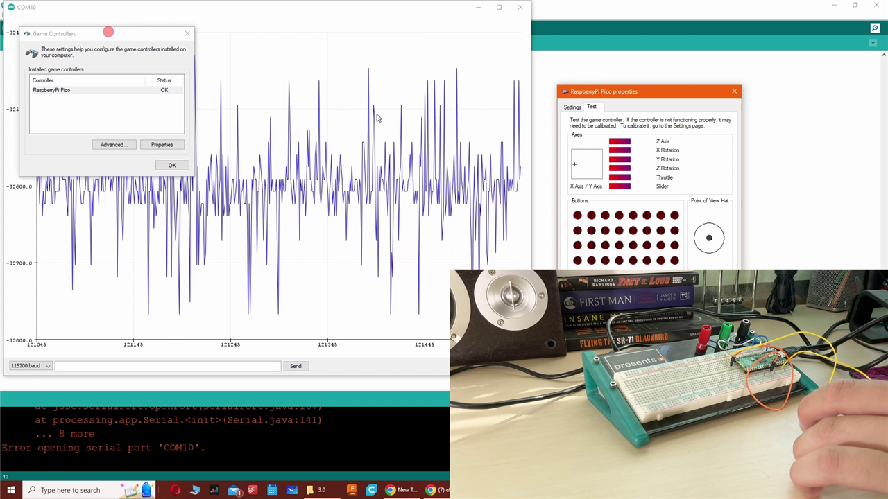

The heart of Milos' project lies in his quest to measure the force behind every key press on the keyboard. He delves into various methods to achieve this goal, including using commercial switches and load cells. Ultimately, he settles on using Force-Sensitive Resistors (FSRs), due to their simplicity and effectiveness. Milos explains that FSRs change resistance as pressure is applied, enabling precise force measurement. He takes us through the layers of an FSR, illustrating how the resistance changes as the carbon layer gets compressed under pressure.
The construction process comes next. Milos guides us through the assembly of his custom analog switch,  combining components like the keycap, key switch, FSR, and silicon foot, He demonstrates the process with great attention to detail, providing tips on how to secure components effectively. He also elaborates on how he connected multiple FSRs to a Raspberry Pi Pico using an analog multiplexer to manage the input effectively.
As we delve into the software aspect of the project, Milos walks us through the code that enables the analog keyboard's proportional control. He emphasizes the use of the Pico Gamepad and Fast LED libraries for managing the addressable RGB LEDs, a staple of gaming equipment. His code snippet showcases how he mapped the analog input to joystick movements, granting the player smooth and intuitive control.
Milos concludes by sharing his hands-on experience with the custom analog keyboard in a Sim racing environment. Through his testing, he demonstrates the advantages of proportional control over binary control, showcasing a smoother driving experience. He acknowledges the challenges he faced and the physical toll that extended gaming sessions can have on his fingers. Nevertheless, he proudly presents his finished custom analog keyboard as a successful project that enhances the gaming experience.

    I did a project on linearizing FSRs. It may not be best for your application, but it might mean you don't have to press extra hard to get full scale output.

    Thanks! In my previous experience with FSRs, they are really touchy when it comes to how the pressure is spread across, so this was my idea for a repeatable setup. That's a great idea for linearizing the FSR output, another thing to maybe try is instead of linearizing it,  making it into a log function since most of our senses tend to be logarithmic. That would be a fun experiment trying to characterize the FSR in this assembly, I'm just afraid of how badly the nonlinearity would affect everything. I've previously only used no-name brand FSRs and they didn't perform the best, these worked pretty well for me, but I'll take a look at the Tekscan ones, thanks for the tip!
