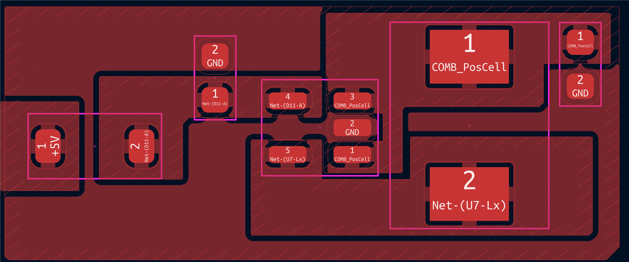

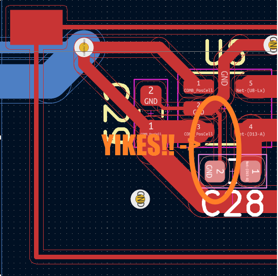

    However. Regarding your power supply, I took a peek at your KiCad files—just a few critical issues I see right away.
    I am using this converter for an example (so I can use designators.)
    1. For the ceramic output capacitor (C28), you should have a relatively large CV 0805 (imperial) MLCC. A large CV means the highest rated voltage at whatever capacitance you picked. An 0805 has much less DC-Bias effect than a 0603 and is available with higher rated voltages. Since you have the space, I would also use a 0805 on the input (C29) as well.
    2. That tiny ground trace on the capacitor is KILLING the supply. Everything should have a FAT connection to ground. The kind of connection that is tough to solder!

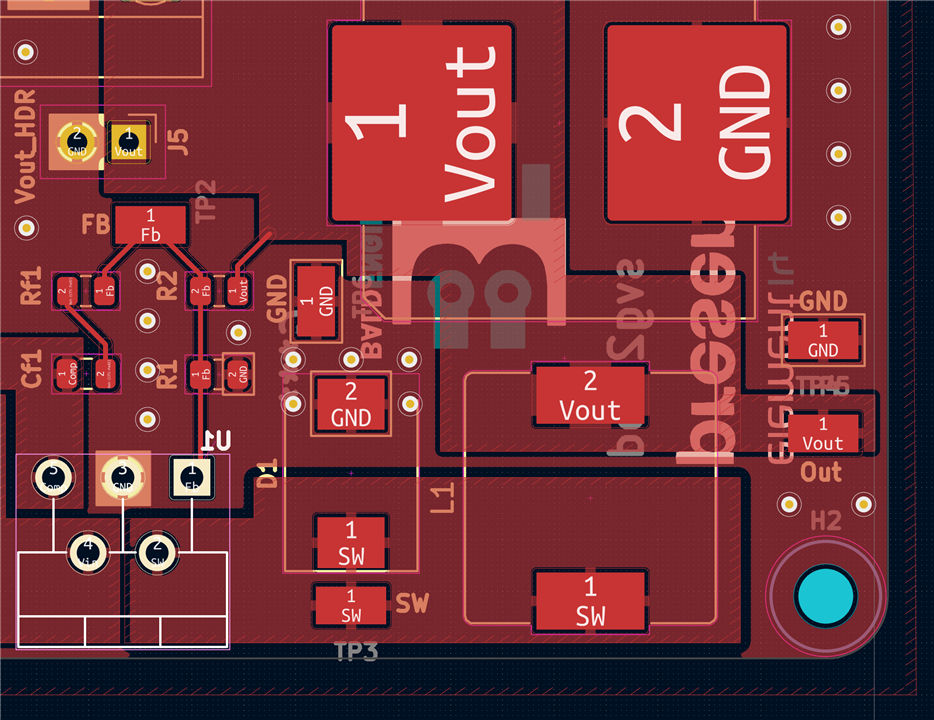

    3. You should not use traces for any of the switching signals! Everything should be a large copper pour. Even though you used larger traces, their inductance is a significant issue. For comparison, here is a partial shot of the board I made for the "How to make a noise-free SMPS" video:
    In this case, I used a through-hole switcher IC (and this is a buck, not a boost--but the principles are the same.) Notice how the ONLY trace I used is for the feedback signal (which I don't think your fixed switchers have.)
    The massive Vout and GND pads at the top are the output filter capacitor. The Vout and SW at the bottom is the inductor. See how I drew massive copper pours for them?
    I would also encourage you to use large pours, NOT TRACES, throughout the distribution of your 5-volt rail.
    For example, here are the 3v3 and 5v rails in the Mega IIe's design:
    (The empty space is GND, which I deleted for this picture.) Only in a few cases did I draw a trace from my fat pours to a chip.
    As a suggestion, I would have laid out the supplies something like this. (Don't copy this exactly. I just did it real quick.)
    Since you have enough room, I would also suggest adding an extra capacitor footprint so you can add a second value.
