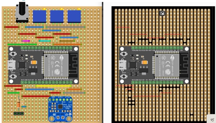

    Excellent project. Finally got all my parts in and routed out the copper. Wanted to confirm the top/bottom and left/right. At 4:23 you shows the copper routed out. Using the single notch at the bottom right, if I flip it over horizontally, that notch will be on the bottom left. Correct? Which way with the connector be on the ESP-32 be facing? Sorry for the questions. I am better at soldering the un-soldering.

    You are seeing an X-Ray view of the copper tracks.

  • beacon_dave
    beacon_dave 9 months ago in reply to AlaskaNick
    Your stripboard is the mirror image of what Mark's board above is. imageimage
    You'll either need to:
    1. solder the ESP32 onto the 'wrong side' of the board
      (space the header socket off the board enough to get your soldering iron tip under the black plastic.)
    2. spin the board around 180 and reuse the uncut tracks and bridge any cut ones that need bridging
    3. start over with a new board
  • beacon_dave
    If you look closely at Mark's component layout diagram, you can see where he made the cuts to the tracks on the copper side.

    I will just get a couple more boards,  So if I route out the copper, as in in my picture, it should be good to go?image

    I got the new boards in and made the appropriate slots.  Soldered everything in and tested it out.  The LEDs are working.  Made adjustments and that is working.  I just don't have any sound.  Tried 2 different speakers and no sound.  I am not using the PUI audio speakers but have 2 small speakers from I pulled out of some computers.  Not sure the watts on them. Do you think that could be the problem?  I did put a volt meter on it and plugged it on.  i couldn't find any connections that showed a volt running through them.  Would you give me a couple of connections to see if my solder joints are bad
    .image
  • beacon_dave
    beacon_dave 8 months ago in reply to AlaskaNick
    On the amplifier module you should be seeing 3V3 on both the Vin pin and the GAIN pin (via the two red wires).
    GND should be connected to the ESP32 GND (via the blue wire).
    DIN should be connected to the ESP32 pin D25 (via the two grey wires).
    BCLK should be connected to ESP32 pin D32 (via the two orange wires).
    LRC should be connected to D4 (via the yellow wire)
    Check that the copper tracks are cut between the sound module and the ESP module.
    Check ESP32 D32 has been cut between the ESP32 and the 5V supplying the middle pot.
    Check ESP32 D23 has been cut between the yellow wire and LRC (easy to miss that one)
    Looks like you can get more gain by adjusting the GAIN pin connection if needed:
