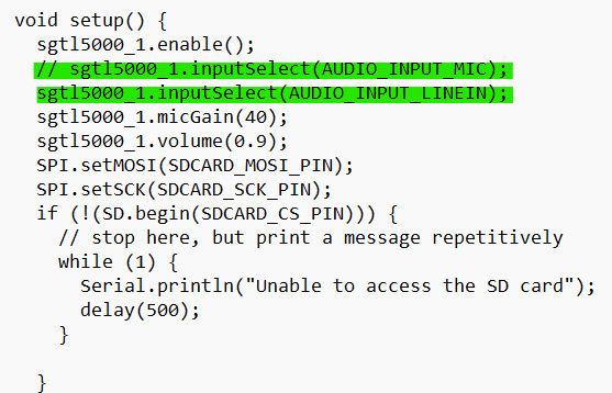

    jvdberg 11 months ago in reply to beacon_dave
    Thank you very much, that did the trick. Unmarked the mic line and marked the line-in. Also adjusted the micGain.
  • beacon_dave
    beacon_dave 11 months ago in reply to jvdberg
    "...I tried several microphones on mic-in input but that didn't produce any sound. I tried the Line-in that did produce some mic-sounds,..."
    Looks like you need to select the mic input in the code setup.
    "...My assumption was to use mic-in? Is there a difference in these inputs?..."
    Mic in will expect a mic level signal where as Line In will expect a line level signal.
    However it looks like you will need to select which input you want to use.
  • jvdberg
    Thank you, for the suggestions. I got the Larson eye and sound working. It looks and sounds awesome!
    I tried several microphones on mic-in input but that didn't produce any sound. I tried the Line-in that did produce some mic-sounds, still tinkering with it to get a Centerion-ish voice. My assumption was to use mic-in? Is there a difference in these inputs?
    I noticed the software freezes a few seconds after boot-up (it's also does in the Youtube video on this page at 14:20) after this it runs a while +/- 7 minutes and freezes (sound and light) again and continues. Is this software related? I got the software from https://github.com/donnersm/CylonVocoder is this the right/latest version?

  • beacon_dave
    "I have a MAX98357 also used in episode 670 but that doesnt have a line in. What mic does this need? I have a mic but it doesnt seem to work."
    The MAX98357 used in episode 670 requires an I2S digital audio signal.
  • jvdberg
    Ok, starting to get it to work, i used the firmware mentioned in the supported files and link that didnt work, searched a bit. There's another on github. Also the instructions on instructables were very helpfull. Question, this board is using a line-out so no direct speakers. I'll need a small amp, speaker and battery solution to keep it portable. Any suggestions? I have a MAX98357 also used in episode 670 but that doesnt have a line in. What mic does this need? I have a mic but it doesnt seem to work.
