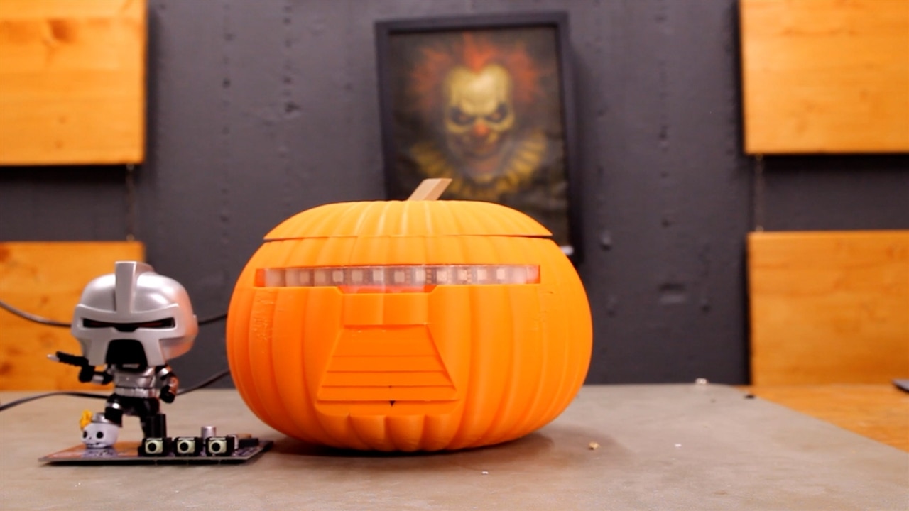

For Halloween 2025, Mark decided to skip the traditional carved pumpkin. Instead, he 3D printed one, a durable, reusable pumpkin shell that can be brought back every year.
As he explained in his video, “Instead of hollowing out a pumpkin, I did something special, I 3D printed it so I can use it over and over again every year.”
The project combines two of his previous builds: the Larson Scanner and the Vocoder, merging them into a single device that not only lights up like a Cylon’s eye but also modulates speech, a fun addition to any Halloween setup or cosplay.

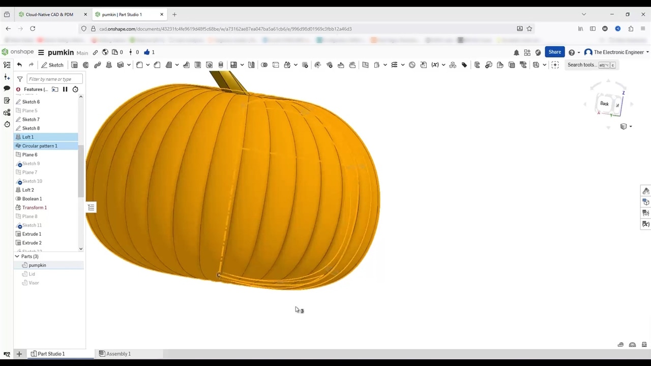

Designing the 3D Pumpkin
Mark designed the pumpkin using Onshape, a free, browser-based CAD tool suitable for hobbyist use. The model began as a series of arcs and ellipses, which he connected using Onshape’s loft and revolve features to form the pumpkin’s rounded body.
Once complete, he created the facial cutouts and added a “visor” opening, the slit through which the LED strip shines.

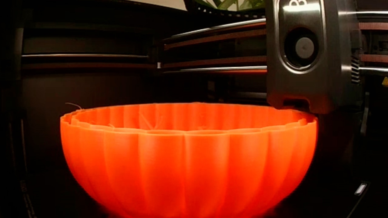

“When I imported it into my slicer, I scaled it down to 50% so it would fit my printer,” Mark explained. “Then I cut off the top and printed it in two pieces.”
He printed the pumpkin body and visor separately. The visor, designed to diffuse light from the LED strip, was printed in a transparent filament. The complete pumpkin can be fitted with internal lighting or even a small flashlight to enhance the glow effect.

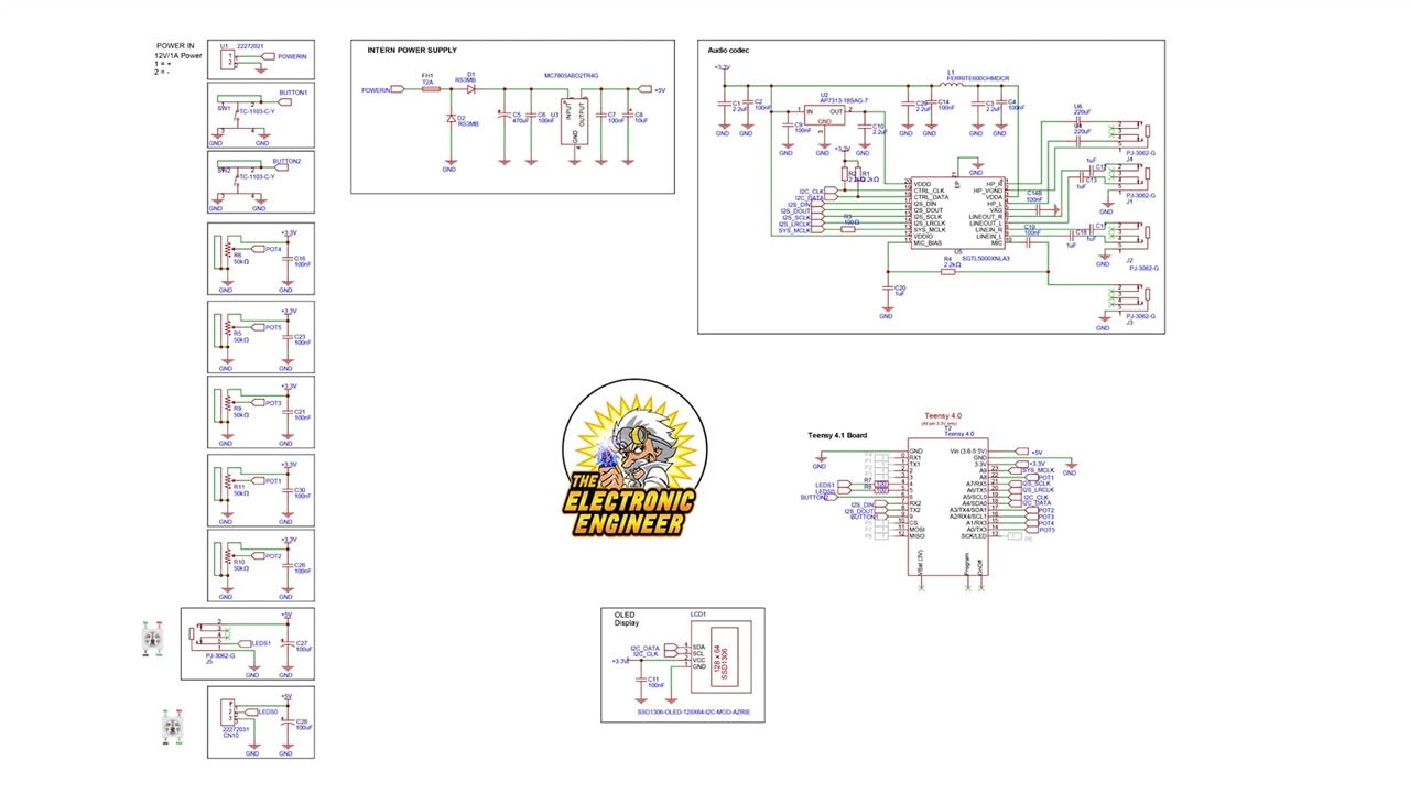

The heart of this project is a redesigned Cylon Vocoder PCB, which integrates the Teensy Audio Board circuitry directly onto the board. According to Mark, this reduces cost and simplifies assembly:
“The schematic looks complicated, but it’s basically the same electronics I used in my previous vocoder. The difference is that I designed a PCB and implemented the audio board on it.”
From the Bill of Materials, the main components include:

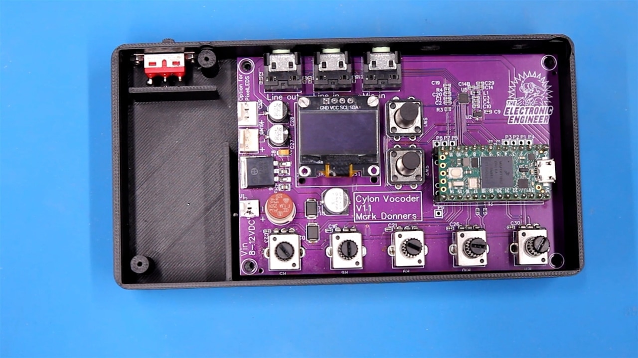

Mark highlighted a few design choices worth noting:
  • Socket mounting for the Teensy and display: “Because the Teensy is quite expensive, I wanted to be able to remove it if needed.”
  • Simple reverse-polarity protection: “If you plug it in backwards, the diode conducts and blows the fuse, a quick and dirty solution that works every time.”
These details make the board practical for repeated use, ideal for costume integration or standalone decoration.
Assembly and Design
Once the PCB was assembled, with headers, potentiometers, Molex connectors, and display soldered in, the next step was mounting it in the custom 3D printed enclosure. The case includes space for the 9V battery, switch, and wiring to the LED strip.
Mark demonstrated the layout:
“The PCB fits right in here. I already mounted a sliding switch for the power, and this has room for a 9V battery, it goes right there.”

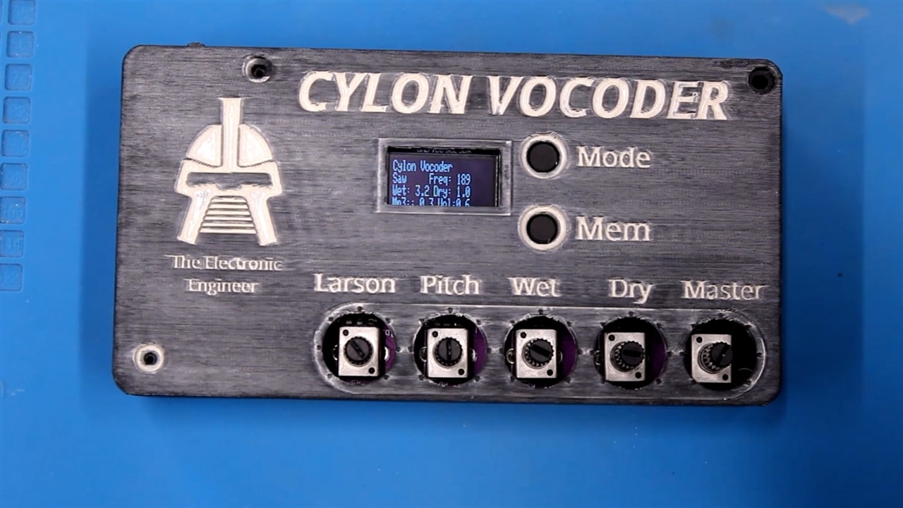

When powered, the Teensy runs firmware based on Mark’s earlier vocoder project, updated slightly to control both the audio and the LED Larson scanner animation.
The display interface provides feedback as users turn the potentiometers, showing real-time values for signal parameters such as pitch, wet/dry mix, and master level. One button changes the waveform used by the internal function generator, cycling through square, sine, saw, and pulse waveforms.

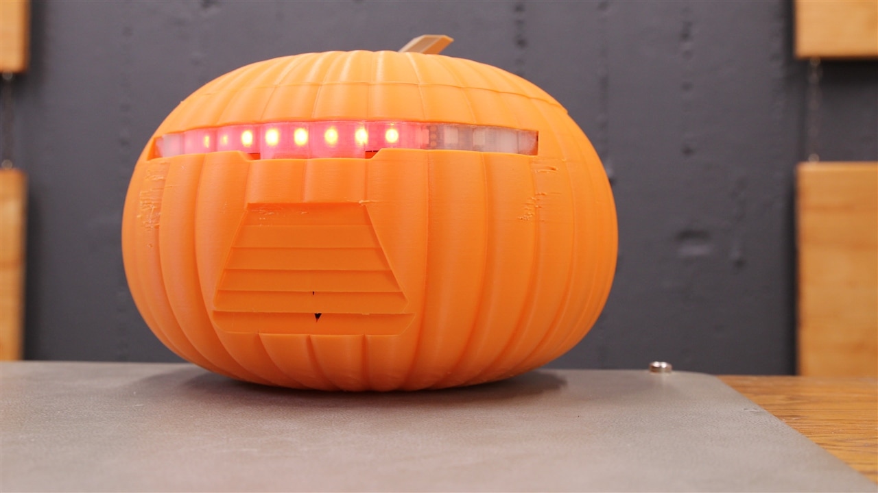

Integrating the Larson Scanner
Inside the pumpkin’s visor sits a NeoPixel LED strip, controlled by the Teensy through a dedicated output. The LED animation mimics the iconic sweeping red light from the Battlestar Galactica Cylon, a visual effect Mark first explored in his Larson Scanner project.
The LED strip was left intentionally long:
“I didn’t even bother cutting it to size,” he admitted. “It’s the original strip I used for the Larson Scanner, and I just left it in there because I don’t mind, I like the decoration.”
When activated, the strip moves rhythmically back and forth behind the pumpkin’s visor, giving it a menacing yet entertaining look.
