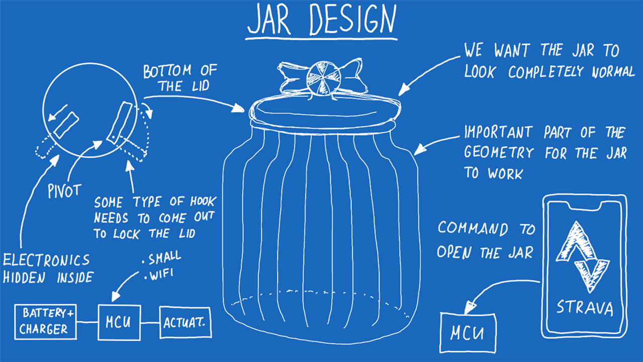

What's the Idea
Milos first built this project more than six years ago, back before he owned a 3D printer. He’s rebuilt it now to make it smaller and more refined, taking advantage of 3D printing and modern microcontrollers.
The original mechanism was hand-cut from 4 mm plywood; the small push rods used sheet metal salvaged from a gutter, there was plenty of room for improvement.
This time he decided to use an established fitness app (Strava) to get activity data instead of a crude step counter app. The design brief was simple: the jar must look like an ordinary jar from the outside, no obvious electronics, just a jar full of candy.
Enacting the Mechanism
Milos began with the mechanism because it is the most critical part of the system. Instead of linear pistons in the original, the new lid uses small gears with swinging arms that extend to lock the lid in place. The whole mechanism is designed to be 3D printed and to use a very small servo (the common SG90).
The mechanism is compact and straightforward to assemble. All electronics are contained inside the lid: an ESP32-S3 microcontroller (for Wi-Fi), a battery, and a battery charger module. Optionally, you can add a power switch.
A quote from the video where Milos describes the mechanism:
“In the centre we have the servo horn… and around that we have the three pistons that move linearly. So they’re connected together using this small pushrod… For the new version, I want to go with gears.”
MR20 - Cookie Jar V2 - Video V1
The new lid packs everything tightly; from the outside (when unlocked) there’s no visual clue that anything special is inside — just candy.

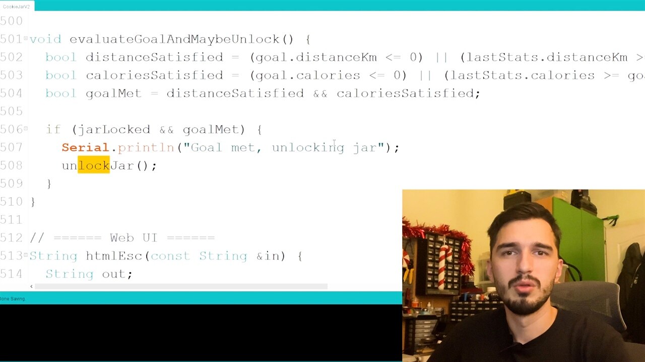

The sketch includes a regular poll loop:
const unsigned long STRAVA_POLL_INTERVAL_MS = 5UL * 60UL * 1000UL; // 5 minutes
// inside loop():
unsigned long now = millis();
if (now - lastPollMs >= STRAVA_POLL_INTERVAL_MS || now < lastPollMs) {
  lastPollMs = now;
  ActivityStats stats;
  if (fetchStravaToday(stats)) {
    lastStats = stats;
  } else if (fetchStravaLatestActivity()) {
    lastStats.distanceKm = lastActivity.distanceKm;
    lastStats.calories = lastActivity.calories;
    lastStats.fresh = true;
  evaluateGoalAndMaybeUnlock();
evaluateGoalAndMaybeUnlock() is the function that takes the gathered activity stats and decides whether to call moveServoTo(SERVO_UNLOCK_ANGLE) (unlock) or moveServoTo(SERVO_LOCK_ANGLE) (lock).

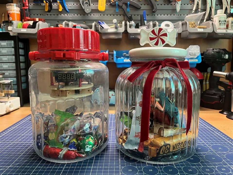

Final assembly and test
Once assembled and flashed:
  • Lock the jar, set your target distance via the device web UI, go for your run, and wait for the device to poll Strava and evaluate your activity.
  • The sketch will automatically refresh tokens if required and will periodically check for new activities.
Milos demonstrates this flow in the video and finishes by going for a run to show the jar unlocking when the goal is met. He notes that the jar, when seen from the outside, looks like an ordinary jar of candy — the mechanism is hidden inside the lid.
“If you look at it from outside, it just looks like a jar full of candy bars… you won’t even know that there are some electronics inside.”
