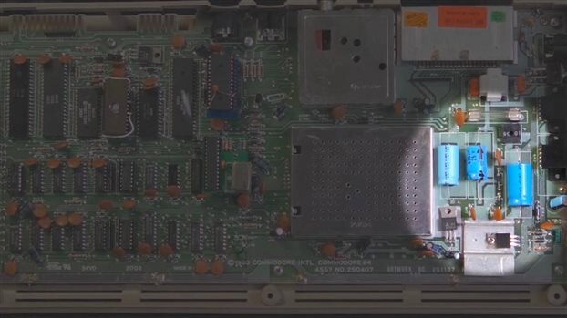

In WorkBench Wednesdays , one of my mini-projects was to replace the capacitors in a Commodore 64. In the video, I only had time to replace about half of the decoupling capacitors. Later I'll go back and finish the rest. This post discusses why I picked the capacitors used in that project.
For organization, I'll break up the PCB into a couple of parts. Keep in mind there are many revisions of both the board's schematic and the board's layout. That is how Commodore operated back in the day. While component numbers generally match up between revisions of a particular assembly number, it isn't always the case. The schematics available on the web do not cover every change of the PCB assembly either.  These facts mean you'll need to do a little bit of detective work when working on your C64.
This information is based on boards with ASSY Number 254407. This information is not a comphrensive look at the C64 nor every single capacitor on the board. As I finalize the replacements on my boards, I'll update this post with additional information.

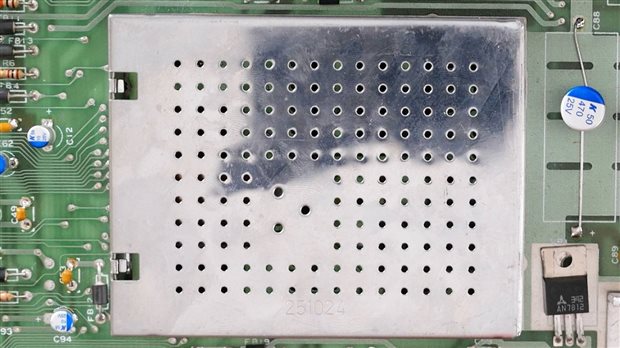

The VIC-II is in an RF cage, where the lid acts as a crude heat sink for the video chip. Most of the capacitors in this section are just the 100 nF and 10 µF decoupling capacitors used elsewhere. On the VIC-II's oscillator, there is a 16 pF ceramic capacitor. I haven't picked a replacement for that one. But if I did, I would get a 50 V C0G as its replacement. C0G is ultra stable with voltage, temperature, and time. (And in fact, likely does not need to be changed.)
You might notice the original electrolytics in this section are slightly smaller than the others. These were a "low profile" option, at least at the time. Smaller capacitors like these would have cost more than the generic decoupling caps used elsewhere on the board. I find it humorous that the A758BG106M1EAAE070 I picked for the digital section is just as small as these "specialty" caps.
RF Modulator
Initially, I planned to replace only the electrolytics in the RF modulator section. Ultimately, I am going to remove the modulators from my C64s, as soon as I figure out which traces carry the luminance signals to the A/V port. However, here are the two I identified and their suggested replacements if you wish to keep yours.

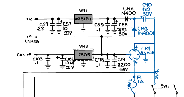

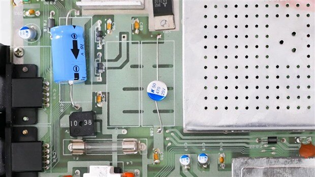

Without question, the big electrolytics get everyone's attention: C88, C90, and C19. The three most massive capacitors are filter capacitors for the 2 voltage rails: +5 V (VIC Can) and +12 V. C88 and C19 are on the input of the voltage regulators. You'll notice in this schematic that C88 and C90 are rated for 50 V, while C19's rating is 16 V. I have noticed some guides on the internet suggest you can use 16 V for all 3 of these capacitors. Please note, YOU CANNOT USE 16 VOLT FOR ALL THREE OF THESE CAPACITORS.
C19 sees a relatively low voltage and so a 16 V rated capacitor is just fine for it. My suggested polymer replacement is RNL1C222MDS1.
C88 and C90 Need More
With a glance at the schematic, you might be inclined to think that the input side of the 12 volt regulator is going to be slightly above 12 volts. It isn't. C90 is part of a voltage doubler circuit which turns the 9 Vac coming in from the power brick into about 18 Vac. Which means you need to use at least a 25 V rated capacitor in this section. For both of these capacitors, I selected the A750MS477M1EAAE015. I did notice on some boards that C88 is 1000 µF instead of 470 µF. I guess that the value isn't that critical (and probably why they cut it in half in later revisions.)
For more information about C90, check out this blog post I did to explain why (and how) an electrolytic can have AC applied to it.

As I pointed out in the video, there are no Axial polymers available on the market. So I ended up using Radials and just cheating a bit with their leads. For improved performance, I should look to see where I can shorten the ground loops, but that'll come at a later time.

    Question from Kevin on Twitter:
    Did you use radial caps for C19, C88, & C90 on your Commodore 64? I wasn't sure if axial caps can always be used in place of radial as long as the capacitance and voltage matches
    In this case, I wanted to use Polymer Aluminum capacitors. As I pointed out in the video, there are no axial polymers available on the market. So I ended up using radials and just cheating a bit with their leads. For improved performance, I should look to see where I can shorten the ground loops, but that'll come at a later time. (and does not matter as much in a linear regulator circuit.) Additionally not shown in the original video, I hot glued the leads to the PCB. Since there is no out-gassing from polymers, there is less concern about "potting" them.
    For more information on Polymers check out The Learning Circuit 40: Learning About Polymer Capacitors video. If you'd like to see some measurements I made before and after using polymers, then watch The Learning Circuit 42: Replacing MLCCs with Polymer Capacitors video.
    For THIS circuit, the most critical parameters are the voltage and capacitance. The ESR of the caps is less critical since these are linear regulators. You'll notice in this schematic that C88 and C90 are rated for 50 V, while C19's rating is 16 V. I have noticed some guides on the internet suggest you can use 16 V for all three of these capacitors. Please note, YOU CANNOT USE 16 VOLT FOR ALL THREE OF THESE CAPACITORS. On some C64s, C90 is rated for 25 V. So when possible use the same or higher voltage. C19 sees about 20 V while in operation.
    In general, yes, you can use axial or radial if the cap and voltage matches.
