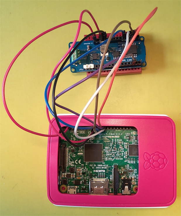

Connections
All signals and voltages are available on the Pi's 40-pin connector.
The table below cross-references all required signals, the location on the Pi header and the Shield pin.
I used the same Pi pins as Craig.
click to enlarge
Warning: https://forum.arduino.cc/t/wiring-a-mkr-canbus-shield-to-an-arduino-uno/670010
Also beware that the MKR Canbus Shield has an error on labeling the Can H and Can L on the BOTTOM of the board.
They are reversed. They are correct on the top of the board (in micro letters).
If the Shield is an end node (first or last unit connected to your CAN bus), set the terminate switch on the shield towards the resistor symbol.

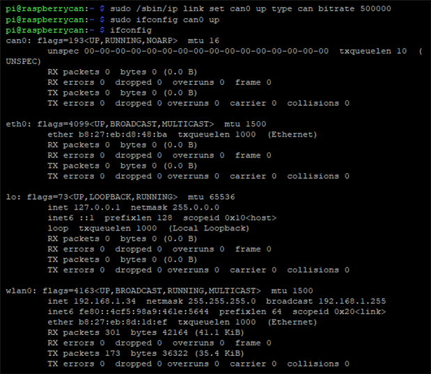

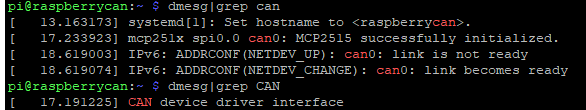

First enabled the driver for the MicroChip CAN controller by enabling an overlay.
Attention. The Arduino Shield has a 16 MHz crystal, so the oscillator attribute in the overlay string should be set to 16000000:
dtoverlay=mcp2515-can0,oscillator=16000000,interrupt=25
I tested if that was successful. dmesg reports a successful load:
Then I installed the CAN-utils package (check Craig's post for instructions).
I'm using the cansend and candump utilities of that package.
action video: hardware setup (with audio)

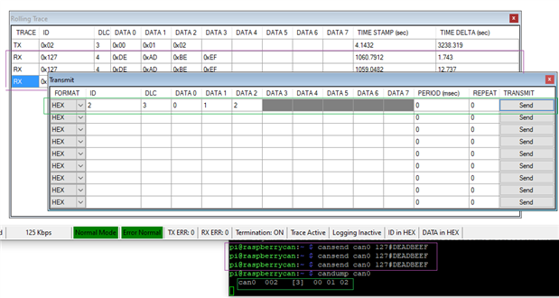

I used a MicroChip CAN Bus analyser (see links at the end of this project).
Ground, CAN Hi and CAN Lo of analyser and Shield are connected to each other (attention: wrongly labeled on the underside of the Shield).
Can Hi and CAN Lo wires should be twisted.
I then used both devices to exchange data and show the results. In both directions
Success!
