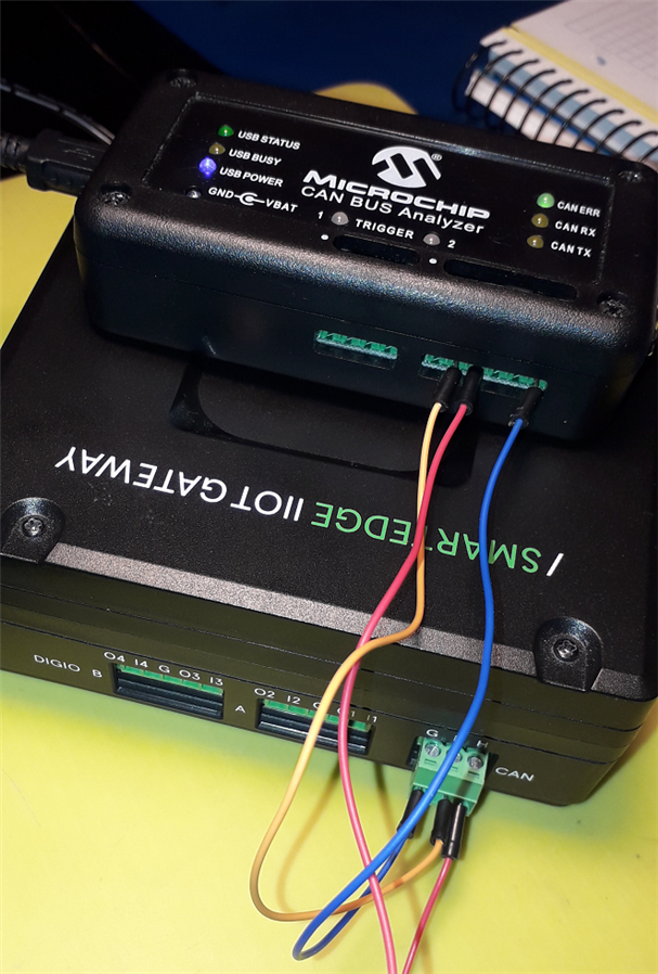

I'm using a SmartEdge IIOT GatewaySmartEdge IIOT Gateway . It's a Raspberry Pi 3 Compute based industrial Linux box. It has a CAN physical layer - a real CAN bus driver. And all drivers pre-installed. See AVNET SmartEdge IIOT Gateway: Use the Isolated CAN.

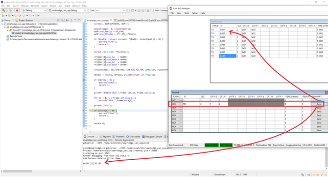

Let's pretend that all messages related to "car in reverse" are in the range 0x550 -> 0x55F.
We can set our filter as 0x550 and mask to 0xFF0.
In binary:
0b010101010000
0b111111110000
The CAN peripheral only watches for IDs where the relevant bits match the filter.
0b01010101****
Any message with ID between 0b010101010000 and 0b010101011111 will be passed to Linux.
That's what we wanted. Any message in the range 0x550 -> 0x55F.

The code will be sitting and waiting on line 07 until a message within range arrives.
A message passed through the filter. Click to enlarge.

struct can_filter rfilter[2];
rfilter[0].can_id   = 0x550;
rfilter[0].can_mask = 0xFF0;
rfilter[1].can_id   = 0x200;
rfilter[1].can_mask = 0x700;
The rest of the code is identical.
It will still listen to the 0x550 -> 0x55F range.
In addition, it will also send the payload to Linux when messages in this range appear on the bus:
Filter 0x200 and mask to 0x700.
