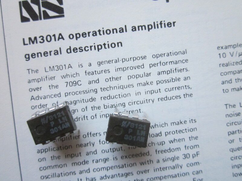

    The oldest ones I can find are these LM301AN parts with a 1981 date code. I'll try them out and see if they still work. They don't have internal compensation, so perhaps I could try experimenting with compensation techniques, or something like that.

    I've finally gotten around to trying the four that I had. They all work fine. The offset voltages at the input measure +281uV, +28uV, -80uV, and -776uV, so two of them are particularly good (the datasheet gives 2mV typ and 7.5mV max). I was going to try measuring the open-loop gain but that turns out to be quite difficult.
