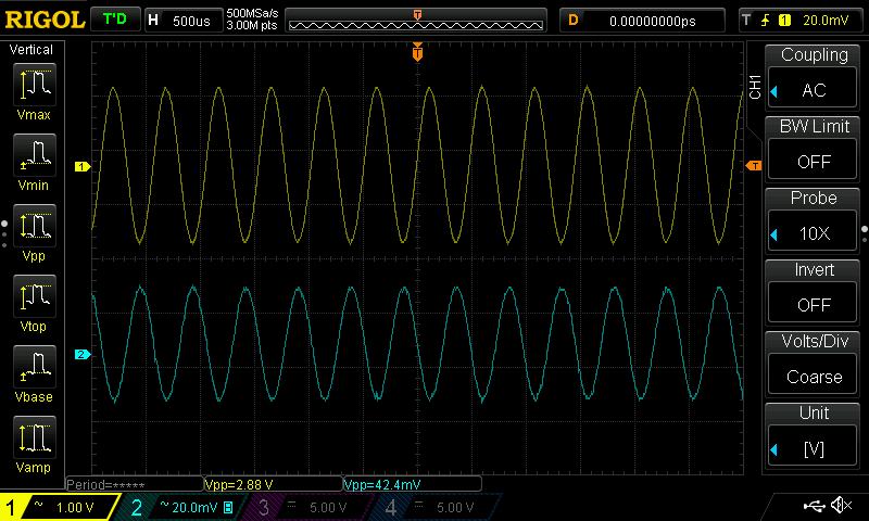

    I was wrong. You're not using the 'false summing node' method, you're measuring the loop gain and phase directly by injecting a signal, with the op amp biasing itself.
    That might be okay for doing a bode plot of at least some of the open-loop ac gain and phase [which is interesting in itself and very much worth a blog], but I think you'd have considerable problems extending that down in frequency towards the dc gain [the ac gain won't achieve the dc value until you get down to a few Hz, even with an old part like a 741].
    At the higher frequency end you'll need to be careful that the slew rate limitation of the output doesn't mess up your measurements. The bode plot that you see in a datasheet will be for the small-signal gain.

    Just a scope capture- not interpreted, not checked
    Frequency 2 kHz. I used averaging in the acquisition to filter out the noise. On channel 2 I also used 20MHz BW limit.
    Output inverted at low frequencies - 90° phase around 1 MHz. Around 1.6 MHz the two signals are in phase.

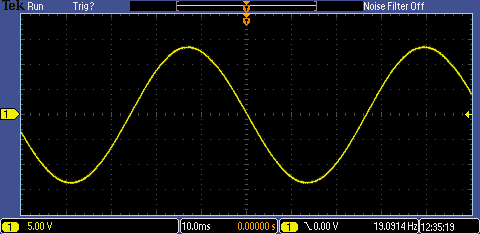

    ...but that turns out to be quite difficult.
    I should have added that I was trying to do it using the approach in that Analog Devices article, with a second opamp integrator to servo the first. This is what I get at the output of the DUT
    The loop oscillates nicely. I got rid of that by adding some resistance in series with the integrator cap, but there are still two issues. One is that the DUT amplifies the low frequency noise at the input, so the noise 'walks' the measurements around, the other is that there look to be various long thermal time constants internally in the LM301 that take a long time to settle and all that makes getting good readings difficult.
    Perhaps I should give up and try the false-summing-node approach that you're using.

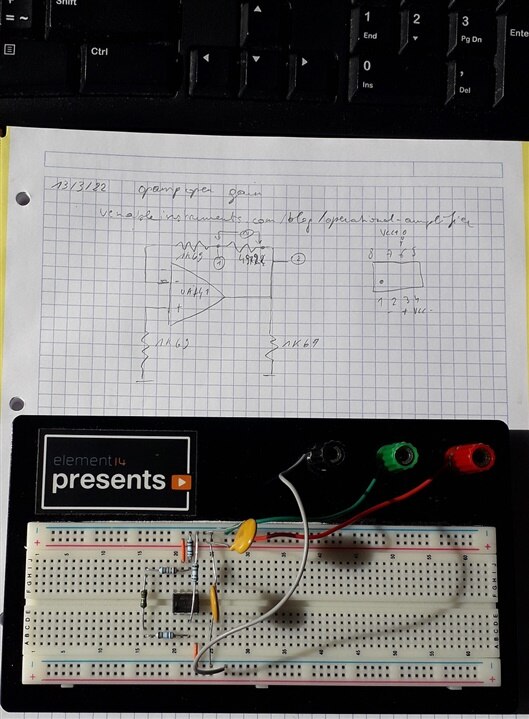

    This is a setup for the 3rd option. I replaced the 100R with 50R to match generator impedance. The 3 other resistors are 1K9 because I have no 1K's left.
    The IC is a ST ua741, I have a lot of those
