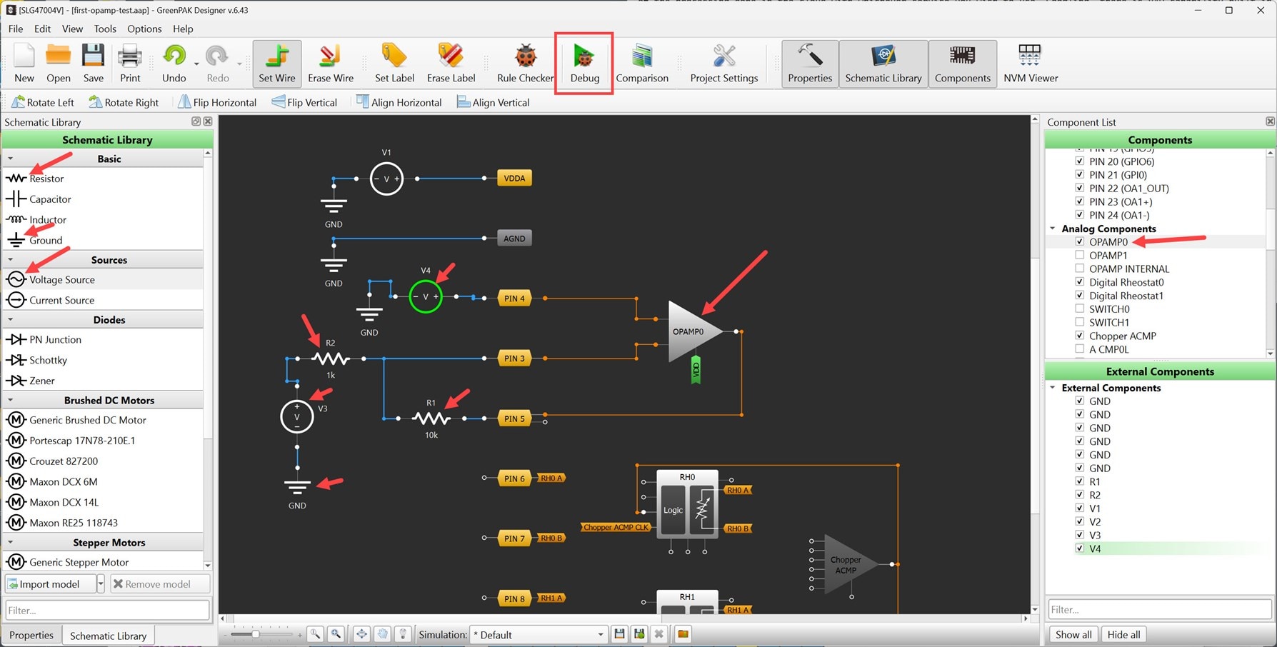

    I installed the software needed for the GreenPAK device, which is called (awful name) Go Configure Software Hub. Upon startup, it was possible to select the chip, and then a 'GreenPAK Designer' window appears with a center black area for schematics.
    For a first project I just clicked on the right-side pane list of internal components to choose an op amp. Them I selected some external components (resistors and voltage sources) using the left side pane. Very straightforward. Wires are added by clicking on any two nodes (only valid connections will be formed).

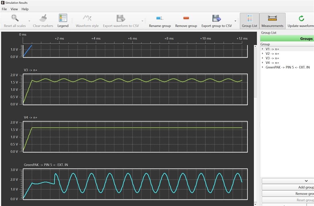

    Then, I clicked on Debug, a simulation pane appeared on the right, and then it was possible to right-click on nodes to add probes.
    When the simulation was run from the simulation pane, charts with the probe outputs appeared. The bottom blue trace is the op amp output.
    Interesting how the output wasn't correct for the first approx 2 msec. Probably that's the chip initializing itself (maybe). I'm guessing.
    So far I've only used the software, and have not tried to connect to the board.
    Anyway, this is really neat. I need to explore this more. There are examples online, that do more sophisticated stuff such as reading rotary encoders and generating adjustable sine-waves.
    The incredible thing is the low cost. These chips are about $2 in single quantity, yet house several op-amps, electronically controlled resistors, oscillators, logic and so on. They are also low-power (can operate from coin cells).
