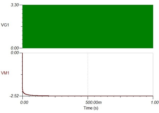

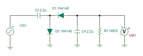

    I had a go with it in the simulator. TI have a model for the TLC555, which is a CMOS version, but it's painfully slow so I moved to using a voltage generator set to 507kHz and giving a 3.3V square wave out like this
    This is the result
    That's with a very light load, it doesn't do quite so well if you take 10mA from it. The slightly lower voltage probably comes from me using different diodes (did you use some 1N4001s, or something like that?)
    Potential problems with operating it that fast are the turn-off time of the diodes, if you use rectifier diodes, and also that cheap electrolytics might be struggling a bit above 500kHz, though your tants can manage.
