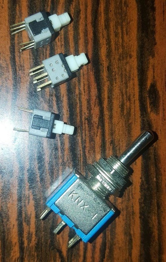

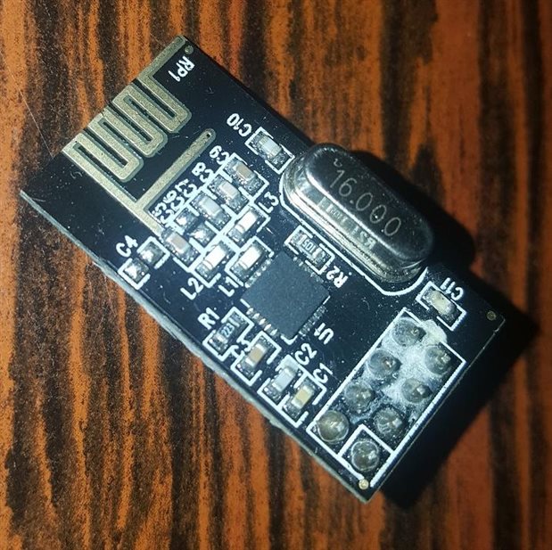

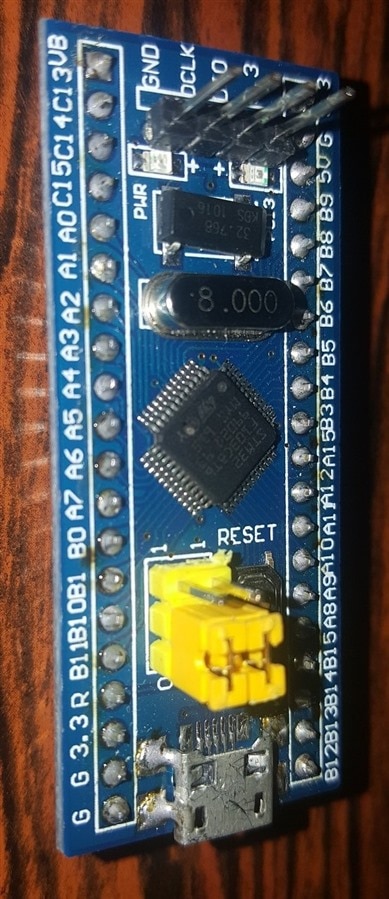

In this part I am going to explain how to built RF remote to control robot (or anything) using STM32F103C8T6 (aka blue pill), NRF24L01+, 2-axis analog joystick and few buttons (optional).

IMAGE TITLE: STM32F103C8T6
MAGE TITLE: NRF24L01+ module

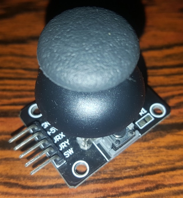

IMAGE TITLE: 2-Axis Analog Joystick
IMAGE TITLE: Buttons and Power Switch

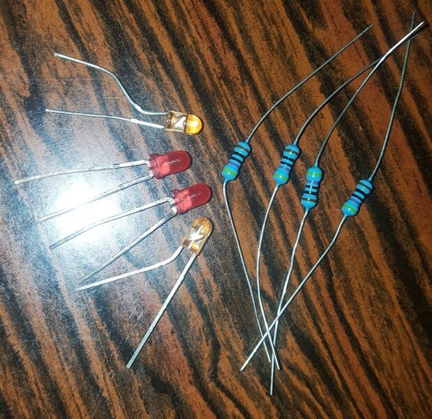

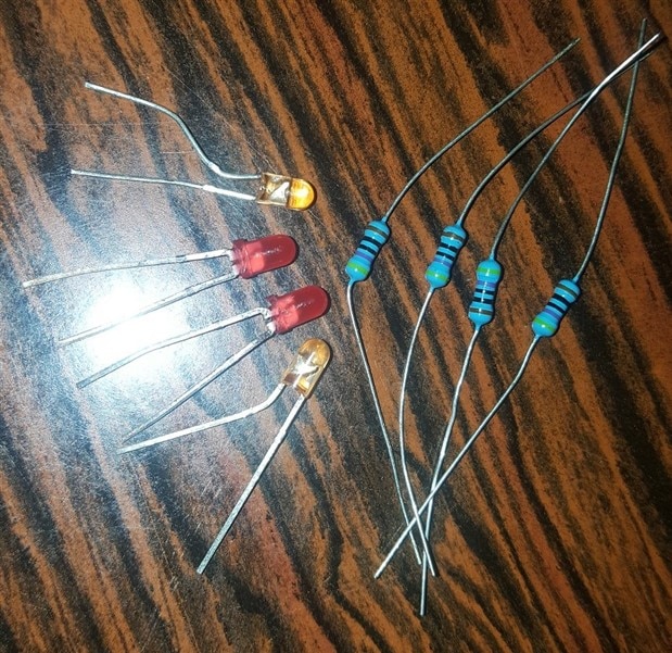

IMAGE TITLE: Small LED with 470R resistors to indicate communication and switches position

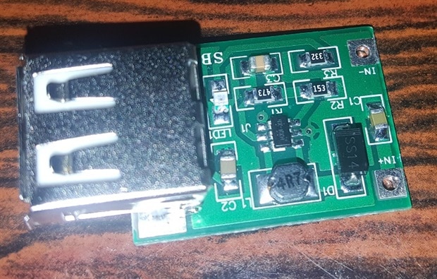

IMAGE TITLE: Li-Ion single cell to 5V booster

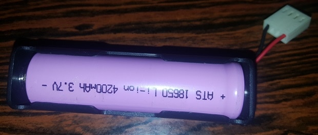

IMAGE TITLE: Li-Ion 18650 single cell with its holder

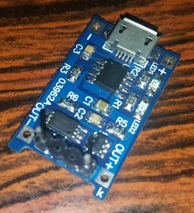

IMAGE TITLE: Li-Ion single cell charger with protection circuit

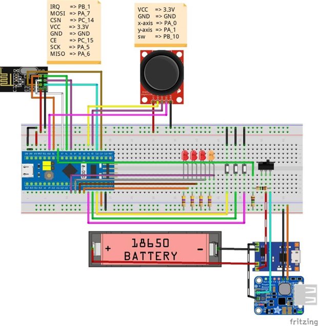

Circuit Diagram

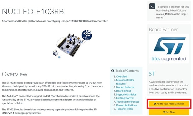

STM32F103C8T6 using Mbed
Before start programming we need to add STM32F103RB platform in mbed online compiler. In order to do that we will follow these step:
Goto:     https://os.mbed.com/platforms/ST-Nucleo-F103RB/
Click on "ADD to your Mbed Compiler" And it will take you to online compiler and add it to your platform list
After Adding NUCLEO-F103RB platform to Mbed online compiler. You can simply copy paste the code given below and add the STM32F103C8T6, NRF24L01+ and USB serial libraries from the important links.

This code use the micro USB port of Blue pill for debugging. And pin names that can be used in Mbed code are either shown in Blue boxes with white text or Green boxes with White text
tinyMonster Robot - RF Remote STM32F103 pinout compatible with Mbed
