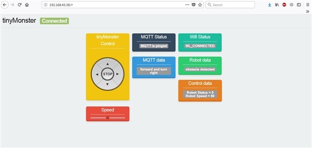

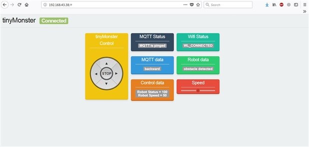

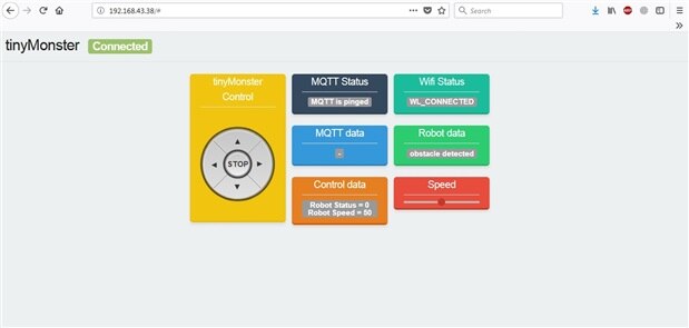

In This Post I am Sharing ESP code, Adafruit-IO setup, SPIFFS files, IFTTT applet and working GUI and serial communication images.
ESP Code

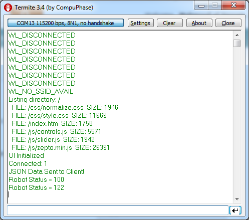

  Serial.begin(115200);
  delay(500);
  // Connect to WiFi access point.
  WiFi.mode(WIFI_AP_STA); //set mode to WIFI_AP, WIFI_STA, WIFI_AP_STA or WIFI_OFF
  WiFi.hostname(AP_SSID);
  WiFi.softAP(AP_SSID, AP_PASS);
  Serial.print("IP address: ");
  Serial.println(WiFi.softAPIP());
  delay(500);
  Serial.print("Connecting to ");
  Serial.println(WLAN_SSID);
  WiFi.begin(WLAN_SSID, WLAN_PASS);
  // Waiting to connect WiFi network if it cannot connect to provided wifi network or it is not in range it will move ahead and as soon as it will be in Range it will connect it automatically
  delay(500);
  while (WiFi.status() == WL_DISCONNECTED) {
    Serial.println("WL_DISCONNECTED");
    delay(500);
  if (WiFi.status() == WL_NO_SSID_AVAIL) {
    Serial.println("WL_NO_SSID_AVAIL");
    delay(500);
  else {
    if (WiFi.status() == WL_CONNECT_FAILED) {
      Serial.println("WL_CONNECT_FAILED");
      delay(500);
    else {
      while (WiFi.status() != WL_CONNECTED) {
        Serial.print(".");
      Serial.println("WL_CONNECTED");
      Serial.println(WiFi.localIP());

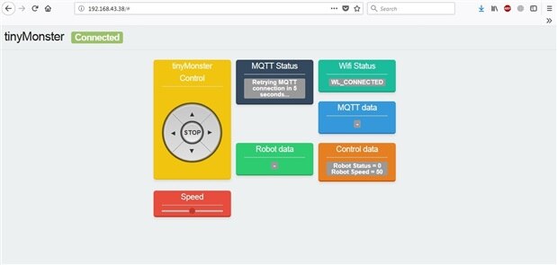

  // Setup ESPUI setup for robot.

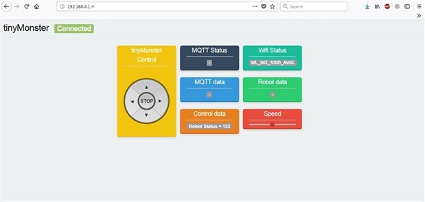

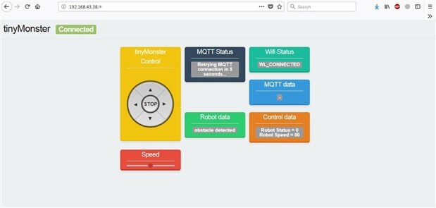

  ESPUI.pad("tinyMonster Control", true, &main_control, COLOR_SUNFLOWER);
  ESPUI.label("MQTT Status", COLOR_WETASPHALT, "-");
  ESPUI.label("Wifi Status", COLOR_TURQUOISE, wifi_status());
  ESPUI.label("MQTT data", COLOR_PETERRIVER, "-");
  ESPUI.label("Robot data", COLOR_EMERALD, "-");
  ESPUI.label("Control data", COLOR_CARROT, "-");
  ESPUI.slider("Speed", &speed_control, COLOR_ALIZARIN, "50");

  ESPUI.beginSPIFFS("tinyMonster");

  ESPUI.print("MQTT Status","Connecting to MQTT... ");
  uint8_t retries = 3;
  while ((ret = mqtt.connect()) != 0) { // connect will return 0 for connected
      ESPUI.print("MQTT Status","Retrying MQTT connection in 5 seconds...");
      mqtt.disconnect();
      delay(5000);  // wait 5 seconds
      retries--;
      if (retries == 0) {
        return;
  ESPUI.print("MQTT Status","MQTT Connected!");
  digitalWrite(mqtt_status, HIGH);

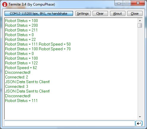

  Serial.println("Robot Status = " + (String)robot_status + " Robot Speed = " + (String)robot_speed);
  ESPUI.print("MQTT data", robot_data);

void speed_control(Control sender, int type) {
  robot_speed = sender.value.toInt();
  Serial.println("Robot Speed = " + (String)robot_speed);
  ESPUI.print("Control data", "Robot Speed = " + (String)robot_speed);
/***************** Robot Control Cmd From WLAN GUI ******************/
void main_control(Control sender, int value) {
  switch (value) {
  case P_LEFT_DOWN:
    if(robot_status == 100 || robot_status == 200 || robot_status == 0){
      robot_status += 22;
    else if(robot_status == 111 || robot_status == 211 || robot_status == 11){
      robot_status += 11;
    Serial.println("Robot Status = " + (String)robot_status);
    ESPUI.print("Control data", "Robot Status = " + (String)robot_status);
    break;
  case P_LEFT_UP:
    break;
  case P_RIGHT_DOWN:
      robot_status += 11;
    else if(robot_status == 122 || robot_status == 222 || robot_status == 22){
      robot_status -= 11;
    break;
  case P_RIGHT_UP:
    break;
  case P_FOR_DOWN:
    robot_status = 100;
    break;
  case P_FOR_UP:
    break;
  case P_BACK_DOWN:
    robot_status = 200;
    break;
  case P_BACK_UP:
    break;
  case P_CENTER_DOWN:
    robot_status = 0;
    break;
  case P_CENTER_UP:
    break;

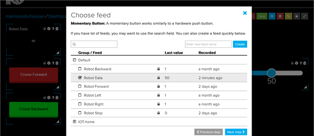

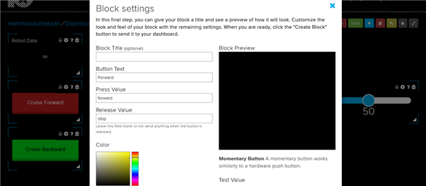

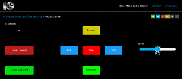

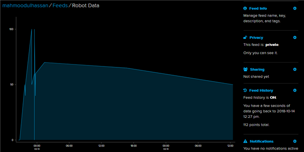

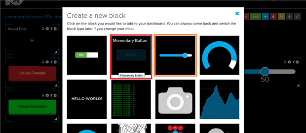

Adafruit-IO
{gallery} Adafruit IO Dashboard to Control Robot
IMAGE TITLE: Create Adafruit IO feed at default Location
IMAGE TITLE: Robot Data Feed
IMAGE TITLE: Create Dashboard Using Momentary Button and Slider
IMAGE TITLE: Final Robot Dashboard

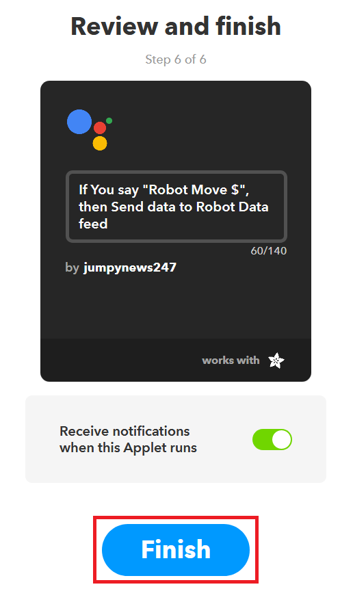

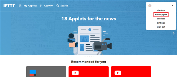

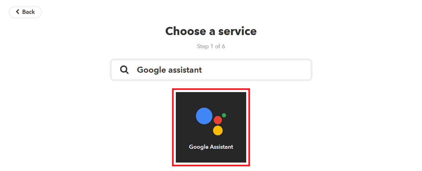

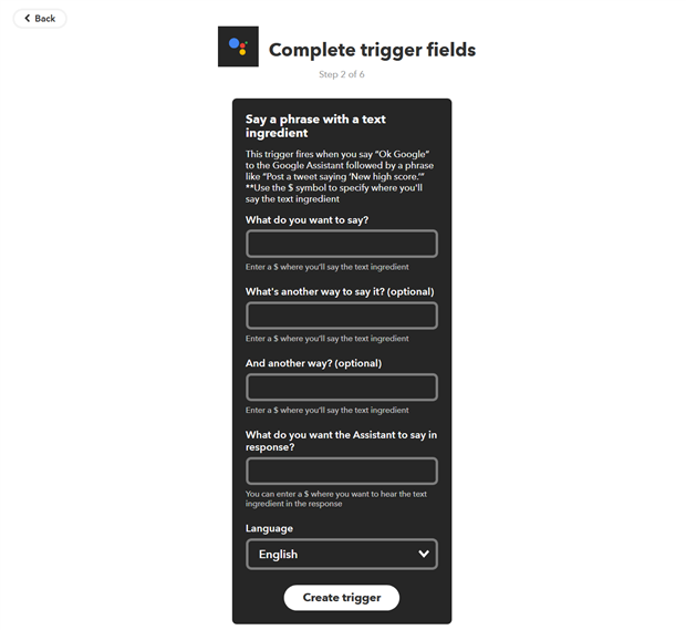

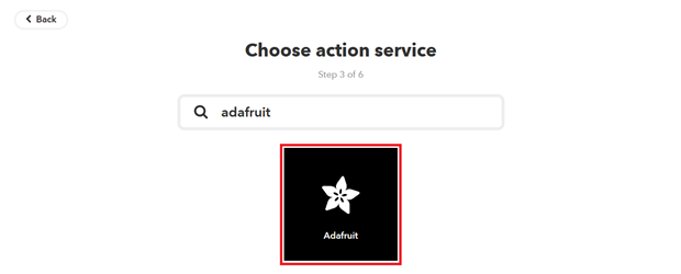

IFTTT applet
{gallery} How to Create IFTTT Applet for Voice Control
IMAGE TITLE: Create IFTTT account and goto menu and select "New Applet"

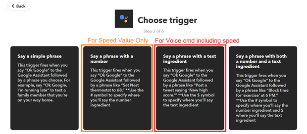

IMAGE TITLE: Select THIS
IMAGE TITLE: Search for google assistant, select and link your google account with it if asked

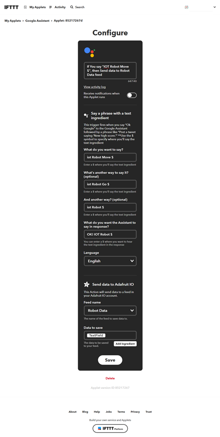

IMAGE TITLE: Select One of these mentioned trigger
IMAGE TITLE: Fill it by entering a unique phrase to command the robot
IMAGE TITLE: After creating trigger successfully select THAT

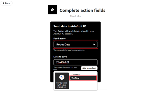

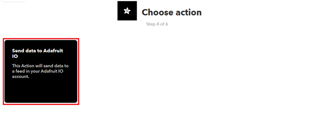

IMAGE TITLE: Search and select Adafruit Action service and connect AdafruitIO account (if asked)
IMAGE TITLE: Select send data to Adafruit
IMAGE TITLE: Select earlier created AdafruitIO feed and also TextField for voice commands
IMAGE TITLE: Select Finish to complete the Applet. Now repeat the process by selecting other action trigger
IMAGE TITLE: Applet I created to control tinyMonster Robot Voice Robot control command with speed info
IMAGE TITLE: Applet I created to Set tinyMonster Robot Speed using Numeric Voice command

ESP Demo
ESP GUI, various conditions and serial commands sent to NUCLEO for various control commands
{gallery} ESP Robot WLAN control
IMAGE TITLE: tinyMonster GUI - WLAN connected but cant connect to Adafruit MQTT
IMAGE TITLE: tinyMonster GUI - Obstacle Detected
IMAGE TITLE: tinyMonster GUI - WLAN connected And also connected to Adafruit MQTT
IMAGE TITLE: tinyMonster GUI - received voice command from Google assistant through Adafruit IO using IFTTT
IMAGE TITLE: tinyMonster GUI - received control command from Adafruit IO Dashboard
IMAGE TITLE: tinyMonster GUI - Control command from GUI and WLAN not in range
{gallery} ESP - NUCLEO Serial Communications
IMAGE TITLE: ESP to NUCLEO serial Communication including voice commands with speed info - tinyMonster Robot
IMAGE TITLE: ESP to NUCLEO serial Communication If WLAN is out of range and control through Acess Point - tinyMonster Robot
