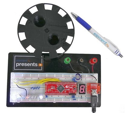

Most of the connections to the logic module in this image are just for demonstration purposes. The decoder only really needs 2 input wires and the 7 output resistors driving the 7 segment display.

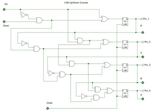

  • a 4 bit binary counter

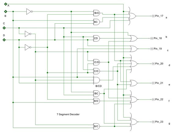

  • a BCD to 7 segment decoder

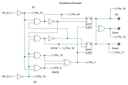

  • a description of a simple quadrature decoder circuit
  • a Visual Basic simulation of a simple quadrature decoder
  • a description of quadrature signals and a more accurate quadrature decoder circuit
  • a brief description of a 4 bit binary counter
  • a brief description of a BCD to 7 segment decoder
Demo
This first video shows the system in operation so it is clear what is being attempted and the components involved.
The slotted opto-couplers did not arrive so I used a pair of phototransistors instead.

I was only going to do the circuit above, but couldn't resist trying to design a quadrature decoder that could handle transition noise better.
I did implement the circuit above and it works okay, but it is possible to get counting pulses by rocking the wheel without rotating it.
The third video explains this improved design and delves into the signals involved in quadrature decoding with the more accurate decoder circuit:
PSoC Creator
This circuit counts pulses accurately in both directions and does not count pulses unless the wheel is actually rotating.

This project was a lot of fun. I got to design and print an encoder wheel, whip up a VB program and play with logic design - all in the process of figuring out a bit of a brain teaser circuit.
Although the slotted opto-couplersslotted opto-couplers never arrived, a couple of 40 year old phototransistors from the parts bin worked well enough to demonstrate quadrature encoding. I wasn't originally planning to implement a binary counter or 7 segment decoder within the PSoC, but the logic chips did not arrive either. Fortunately the PSoC had plenty of resources to implement these functions in addition to the quadrature decoder. This extra custom logic made the design and troubleshooting work a bit more involved, but it simplified the hardware build, and correcting logic issues was actually very easy.
