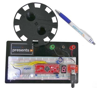

Most of the connections to the logic module in this image are just for demonstration purposes. The decoder only really needs 2 input wires and the 7 output resistors driving the 7 segment display.
I actually tried several different implementations of the quadrature decoder function because it was easy to make changes without any physical rewiring.
The complete project implements:
  • a quadrature encoding wheel and circuit

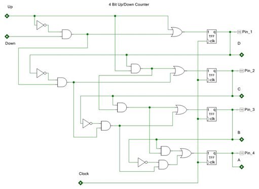

  • a 4 bit binary counter

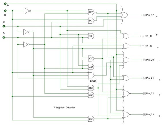

  • a BCD to 7 segment decoder
I ordered digital chips to do the counting and 7 segment decoding, but they have not arrived, so all of the logic is implemented in the PSoC device.

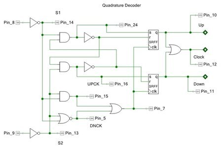

  • a description of a simple quadrature decoder circuit
  • a Visual Basic simulation of a simple quadrature decoder
  • a description of quadrature signals and a more accurate quadrature decoder circuit
  • a brief description of a 4 bit binary counter
  • a brief description of a BCD to 7 segment decoder

This first video shows the system in operation so it is clear what is being attempted and the components involved.
The slotted opto-couplers did not arrive so I used a pair of phototransistors instead.
1st Schematic Operation
The second video describes the first (simple) quadrature decoder I devised by using a visual Basic program to simulate the circuit. VB6 is a great tool for quickly implementing this simulation since it is can be used as a visual object oriented, event driven language. Each gate and its inputs and output are all visual and the code is a simple one line indicating what happens to the output based on what the inputs are. The gate code is automatically executed whenever an input changes so the program does not need a state machine. If an output changes because an input changed, and this output happens to be the input to another gate, it will automatically trigger the gate code for that next stage. No real program planning is needed:
2nd Schematic Operation
I was only going to do the circuit above, but couldn't resist trying to design a quadrature decoder that could handle transition noise better.
I did implement the circuit above and it works okay, but it is possible to get counting pulses by rocking the wheel without rotating it.
The third video explains this improved design and delves into the signals involved in quadrature decoding with the more accurate decoder circuit:
PSoC Creator
This circuit counts pulses accurately in both directions and does not count pulses unless the wheel is actually rotating.
