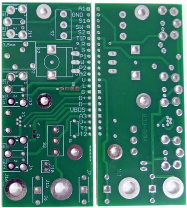

Bare BBC-PCB

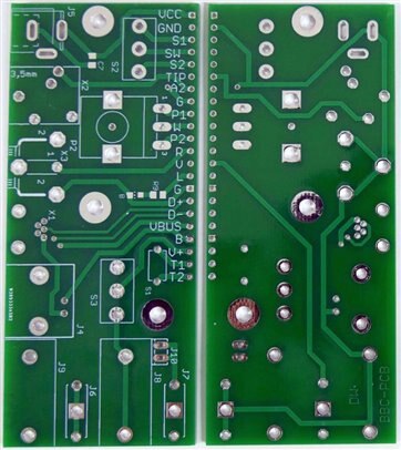

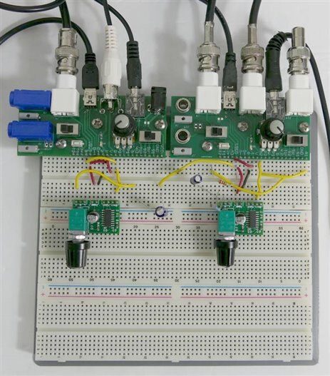

The solution I came up with is a BreadBoard Connector Printed Circuit Board (BBC-PCB). I actually designed a couple of variants to add different connector complements.
The first BBC-PCB I designed includes a suite of connectors that I typically might need to connect breadboard circuitry to external instrumentation and peripherals.
The second BBCPCB I designed can be built as an audio-centric connector interface or as an instrument-centric interface, or a mix of both. This is because there are 3 locations where the card can have either a BNC connector or an RCA connector.
Both PCBs include banana jacks, pin jacks, a USB connector, a 3.5mm stereo jack, 2 slide switches, a push button switch, a potentiometer, an LED, at least 1 BNC connector, and at least 1 RCA jack. One card includes a barrel jack while the other one can have a couple of extra BNC or RCA jacks.
The signal traces for all these components are routed on the top layer, it is easy to see which pin they are connected to on the breadboard. The breadboard pins are also labelled on the slikscreen, if you don't want to follow the traces.
One card has vertical banana jacks, so it can be butted up against another card.
Both cards have the same mounting hole arrangement, so they can be swapped if a different connector complement is needed.

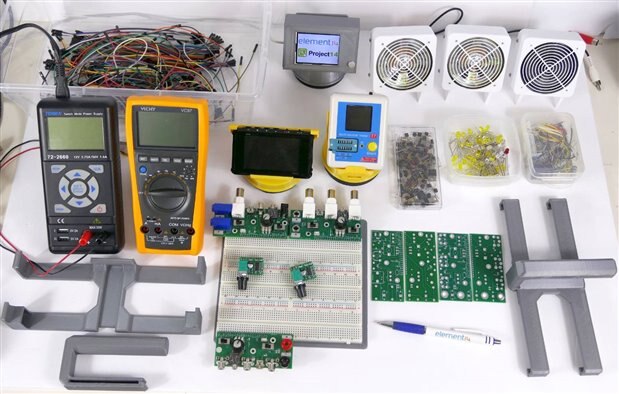

Portable Breadboard Kit
BBC-PCBs are one of the subjects covered in this blog, but I wanted to improve beyond just better interconnection, so I decided to make up a portable breadboard kit.
I expect to mainly use breadboards in blogs to do quick demonstrations, so some aspects of a good breadboard kit are about photgenics, but mostly it is about ease and speed of use.
Incidentally, the Project14 display module is based on a Raspberry Pi Pico.
This video describes some of the kit components and and how it can all be portable:

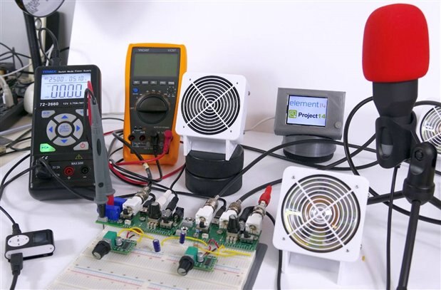

Speaker Test Setup
To provide an idea of the utility of the BBC-PCB, I put together a little demo to test the difference between 2 speakers with the same dimensions but different cone technology.
Here is a picture of the test setup:
The following video describes the Portable Breadboard Kit, the BBC-PCBs and how clean and easy it is to connect a lot of instrumentation to a breadboard using BBC-PCBs.
The final video shows how practical it is to use BBC-PCBs to perform test like this speaker test. It also shows that not all speaker technologies sound the same.

When I started this project, I had hopes that it would turn out to be something I use regularly. I am happy to conclude the system actually turned out to work better than expected. I haven't used it much yet, but as usual when working through a new test, I had to adjust the setup as I discovered more about the subject. The simple feature of having the cards securely screwed to the base plate provides a confidence-inspiring solid feel to the system. The BBC-PCB connector system really showed excellent flexibility in allowing changes to be made quickly and easily with stock cables and all the cabling remained manageable and relatively clean. I couldn't be happier with the results.
The design phase was fairly extensive since I had to design multiple PCBs and at least a dozen 3D printed parts. And the project took much longer than expected since I had to wait anxiously for quite a few parts that seemed to take for ever to arrive.
Fortunately all the PCBs and all the 3D printed parts worked great without modifications.
