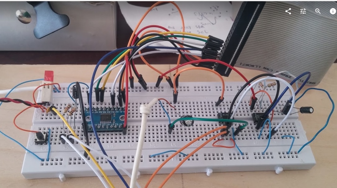

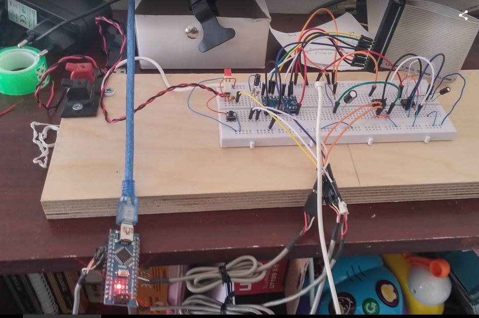

The Hardware
All you need is an arduino + some resisters and capacitors.

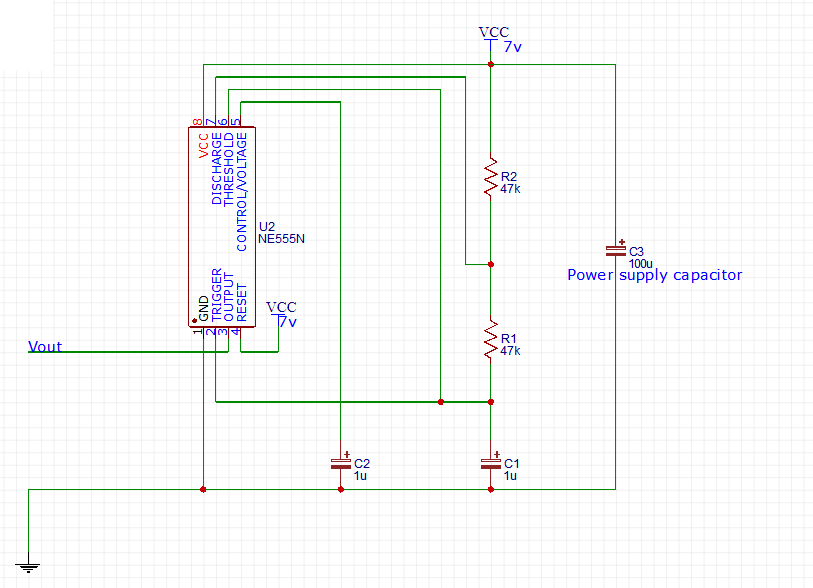

For simple testing purposes I used 555 timer with output swing from 0-5v, calculated the expected frequency and tried to match expectations with result samples.
{gallery} My Gallery Title

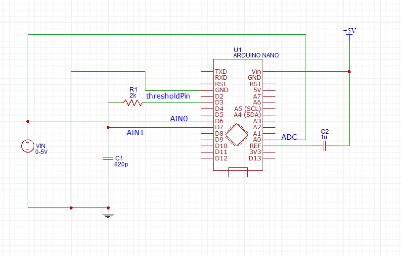

Full circuit: Arduino ADC connected to LM358N as input probe. ne555 as the test circuit. ne555 is supplied with 7v rail to rail so the output will be about 5v.
DB410c as tester: I use the 1.8v digital GPIOs on the dragonboard to the arduino ADC. I sometimes using level shifer txs0108e to provide arduino with 5v from DB410c
Girinoscope schematic: From girinoscope intructables it is very hard to tell what to connect where. You need to deep dive the arduino code to understand what to do. This simple schematic can help allot
555 Timer: I use this circuit to see if the calculated frequency of the 555 timer will match what I sample using arduino.

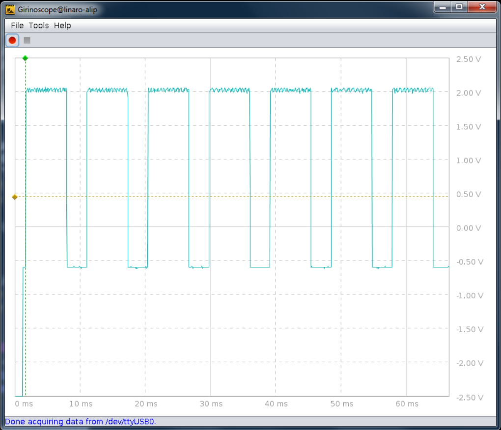

GUI: Acquiring sample from the girinoscope GUI

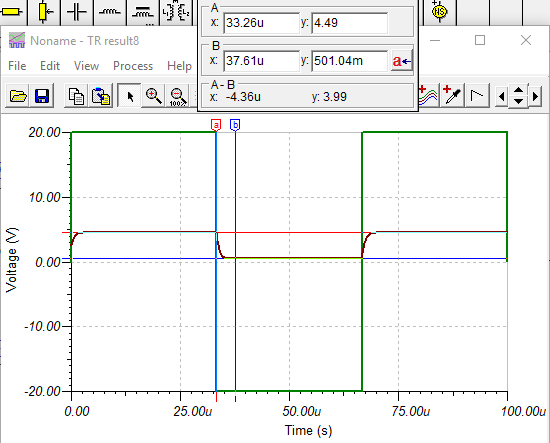

The probe - Try 1 (not that good, please review try 2)

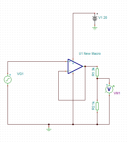

If I want to cross more than 5 volts I actually need to create a probe.
Special thanks to jc2048 and DAB for helping me navigating the world of opamps (there are thousand of them, and you gotta choose image)
I have tried a simple simulation with the MCP6024
Basically I made a 1/4 voltage divider for being able to insert arduino more than 5V.
This is the simulation results:
WAY BETTER THAN LM358N! (See photo gallery for old opamp result)
Vin is square wave 20V@15KHz
You can see output is 4.98V (fair enough for basic scope)
Only thing that worries me is rise and fall time on the max acquired BW (15KHz)
Questions:
  1. Maybe I need a higher BW op-amp?
    1. Does adding some passive component to the feedback loop will help?
  2. Do I need to add to Vout of the opamp some reverse protection diode to save arduino from human fault?

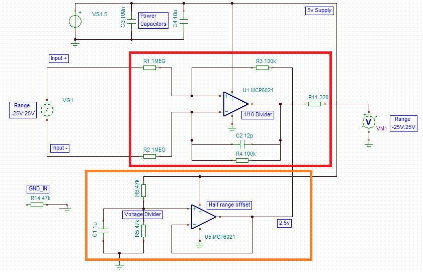

The probe - Try 2
  • Red circuit is is Differential amplifier
    • Vout=(R3/R1)*(V+-V-)
      • R1=R2 and R3=R4
    • How to reach that formula: http://www.electronics-tutorials.ws/opamp/opamp_5.html
    • C2 is for remove ringing. Real circuit have capacity in the wires, might need to be adjusted.
  • Orange Circuit is voltage offset
    • Since the opamp is 5V we need to offset for half meaning 2.5v
    • By adding 2.5V to to red circuit V+ we get -2.5v:2.5v input only by supplying 5v and GND to the opamp supply.
      • That I understood but could find proper analysis why??? (TODO - find a link to article)
  • Power supply
    • C2,C3 are for noise cancellation of the power supply (power supply decoupling)
  • U2,U3 are only 1:10 multiplier to work on low voltages.
    • http://www.electronics-tutorials.ws/opamp/opamp_3.html
  • C1 - power supply filtering
    • Remove some of the noise coming from the 5V and give a cleaner pseudo ground to work with.
  • R11
    • Isolates any capacitance on the output a little from the op-amp
  • R14
    • Input pit of GND that is connected to GND of the circut
    • Resistor is there to prevent high current from flowing when grounds are uneaven.
Probe schematic

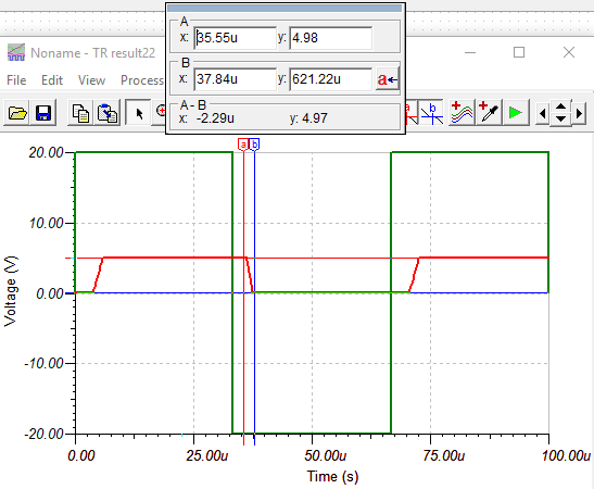

Simulation result
I put square wave of 20v out of 25v.
You can see the output is from 0.5v-4.5v.
T_fall is about 4u_sec which is pretty reasonable. less than 1/7 of the square wave low voltage time...

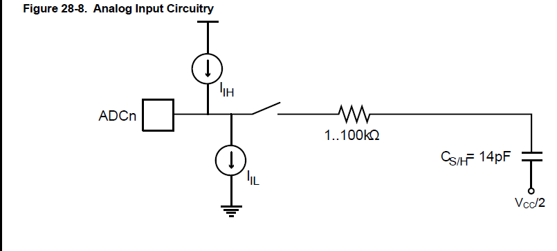

Pad schematic from atmel datasheet:

The signal is captured by girinoscope and The specified item was not found. for a reference.
I demonstrates trigger modes and sampling of the square wave by both scopes using girinoscope GUI.
The following video shows the probe detailed in this thread with 1:10 attenuation
Currently the opamp is the only one I have got LM358n which is manufactured around 30 years old, I have extracted it from an old circuit I have.
The opamp output is very noizy, I hope a newer opamp will do a better job (I put this video for proof of work of the probe)
Again caputes of both scopes are provided for a reference.

    jc2048 over 9 years ago in reply to idanre1
    This is what I was trying to guide you towards originally (I was hoping your university course might have introduced you to some simple op-amp circuits).
    I didn't design using the formula, but it's fine. The output is simply the difference between the input voltages multiplied by the ratio of the resistors. For the formula to be true, you probably need to add that R1=R2 and R3=R4.
    If you want to understand what it's doing, put voltmeters on both input pins in the simulation (the inverting and the non-inverting inputs) and see where they sit. [I tend to think of op-amp circuits in terms of levers and pivots - possibly that's how it was originally taught to me - and follow a sort of visual approach to mental design rather than working through formulae.]
    The orange circuit is just a pseudo ground sitting at half the supply. If you had two voltage rails, plus and minus relative to ground, you'd just use ground as your reference, but here we need to produce a ground of our own. That's quite common in single rail circuits. By fooling the differential amplifier into thinking that's where ground is, we get the swing both ways around 2.5V at the output, giving 0-5V out for -25V to +25V in.
    C2 and C3 are power supply decoupling. They make no difference to the simulation, but you'd want them in there for a real circuit (make the 10u an electrolytic and get it the right way round, the 100n is best as a ceramic and put it as close to the op-amp supply pins as you can get it). You might need to review this if your power comes from something like an Arduino, as it could be quite noisy [remember that this is a starting point for a prototype, not a finished, polished circuit].
    C1? That gives a bit of filtering - it will remove some of the noise coming from the 5V and give a cleaner pseudo ground to work with. The value I chose was a bit arbitrary (100n might have been enough) - I didn't sit down and calculate anything. If you are going to use 1k resistors, you may want to increase the capacitance a little (it's an RC filter, so as you decrease the resistors, you need to increase the capacitance to keep the same degree of filtering).
    R11? I just threw that in. It would probably be fine without it. It just isolates any capacitance on the output a little from the op-amp. If someone were to use the circuit with something other than Arduino, it might help a bit. It would also help if you wanted a length of screened cable between the output and the Arduino.
    R14? Connecting the grounds together gives a reference point to work with. The resistor is in case of accidents - ie if your Arduino wasn't floating and its ground was tied to mains ground, and your circuit had mains ground too, and you then clipped the ground to something in the circuit under test that wasn't ground, you might have a lot of current flowing in that connection, whereas with the resistor it's limited. Value is a bit high and you could reduce it a bit. Again, this is just ideas for your prototype, not a fully worked circuit. The actual measurement is between the plus input and the minus input, the ground just pulls both sides together if one or the other has a floating supply.
    Rise time came from
    Handbook of Linear Integrated Electronics for Research
    by T.D.S. Hamilton
    It's based on an assumption that the input of the vertical amplifier looks like an RC circuit, which is reasonable for practical amplifiers. Things are a bit different now, with digital 'scopes, but as far as I can see the manufacturers arrange their waveform reconstruction to give the equivalent result - that's certainly the case with my Tek scope where the risetime is the same as you would have seen with an old analogue scope of the same bandwidth.
    Don't worry about the time for the questions - it's all for the greater good, isn't it. [And remember I'm essentially a digital designer, so you'd probably do much better talking to someone who does this kind of thing for a living.]

    Since this is a noob scope I want to make a in-depth analysis on the circut. So a novice which basic knowledge will know what he/she building.
    Please correct my analysis if it's wrong.
    • Power supply
    • Why you need C1?
    • Why do you need R11?
      • Have you calculated impedance matching to the PAD of arduino (Schematic is provided below)
    • Why do you need R14 to GND?
    Probe schematic
    More questions image (Hope you have the time for all of my questions)
    Where did you get that from? can you provide a link with in-depth or something?
    For a traditional oscilloscope, the rise time is tr =  0.35/f.
    Trigger
    If you will take a look on the original circuit you will see AIN0/AIN1.
    I am using arduino ISR of a comparator to catch IRQ when Vin is answers to one of the triggers:
    Toggle, Rising edge, Falling edge
    Basically arduino always buffer 1K readings in internal memory and upon trigger capturing 0.25/.075 per-post trigger and sends it to PC upon IRQ.
    Indeed I am using 8bit for reaching 15KHz using arduino MIPS budget
    In-depth on how its done you can find in the instructables link I have provided at the top of the blog
    That's it for now.
    Regards
    Idan
  • jc2048
    Here's a revised circuit. I tried to replace the existing one, but just end up with the red ribbon telling me I'm probably logged out (even though I'm obviously not).
    I've increased the input resistors to 1 MOhm (I forgot to modify the previous one before posting it).
    Looking at what it does if you throw a very fast edge at it, the differential amplifier rings a bit. One way to deal with that is the capacitor I've added (C2). You might need to experiment a bit if it is a problem - that value works in the simulation, but won't be right for a real circuit (a real circuit might be fine without the cap at all; might need a larger value; you might need to adapt the internal compensation in some other way; or you might need to stop the fast edge reaching the op-amp at all).
    For a traditional oscilloscope, the rise time is tr =  0.35/f. For your 18kHz bandwidth, that gives a risetime of something like 19uS. So your slew time of a couple of microseconds shouldn't be an issue.
    Finally, I ought to say that this is just a circuit suggestion to experiment with. I haven't tried it and there's no warranty. (That's for the benefit of anyone who has just stumbled upon this blog and thinks they're looking at an expert piece of analogue design.)
