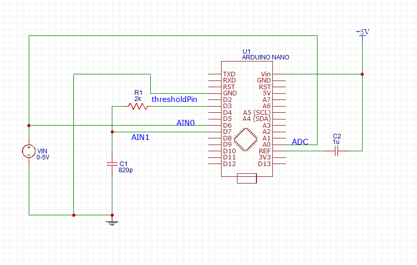

The problems with the tutorial are:
  1. Its explaining allot of the software and a general knowledge on how a scope trigger works, but:
    1. The info not that well explained to a noob that just want to build it.
    2. There isn't even a simple connections diagram.
    3. You need to deep dive the Atmel documentation to really understand what the tutorial explains.

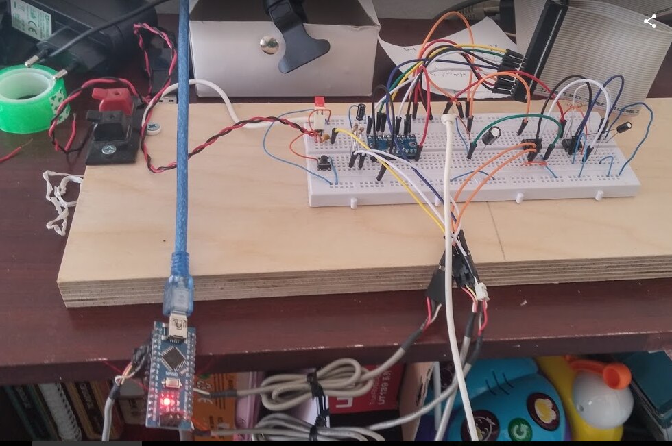

The Hardware

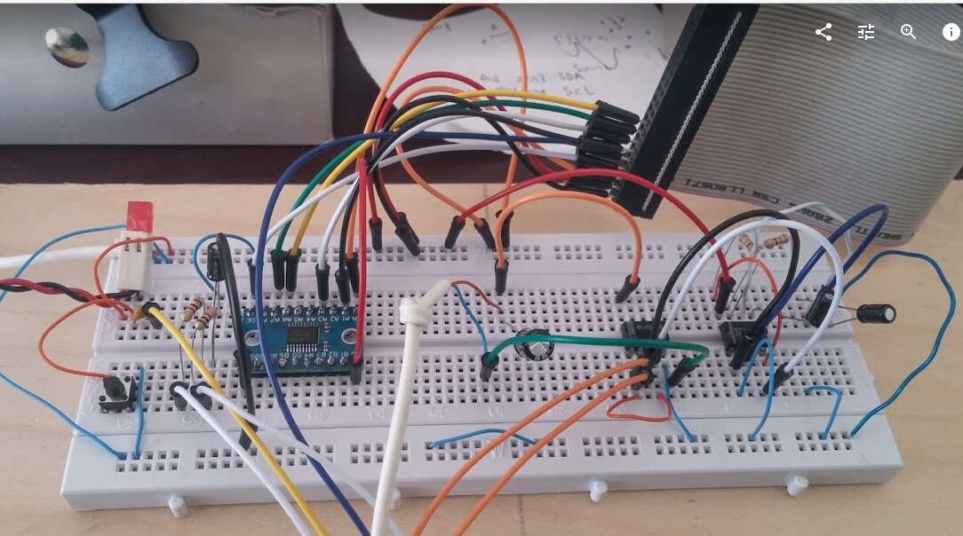

All you need is an arduino + some resisters and capacitors.
For simple testing purposes I used 555 timer with output swing from 0-5v, calculated the expected frequency and tried to match expectations with result samples.
{gallery} My Gallery Title
Full circuit: Arduino ADC connected to LM358N as input probe. ne555 as the test circuit. ne555 is supplied with 7v rail to rail so the output will be about 5v.

Girinoscope schematic: From girinoscope intructables it is very hard to tell what to connect where. You need to deep dive the arduino code to understand what to do. This simple schematic can help allot

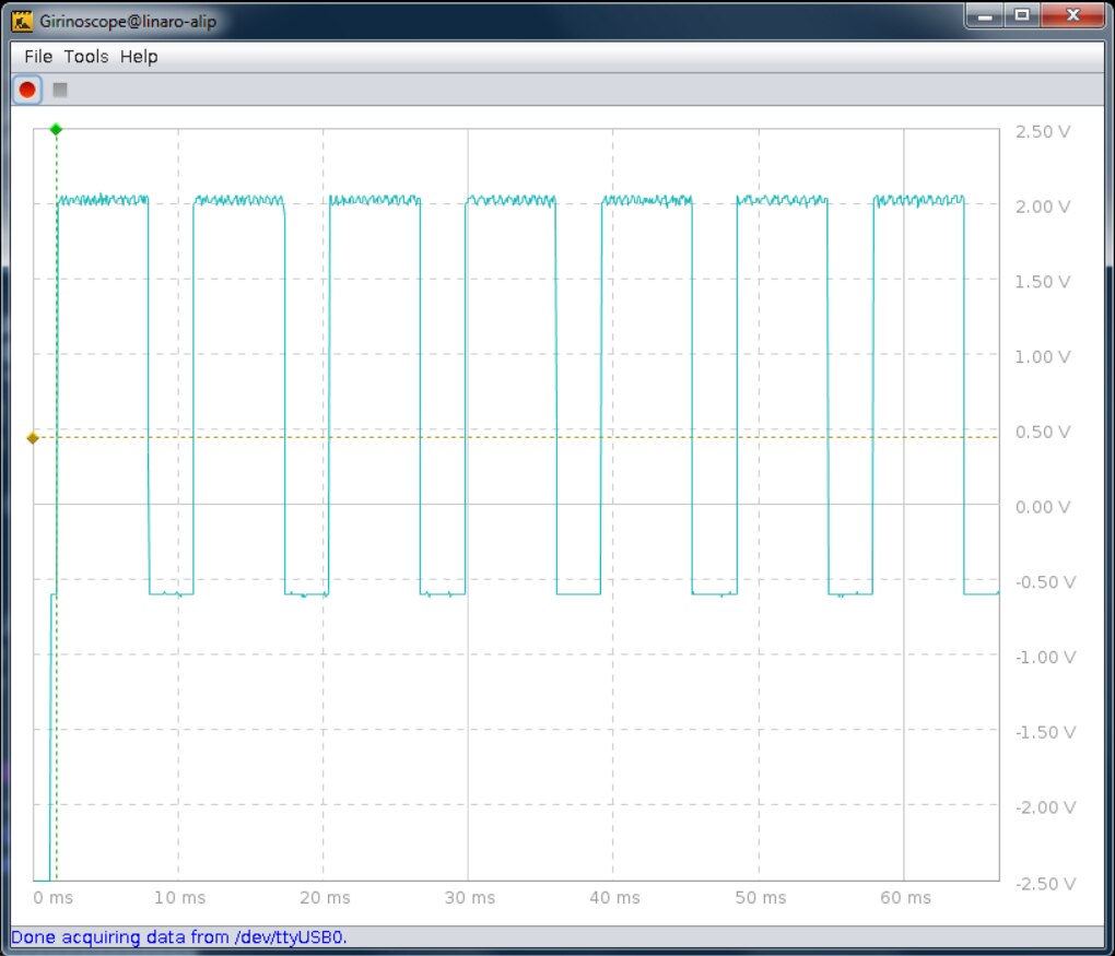

GUI: Acquiring sample from the girinoscope GUI

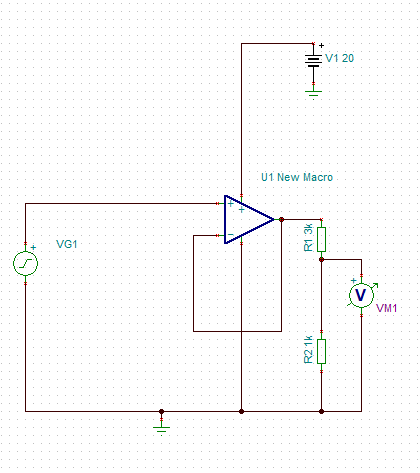

The probe - Try 1 (not that good, please review try 2)
If I want to cross more than 5 volts I actually need to create a probe.
Special thanks to jc2048 and DAB for helping me navigating the world of opamps (there are thousand of them, and you gotta choose image)

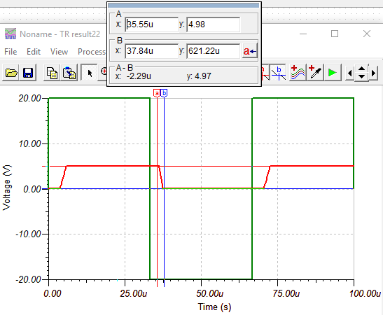

I have tried a simple simulation with the MCP6024
Basically I made a 1/4 voltage divider for being able to insert arduino more than 5V.
This is the simulation results:
WAY BETTER THAN LM358N! (See photo gallery for old opamp result)
Vin is square wave 20V@15KHz
You can see output is 4.98V (fair enough for basic scope)
Only thing that worries me is rise and fall time on the max acquired BW (15KHz)
Questions:
  1. Maybe I need a higher BW op-amp?
    1. Does adding some passive component to the feedback loop will help?
  2. Do I need to add to Vout of the opamp some reverse protection diode to save arduino from human fault?
  3. Why V_rise is slower than V_fall?

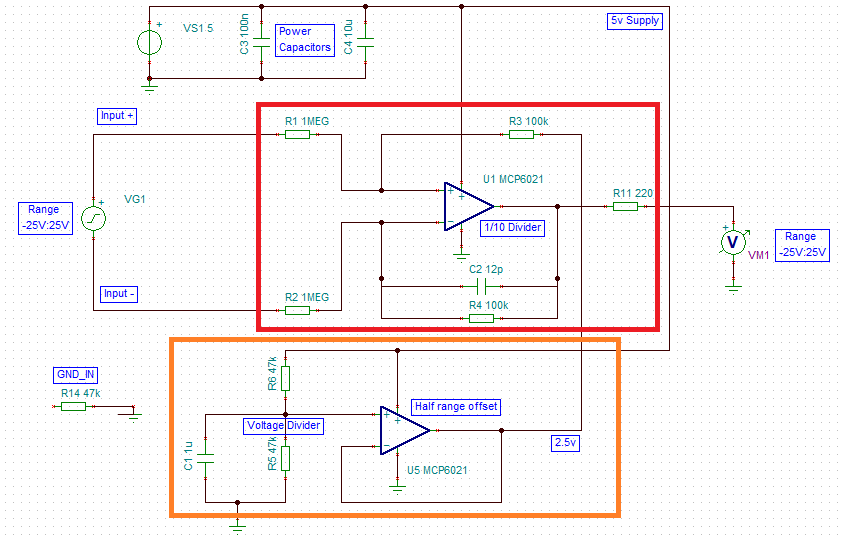

The probe - Try 2
  • Red circuit is is Differential amplifier
    • Vout=(R3/R1)*(V+-V-)
      • R1=R2 and R3=R4
    • How to reach that formula: http://www.electronics-tutorials.ws/opamp/opamp_5.html
    • C2 is for remove ringing. Real circuit have capacity in the wires, might need to be adjusted.
  • Orange Circuit is voltage offset
    • Since the opamp is 5V we need to offset for half meaning 2.5v
    • By adding 2.5V to to red circuit V+ we get -2.5v:2.5v input only by supplying 5v and GND to the opamp supply.
      • That I understood but could find proper analysis why??? (TODO - find a link to article)
  • Power supply
    • C2,C3 are for noise cancellation of the power supply (power supply decoupling)
  • U2,U3 are only 1:10 multiplier to work on low voltages.
    • http://www.electronics-tutorials.ws/opamp/opamp_3.html
  • C1 - power supply filtering
    • Remove some of the noise coming from the 5V and give a cleaner pseudo ground to work with.
  • R11
    • Isolates any capacitance on the output a little from the op-amp
  • R14
    • Input pit of GND that is connected to GND of the circut
    • Resistor is there to prevent high current from flowing when grounds are uneaven.
Probe schematic

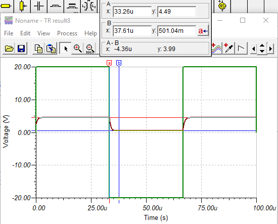

Simulation result
I put square wave of 20v out of 25v.
You can see the output is from 0.5v-4.5v.
T_fall is about 4u_sec which is pretty reasonable. less than 1/7 of the square wave low voltage time...

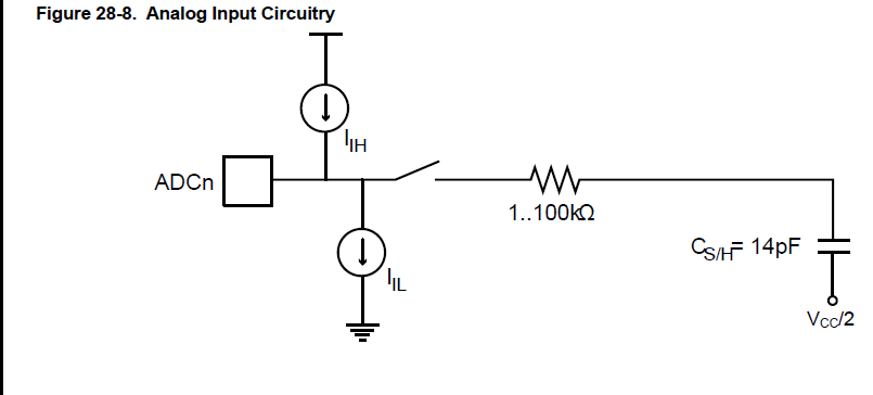

Pad schematic from atmel datasheet:
I think the next step is to order this opamp
This would probably not happen during this competition period (shipping takes a while where I live)

The following video shows db410c (similar to RPI) generating square wave using one of its GPIOs in 1.8v
Then a level shifter which is design to between-chips communication is used to amplify the signal to 5v www.ti.com/lit/ds/symlink/txs0108e.pdf
The signal is captured by girinoscope and The specified item was not found. for a reference.
I demonstrates trigger modes and sampling of the square wave by both scopes using girinoscope GUI.
