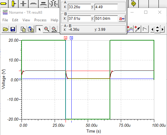

The probe - Try 2
  • Red circuit is is Differential amplifier
    • Vout=(R3/R1)*(V+-V-)
      • R1=R2 and R3=R4
    • How to reach that formula: http://www.electronics-tutorials.ws/opamp/opamp_5.html
    • C2 is for remove ringing. Real circuit have capacity in the wires, might need to be adjusted.
  • Orange Circuit is voltage offset
    • Since the opamp is 5V we need to offset for half meaning 2.5v
    • By adding 2.5V to to red circuit V+ we get -2.5v:2.5v input only by supplying 5v and GND to the opamp supply.
      • That I understood but could find proper analysis why??? (TODO - find a link to article)
  • Power supply
    • C2,C3 are for noise cancellation of the power supply (power supply decoupling)
  • U2,U3 are only 1:10 multiplier to work on low voltages.
    • http://www.electronics-tutorials.ws/opamp/opamp_3.html
  • C1 - power supply filtering
    • Remove some of the noise coming from the 5V and give a cleaner pseudo ground to work with.
  • R11
    • Isolates any capacitance on the output a little from the op-amp
  • R14
    • Input pit of GND that is connected to GND of the circut
    • Resistor is there to prevent high current from flowing when grounds are uneaven.
Probe schematic
Simulation result
I put square wave of 20v out of 25v.
You can see the output is from 0.5v-4.5v.
T_fall is about 4u_sec which is pretty reasonable. less than 1/7 of the square wave low voltage time...
Pad schematic from atmel datasheet:
I think the next step is to order this opamp
This would probably not happen during this competition period (shipping takes a while where I live)

    Are you intending this to run from the +5V Arduino supply? If so, the op-amps need to run on 5V [a lot of older ones didn't]. The outputs need to get to the rails [old bipolar op-amps mostly didn't], otherwise you'll restrict the range of the ADC input that you can use. You'll also probably want the inputs to work to the rails too (I said probably because we don't know the circuit yet) [again a lot of older bipolar op-amps were poor at this - doesn't mean they were bad op-amps, just inappropriate for what you want here]. If the scope is going to be fairly precise, you don't want the input bias currents and the current and voltage offsets to be too large, though that isn't too much of an issue here [traditionally, FET and CMOS op-amps were good for low bias currents but often poor for offsets - but that has changed a lot in the last decade or two - better automation means they can be trimmed at manufacture]. You also need enough bandwidth from the op-amp so that it can work properly over the range of frequencies you will be looking at with the scope. The quick measure of bandwidth is the GBWP (gain-bandwidth product) - that's the frequency where the gain of the op-amp falls to unity; it needs to be much higher than the highest frequency you are working with (how much higher will depend on the circuit configurations you use, but a GBWP of 5-10MHz is the right sort of area for 100kHz of bandwidth at the scope input as long as you're not asking for too much gain from the amplifier).
    Presumably, you don't want to be paying $20 for it either.
    That will reduce the number of possible contenders quite considerably. If you also throw in the requirement that it be a conventional package rather than surface mount (to make your prototypng easier) then you're probably down to just a few devices from each manufacturer (they'll all have something that will do this because they're agressively competing with each other for your chip business.)
    Here's one possible contender. If you download the datasheet and look through it you'll see how it's specced and you should be able to locate most of what I've just gone through amongst the tables.
    MCP6024 - Amplifiers and Linear - Linear Op Amps
    Other manufacturers you could look at include TI (Texas Instrumenats), AD (Analog Devices), ON Semiconductor (don't know what the ON stands for!), and LT (Linear Technology).
    What do you want to do next?
    Either you could try doing something for yourself or we could give you a circuit to experiment with. If you've already done some op-amp circuits, you might want to try piecing something together for yourself as a learning exercise (and for the challenge), if not you might prefer to have an example circuit with an explanation to get you started and give you something to play with.

    Hi Jon
    Simulating the circuit might be a great idea.
    I downloaded TINA TI from the official website and I have version 9.3.150.328
    I followed the instructions on how to import a spice model and when I tried to compile the model I got an error:
    Have a clue whats wrong? you mentioned you got it worked like a charm.
    How to simulate the load
    I need to have a behavioral model of the load.
    Do you have a hint how to simulate the PAD of the ADC pin in the arduino? (A0 pin)
    Thanks!

    You don't need to be compiling anything.
    Make a copy of the .txt file and change the extension on the copy to .lib.
    Open the New Macro Wizard from the Tools menu.
    Enter the Macro name and select 'From file' and point it at the .lib
    click 'Next>'
    You should see this
    If you want you could accept that shape, but I prefer a traditional symbol so
    select 'Load shape from library'
    untick 'Show suggested shapes only'
    use the down arrow to the right of the symbol displayed to drop the list down, move down to <Amplifier5G> and select it.
    You'll then have this
    click 'Next>'
    You'll then get this screen for doing the pin assignments. For some reason it manages the output pin for itself but not the others.
    You then drag the unconnected pins which are flashing to the pins you want them attached to on the symbol.
    You can tell which pin numbers go where from the netlist shown in the window underneath.
    click 'Next>' again
    That will then bring up save dialog box and you can save it wherever you want.
    Finally you'll get this message box and can insert a single instance onto the circuit diagram.
    From then on you can insert additional devices using 'Insert Macro' from the 'Insert' menu.
    Unfortunately, that standard symbol is upside down, so I mirror then rotate right twice to get the + supply pin at the top. If you're good with software, you might want to try reworking the symbol.
    And this is what it looks like on the circuit
