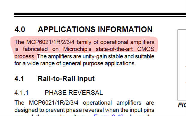

  • jc2048
    jc2048 over 9 years ago in reply to idanre1
    1. Only to a quarter of a volt below.
       How is it done? I don't know. I'm not a chip designer. But if the datasheet says it can, then it can.
       Really they're just saying that the input definitely goes all the way to both rails and doesn't fall a little bit short.
       As long as you like, as long as you stay within the operating limits they give.
    2. Depends on what the ADC looks like at the input - some present quite a capacitive load which op-amps tend not to like, at least not driving directly. Both would do fine driving the Arduino analog inputs.
    3. There are clues in the datasheets, some more obvious than others

    idanre1 over 9 years ago
    Questions about op-amps
    Hi
    I have tried to find an op-amp for my purposes just as an exercise
    I encountered http://www.ti.com/lit/ds/symlink/lm6142.pdf
    1.
    TI claims you can provide Vin lower than the negative power supply.
    How it can be done?
    Also I coudn't find a graph saying how much time I can provide lower than supply signal without tempering the output
    I searched for Vout depends of Vin&supply, what am I missing?
    2.
    Also according to the datasheet this opamp is good for ADC application
    MCP6024 also have CMRR of 85-90 db.
    Is there a reason why TI says their opamp is good for ADC but microchip not?
    3.
    I couldn't find which technology types both the opamps rely on.
    Is it CMOS? JFET? BJT?
    Where it can be found?
    Regards
