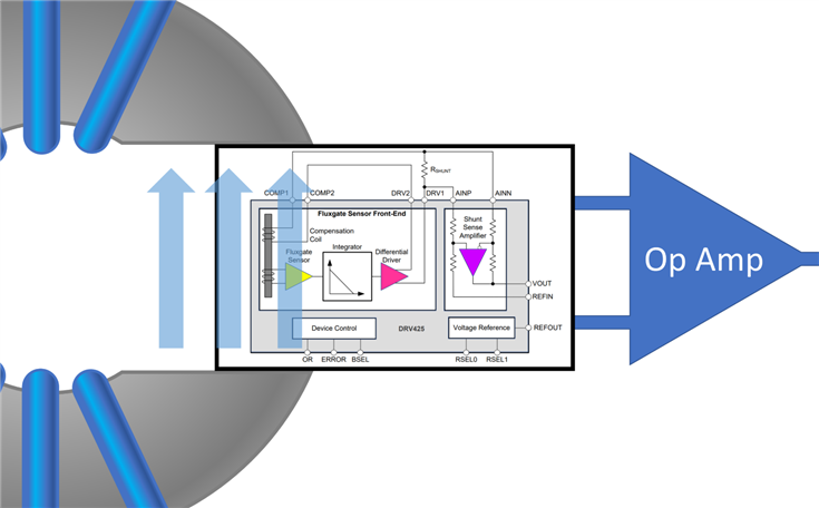

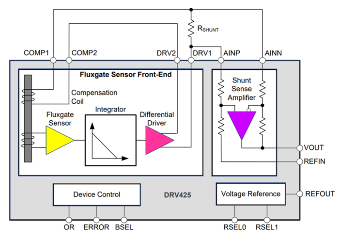

Fluxgate magnetometers have exceptional sensitivity and can detect the earth’s magnetic field. Texas Instrument has several ICs that contain all the signal generation and signal processing required to construct a fluxgate magnetometer. There is also one IC in the range which even integrates the core inside the package. I decided to use that IC for this project. All I needed to worry about was how to generate the external magnetic field, and that is possible with an external winding.
The diagram here from TI’s website shows the internals of the IC. All of this is integrated into a tiny square 4x4mm package.

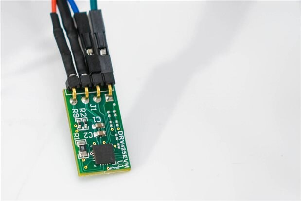

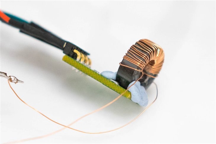

As mentioned the fluxgate magnetometer resides on a single chip, so there is no work to do there. It is in a 4x4mm surface mount package (QFN) which is awkward to work with however an evaluation board is available with it pre-soldered. I used that.

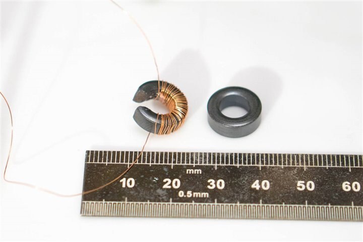

To construct the magnetic field, I used a ferrite core; some experimentation here could be useful, I used Amidon FT-50-43 in my tests but others could be used too. Several will need to be purchased because it is almost inevitable that they will be damaged at the next step, the yield is very low. A slot was cut into the core, so that the 4mm fluxgate magnetometer could be a snug fit. With hindsight I didn’t need to cut all the way into the core, just the thickness of the IC would have been sufficient. Anyway, attempting to cut or file the core will almost certainly result in it breaking apart unless lots of care is taken. I couldn’t find a perfect strategy, but 3D printer owners could construct a jig to precisely hold the core during the cutting operation.
Enamelled wire was wound around the core; I picked 40 turns as a ballpark to experiment at, and 0.2mm diameter wire fitted well. A bit of glue can secure the ends from unravelling. The resistance of the coil is about 0.4 ohms, but with slightly thicker wire (which would fit) the resistance can be reduced. 0.3mm diameter wire would halve the resistance for example.
Next, it needs to be secured to the fluxgate magnetometer board. Since I wanted to experiment, I just used blu-tack (temporary putty) for now instead of a permanent glue. Although it looks like it might function poorly with such a trivial attachment, the result is very stable. The measured current does not fluctuate.

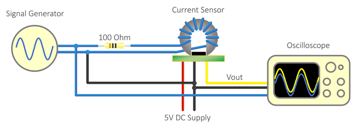

In use, the circuit would be broken at the point where the current needs to be measured, and the ends of the wound coil would be attached into the circuit. For the tests below, it was decided to use a resistor and a signal generator as the circuit under test. The circuit was broken and the current sensor was inserted in. The output of the current sensor went to an oscilloscope. I borrowed an oscilloscope from work for this, it needed the big gun Tektronix MDO3000 so that I could use some advanced math features and waveform processing capabilities to make my life easier.
So, this was the topology:
Although there was no need to connect the signal source to the oscilloscope, it was connected to measure the voltage across the input resistor, to determine how much current was flowing through the current sensor input. For all the traces below, the important trace is the yellow trace which is the output from the current sensor. The blue input trace is just a reference to see what the input signal looked like. For these initial tests, even though the current sensor responds to DC, the oscilloscope was set to AC input because the output has an approximate 2.5V offset. The oscilloscope bandwidth was set to 20MHz for these tests.

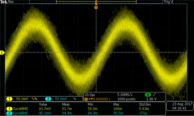

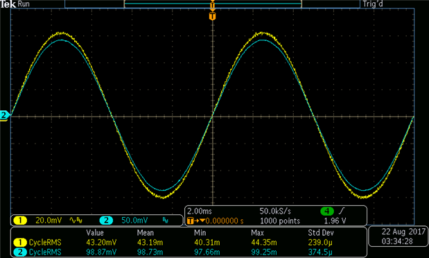

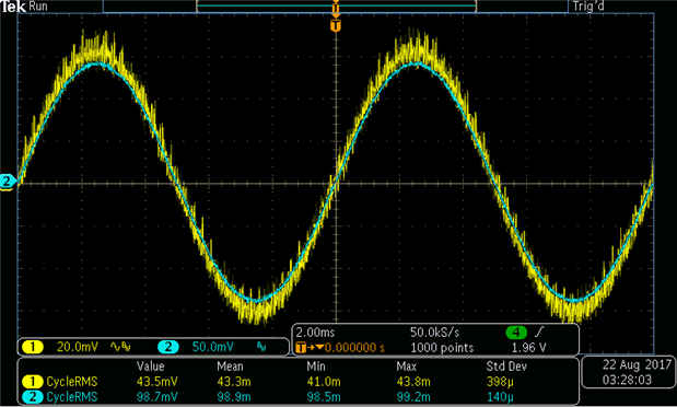

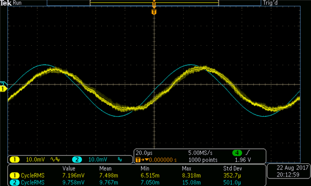

100Hz, 1mA RMS Input current
As an initial test, a low frequency (100Hz) was used. From the measurements at the bottom of the ‘scope display you can see that the input signal was 100mV RMS and the output was around 43mV RMS. Since the input blue trace was measured across a 100 ohm resistor (approximately), that means the current through the resistor was 1mA RMS. The yellow trace shows that the current sensor therefore has a sensitivity of just over 40 volts per amp (i.e. 43mV divided by 1mA).
There is some noise on the output, but that could partially be due to the measurement since it is a low-level signal (43mV RMS) that is being observed.
To examine if the trace could be cleaned up a bit, averaging was turned on in the MDO3000. At a default averaging setting (16 or 32 averages, I need to double-check), this is what the output looked like:
So, for repetitive current draw at around 1mA RMS and at low frequency, it is possible to get a very clean output from this solution.

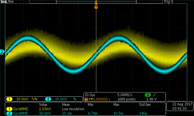

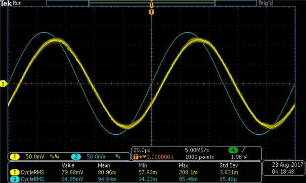

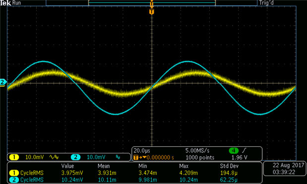

10kHz, 100uA RMS Input current
As a more extreme test, the frequency was increased to 10kHz, and the current was reduced to 100uA. At this level I would expect the output to be noisier, and perhaps observe some phase difference due to delay between input and output, and see a change in gain perhaps if the frequency response is not flat. Here is the observed result:
With averaging turned on, this was the result:
The output is about 3.9mV RMS which corresponds to a sensitivity of 39 volts per amp. So, compared with the 100Hz 1mA RMS traces earlier, this result shows that the frequency response is fairly flat to at least 10kHz. These measurements were not precise, these are just quick measurements to characterize the behaviour slightly.

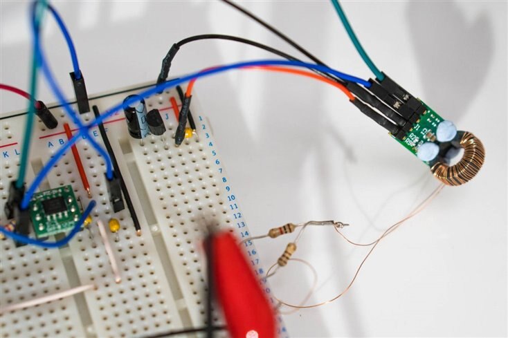

Building an Amplifier
By now it was clear that the output benefits from an amplifier to make best use of it. I used an Analog Devices AD8226AD8226, assembled into a 20x gain instrumentation amplifier on a breadboard. There isn’t a lot to the circuit (I’ll draw it up if there is interest), but basically it consists of a 2.7k resistor to set the gain, and a couple of 100nF capacitors for supply decoupling. It was powered from +10V/-10V supplies, and the 2.5V reference output from the DRV425 board was used as the offset input to the amplifier. Some trimming would be useful to completely null out the 2.5V offset, but it was mostly nulled out, enough for me to switch to DC on the oscilloscope, for some of the tests below. For a real design the frequency response of the amplifier should be confirmed to be flat; I didn’t characterise it since it was just a quick hack on a plastic breadboard, and I could always circle back if I saw any anomaly in the subsequent tests.

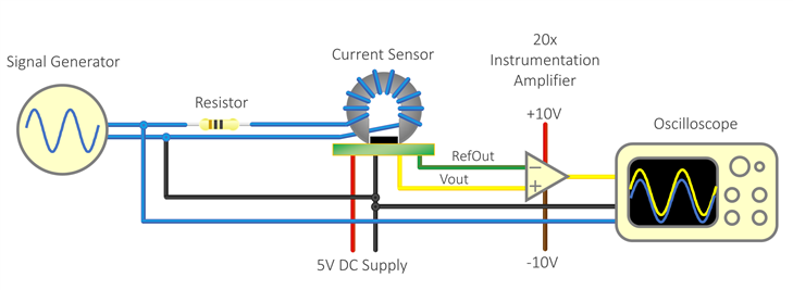

Tests with the Amplifier
The diagram here shows the test topology:

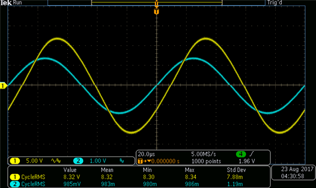

10kHz, 100uA RMS Input Current
With the amplifier connected, the output was clearer and of course larger. I was no longer in the noise with the oscilloscope gain having to be set at max. I use a 1kohm resistor for this test.
The voltage across the 1kohm resistor is about 100mV RMS according to the blue measurement on the oscilloscope, so that corresponds to 100uA RMS input current. The yellow output is about 81mV RMS which means the sensitivity with the amplifier is 800 volts per amp.

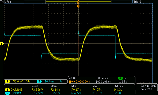

I kept the averaging on, and with a square wave input (again at 10kHz, 100uA RMS), the bandwidth effects were apparent, but still a very clean and usable result:
