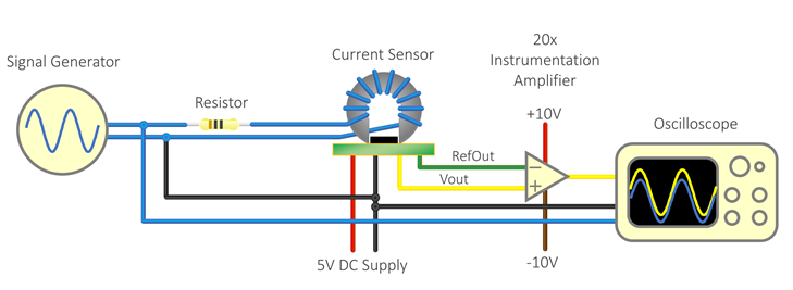

The output is about 3.9mV RMS which corresponds to a sensitivity of 39 volts per amp. So, compared with the 100Hz 1mA RMS traces earlier, this result shows that the frequency response is fairly flat to at least 10kHz. These measurements were not precise, these are just quick measurements to characterize the behaviour slightly.
Building an Amplifier
By now it was clear that the output benefits from an amplifier to make best use of it. I used an Analog Devices AD8226AD8226, assembled into a 20x gain instrumentation amplifier on a breadboard. There isn’t a lot to the circuit (I’ll draw it up if there is interest), but basically it consists of a 2.7k resistor to set the gain, and a couple of 100nF capacitors for supply decoupling. It was powered from +10V/-10V supplies, and the 2.5V reference output from the DRV425 board was used as the offset input to the amplifier. Some trimming would be useful to completely null out the 2.5V offset, but it was mostly nulled out, enough for me to switch to DC on the oscilloscope, for some of the tests below. For a real design the frequency response of the amplifier should be confirmed to be flat; I didn’t characterise it since it was just a quick hack on a plastic breadboard, and I could always circle back if I saw any anomaly in the subsequent tests.
Tests with the Amplifier
The diagram here shows the test topology:
10kHz, 100uA RMS Input Current
With the amplifier connected, the output was clearer and of course larger. I was no longer in the noise with the oscilloscope gain having to be set at max. I use a 1kohm resistor for this test.
The voltage across the 1kohm resistor is about 100mV RMS according to the blue measurement on the oscilloscope, so that corresponds to 100uA RMS input current. The yellow output is about 81mV RMS which means the sensitivity with the amplifier is 800 volts per amp.
With averaging turned on, the trace was again cleaner as expected:
