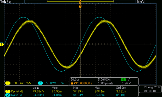

10kHz, 100uA RMS Input Current
With the amplifier connected, the output was clearer and of course larger. I was no longer in the noise with the oscilloscope gain having to be set at max. I use a 1kohm resistor for this test.
The voltage across the 1kohm resistor is about 100mV RMS according to the blue measurement on the oscilloscope, so that corresponds to 100uA RMS input current. The yellow output is about 81mV RMS which means the sensitivity with the amplifier is 800 volts per amp.
With averaging turned on, the trace was again cleaner as expected:
