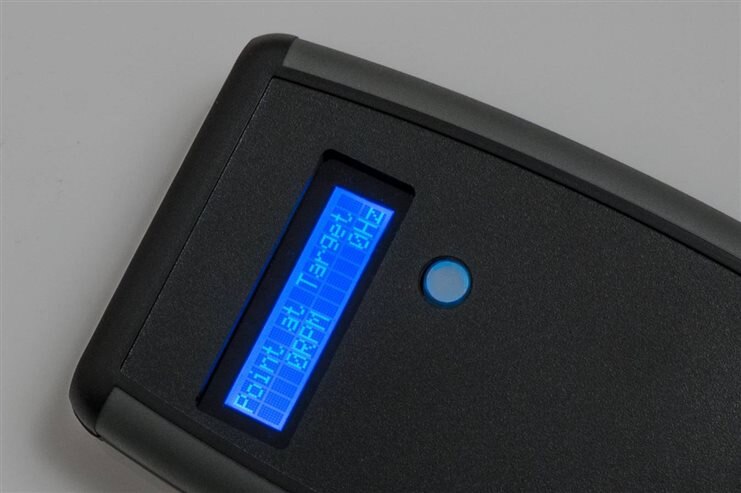

This project is to build a handheld test tool, to measure how fast things are turning. It could have uses in vehicle diagnostics, or for checking how fast a drill is spinning. It could also be used in math/physics experiments to see how fast wheels or other parts are revolving. Basically if any machine is spinning you can measure its rotational speed in revolutions per minute (RPM) or revolutions per second (Hz).
The short (60 second) video here shows it in action:
It is low-cost (<$25) and easy-to-build, so it could be ideal as a beginner 'learning electronics/learning to solder' project. All parts and details are published in this blog post.
How does it work?
The principle is really simple; an infrared LED shines light on the target object. Reflections get sensed by a single photodiode 'eye'. Provided there is a reflective portion of the target object and a non-reflective portion (as an example, a piece of white tape could be stuck on a dark colored object, or a piece of black tape on a light colored object) then the reflected light occurs in pulses directly related to the number of revolutions per minute. The pulses are counted by a microcontroller every second and shown on a LCD display.

The project functions to speeds beyond practical limits for rotating objects. To prove this, I pulsed an LED at known frequencies and pointed it at the sensor. It worked to beyond 15,000 pulses per second which is close to 1 million RPM. The entire project fits in a handheld casehandheld case; a window will need to be cut for the display, the optical parts and the power switch. Alternatively a 3D printer could be used to create something suitable.
The window was cut to be larger than the text display area, so that the text would be visible from an angle too.
The window was fitted with a neutral density filter. This was glued on the inside of the case. For the push-button, I deliberately drilled a bigger hole so that a plastic cap that I had lying around (it wasn't designed for the specific push-button that I used) could fit. Other cylinder shaped plastic pieces could be used.
It turned out that I didn't need to glue the cap to the push-button; it just sits on top loosely, and is fitted with a lip (I used a grommet) around it so that it won't drop out of the case. Since there is a lot of light bleed from the sides of the LCD, I cut a black piece of card to act as a surround and lightly glued it down (I used 'glue dots' so that it can be easily removed if necessary).
Here are some final photos of the assembled device:
