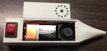

I work with small thermocouples and Hot-Wire/Hot-Film devices in my lab.  To test and calibrate these devices requires some crazy equipment sometimes.
Try to imagine blowing air on a thermocouple that's in a chain of thermocouples 1mm apart without disturbing the ones on either side.
Hot-films are very sensitive to the air flow direction, and it's difficult to move a big fan around keeping the air flow at accurate angles.
So, after trying straws taped to little fans and other sometimes successful ideas, I designed a small hand-held air jet for this purpose.
The case was designed using AutoCAD, and printed on a SeeMeCNC H2 Delta 3D printer.
I designed it to use a small 30mm fan , and power it with a 9V battery.
Here's the finished unit:
Here's a video of the jet in operation with a hot-film.

    I have an extra 0.3mm 3d printer nozzle I was thinking about adding to the end to make it more precise.
    I also have some small tabletop camera tripods that could be used as a holder.

    That's really neat. Simple, yet does just exactly what you want it to and solves a problem for you.
    Nice case - 3D printers are really in their element doing prototypes that are only one step removed from a production injection moulding.
    I find myself toying with the idea of adding extendable and fold-out legs to it, so that it could be set into position without having to be held. Would be a bit complicated to do with 3-D printing I imagine.
