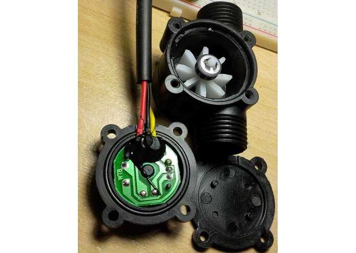

    I've created and implemented a Smart Shower project. It monitors water consumption and its temperature. I've hacked a cheap water flow sensor (Water control DN15 1-30L/min M100) by adding a temperature sensor.
    One of the challenges I've run into during operations is the need to regularly recharge batteries. It will be great if there is a way to easy harvest energy from running water in the shower, so it can charge the batteries. It will be great if I can hack water flow sensor turbine into harvesting energy as well.
    Do you have any ideas if there are any energy harvesting components available on the market to improve my Smart Shower? Your ideas and suggestions are always welcome!

    This is an example of a potential source of power for charging your Smart Shower project's battery:
    https://www.amazon.com/Beduan-Turbine-Generator-Hydroelectric-Changeing/dp/B07PHR4K9Z/ref=asc_df_B07PHR4K9Z/?tag=hyprod-…
    This looks very similar to the housing that you are currently using.  This could be place inline to your current sensor to generate energy to charge your battery.  I guess that there might even be a way to combine the two items, and use the generator to measure your water flow, while it generates the energy to charge your battery (or even a super capacitor).

    Thank you! It seems a viable option. I'll need to research how it can be connected to charge 18650 Li-ion battery and count water flow at the same time.

    I haven't measured the current draw. But it changes depending on the state of controller - deep sleep->active with radio off->active with radio on.
    Currently I'm using MCU ESP-12 with water flow sensor YF-S201 and ds18b20 as a temperature sensor. The MCU wakes up every minute, switches on sensors, if no flow detected after 5 seconds it goes back to sleep, otherwise it start measuring the water flow and turns on radio every 30 seconds to relay data. I believe it takes quite a lot of energy to turn MCU and initialize it. Radio uses a lot of energy too, but it is quite rare event compare to checking for water flow.
    It will be a huge improvement in energy consumption if MCU can be turned on by the generator.I'll need to add some additional elements so. I think switch to EFM32 Gecko may help by reducing energy use and simplify harvesting energy from a turbine.
