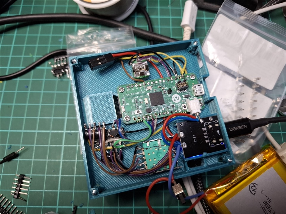

With the proof of concept working on the bench, it was time to think about proper integration in a nice looking “toy”.
Powering the toy
The MAX32666FTHR board features a battery management IC and a 3.3V step down converter to properly power the MCU, while the LED array, on the other hand, requires 5V, which meant using a level shifter for communication, as can be seen on the already published video.
I could have decided to require a USB cable to be always connected as a power source, but this somehow felt wrong with the charger IC available on the board itself.
I thought about using a step-up module to go from the generated 3.3V to the required 5V, but this was quickly dismissed as the current requirement for LEDs is simply too high for the step-up module present on the board.
The decision was then taken to add a dedicated “battery management / +5V@2A charger and step-up” module, based on the FM5324 chipset as found on a well-known Chinese marketplace. In order to still power the MAX32666FTHR board, it was necessary to plug the battery on both boards, which led to some interrogations on my side.
After careful experimentation, it was seen as safe to do so, which also meant that the board would consume power from the battery all the time, severely impacting its lifetime.
I did not consider using sleep mode for the MCU as the LED panel has no such feature and so resorted to the good old “mechanical power switch” on the positive battery lead.
The FM5324 datasheet suggests that the +5V output will be probed regularly for current consumption and will be turned on if there are at least 80mA drawn permanently. Sadly, putting a 47ohms resistor across the output did not turn on the step-up output automatically, so I had to add a switch to the TAPW pin and use it to “force” the +5V output start up.
With a top current consumption of nearly 2A when the display is fully white, I chose to use a 5000mAh battery so that I didn't have to charge the toy too often. A smaller battery would obviously mean a slimmer toy, but I believe there is a nice feeling of having a sturdy object in hand.

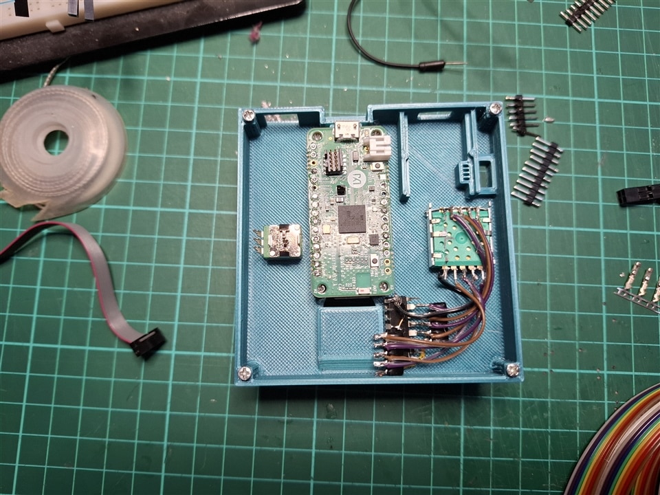

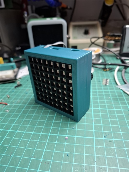

The case
A ready-made case bought “off the shelf” was so unlikely to be found for such a mix of unrelated components that I once again fired up FreeCAD to design my own. This also allows me to see if everything fits beforehand, with the ability to 3D print again a modified version if need be.
To make sure movements are well perceived, I decided to place the BMI160 right in the middle of the case, meaning that the MAX32666FTHR board was off center and very “high” when considered with the display in front of it. And because this is also a development in progress, I wanted most things to still be accessible, which explains the slope to access the SD card, the cutouts for the two USB ports and a hole for the debug connector to fit through.
Here is a video rendition of the various elements and their various positions:
The printed parts are the back, the front, and a reflector that serves two purposes:
  1. make sure the light from adjacent LEDs do not “pollute” each other
  2. be an anchor point between the panel and the front case.

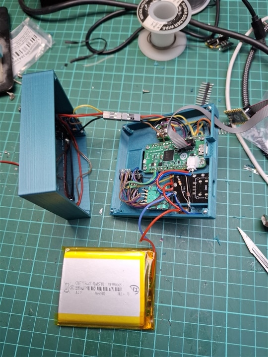

After a couple hours print, here are photos taken during assembly:
image image image image
As you can see, there is no PCB for the 74HC148, the pins are bent flat, the resistor arrays are directly soldered to the pins and the connections are done directly with wrapping wire. This may not be the cleanest design, but it meant faster turn time and I also like the "high frequency circuit" feeling it gives to it.
What you don’t see here is that the screws holding everything in place were scavenged over the years on electronic toys or devices that died on me. Some were “self-tapping” but as it turns out, the PLA used for the cases did not like much the procedure, being on the brink of cracking on my first try.
As a result, I decided to self-tap for two or three millimeters, set the soldering iron to 180°C, place its tip inside the middle of the cross imprint on the screw head and apply light pressure until the temperature propagates just enough in the metal to get the PLA to slightly melt. Once the screw is in place, I quickly remove the soldering iron and let everything cool down.
Maybe it would have been better to use the “hot air” end of a soldering station on a low temperature setting to melt the PLA while tapping the screw, but I don’t have such an equipment, so I had to find another method.

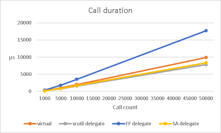

With an empty “loop” function, the difference in call duration is only due to the invocation method and so we should be able to compare those options.
But because the “Boost” one uses the standard Boost library that has not been ported to MSDK, it was immediately ruled out of the competition.
The remaining methods were tested and compared to give this outcome:
Clearly, FF is not up to the task in our environment, but SA and SRUtil are giving a 15% and 20% average improvement over “virtual” respectively.
With all this figured out, I decided to use the SRUtil delegate and moved on creating the following activities for the toy.

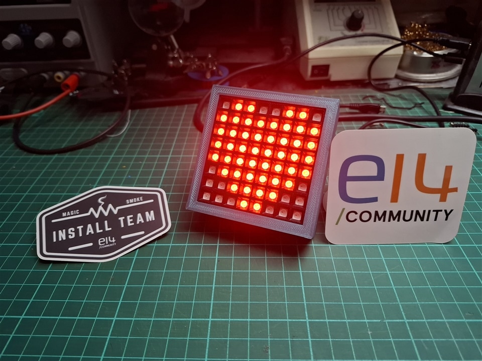

Dice
Shake the toy and you get a number between 1 and 6 displayed, like a regular 6-sided dice. This required me adding the “significant motion” detection support code in the BMI160-Arduino library.
There are various ways to generate a random number, the usual one being to use a Pseudo Random Number Generator (PRNG) like the Mersenne Twister. As the name implies, the number is not really random but it’s usually acceptable for a toy usage.
However, the MAX32666 embeds a True Random Number Generator that I believe uses a “white noise” entropy source to get a truly non-repeatable sequence of bits.
Just for the beauty of it, I thus decided to use the TRNG and I could have read a single 32bits value and find out which 5bit nibble has the highest value, but this leaves 2 bits out, effectively increasing the risk of getting a tie.
So in the end, I read it six 32bit values in a row and use the highest read value index as the dice throw result. The probability of getting a tie is extremely small, but the code caters for it just in case.
The video below also shows dynamic brightness adjustment.
