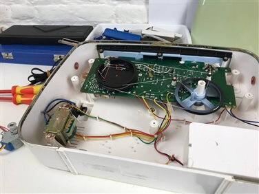

The original tuner and knob are solely mechanics – a very appreciable engineered solution – and I tried doing the same: a new mechanic solution improving the manual tuner automating the mechanism with a stepper motor. The first step is making space inside the front part of the case. While I avoid as much as possible any external alteration of the form-factor of the device keeping almost intact its functionalities, I can remove and modify the internal parts adapting to the new design: it is an upcycling, or – more precisely – a hardware hacking, so why not?

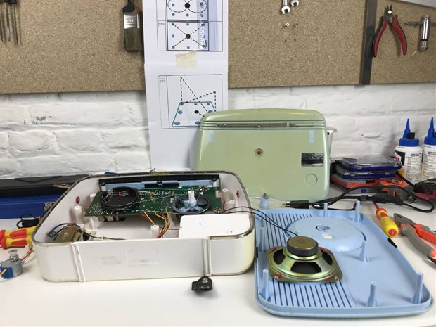

Above: the front-side of the radio disassembled. On the right, the big speaker screwed to the front cover; removing this part I can get a lot of extra space inside the case.
Planning to use only the external audio output (the earphones jack) I decided to exclude the main audio circuit and removing the internal speaker, freeing a lot of space in the case. Then, I need to hack the tuner.
Above: the new version of the tuner should be controlled by a stepper motor; checking for the reuse of the space inside to see how to fit the two components: the motor and the stepper controller.

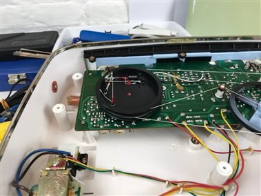

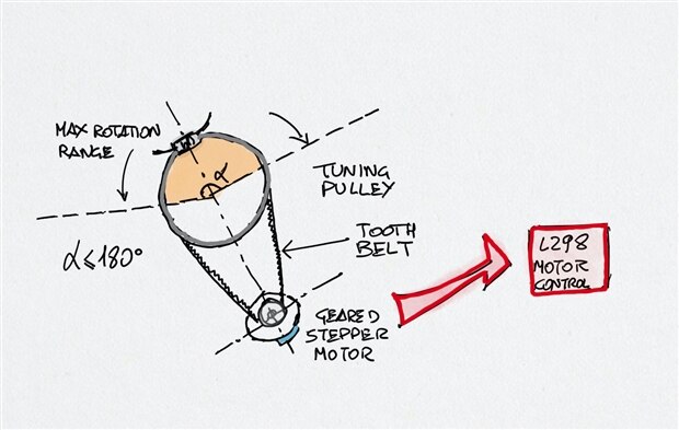

The non-conductive wires that move the tuner capacitor through the big tuning knob have a reduction between the two connected pulleys; several full rotations of the big knob cover the entire frequency range while the tuner only rotates (very slow) of a few less than180 Deg. The idea is to rotate the tuner with a stepper motor, ideal for very small rotation increments, converting the knob becoming a passive indicator showing approximately the corresponding frequency instead of the active tool to find the radio station. The below scheme shows the design of the automation.

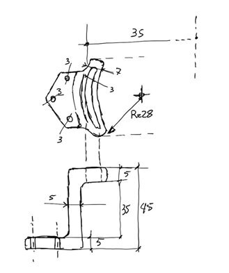

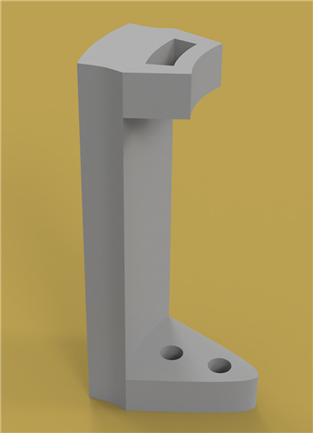

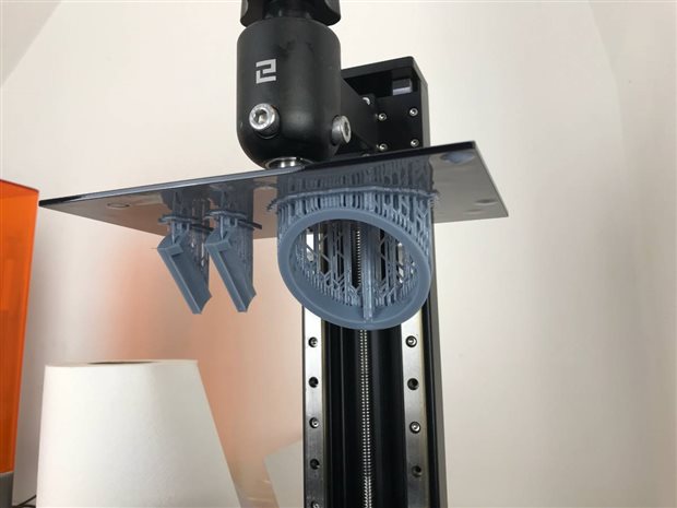

After removing the internal speaker I checked for the available space and designed with Fusion360 two parts:

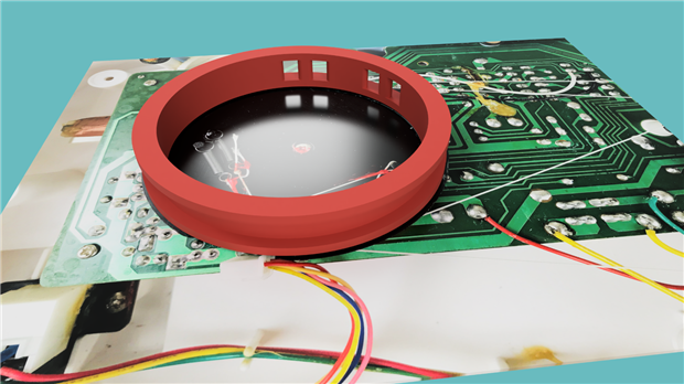

  • A ring pulley 6 mm height of the same diameter of the tuner capacitor pulley to glue on top of it
  • The support for a small stepper motor (I have used a 28BYJ-48 5V geared stepper motor)
Above: the drafted idea of the stepper support (need two).
Below: The 3D rendering of the support, ready for printing

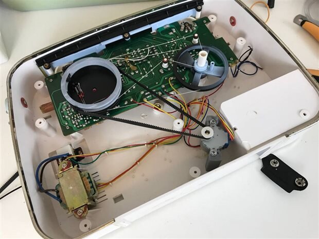

On the geared stepper motor I fixed a 20-teeth pulley to drive a 6 mm tooth-belt. As the tuner doesn't cover a full rotation it was sufficient to fix the belt to the tuner pulley in a proper position, as shown in the image gallery below.
{gallery} Radio Tuner
Simulated 3D rendering of the tuner pulley
The pulley and the stepper supports finished to print with the LCD Elegoo Saturn 3D printer
The final assembly of the digital tuner driver

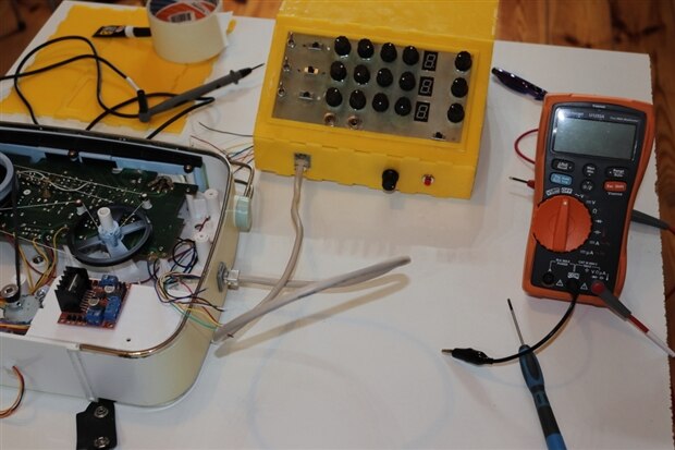

Searching for a good way to connect the radio to the synth platform that includes the microcontroller to manage the stepper motor logic I decided to use what I found as the less impacting solution in cases like this: an RJ45 connector. As a matter of fact, to power and control the stepper motor, using a half-bridge L298 motor controller, only six wires are needed; the eight wires of the RJ 45 network cable is more than sufficient. The images below show the RJ45 connector tested with a common network patch.

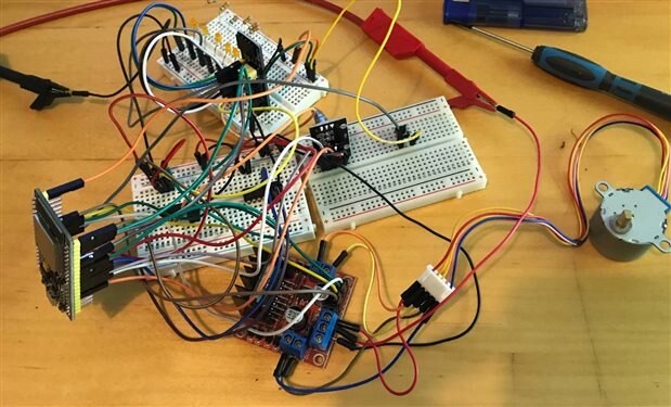

The synthesizer platform (the whole project integrating the radio), has been designed with analog components but most of its features are controlled digitally. To control the radio tuner with a knob on the control panel of the synth I planned to use a rotary encoder (with button) to move the stepper motor accordingly.
Above: the breadboarded prototype of the circuit to control all the components.
Fast, powerful, with a lot of memory and many onboard features – including the Wifi – I figured out the ESP-32 Node MCU a very good solution. One of the most interesting features of the hacked radio and synth I am building is the possibility to control the device locally through the control panel, as well as remotely from the web with some Restful APIs calls.
