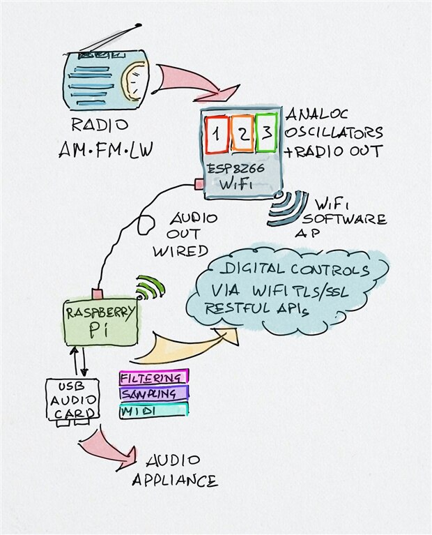

The illustration above shows the schematic setup I expect at the end. There are two aspects that addressed me to this solution design; the first is the needing for a cable connection between the sound sources to grant the best audio quality. The second is the possibility to connect the Raspberry Pi (the digital endpoint) to the analog panel most of whose behaviors are controlled digitally without too much wiring.

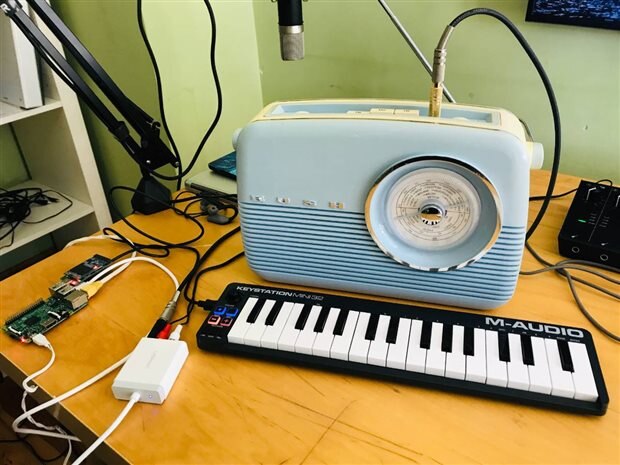

The above image shows the first test setup to verify the feasibility of the idea. I have used the Bush FM radio (not yet hacked inside, only cleaned and restored to full working) as the audio input.

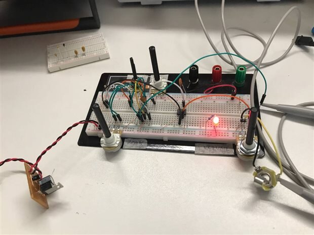

Another preliminary investigation I have done is on how to make a simple analog synthesizer. I have tried to find an easy solution and at last, I focused the choice on using the old-school NE555 as the main oscillator. To be honest, I have also another alternative, using a series of CEM IC I own with more sound generation capabilities. The problem is that CEMs are analogic synthesis ICs that need a control voltage in the range -12 - +12 V so I kept them for another project I have in mind. It is true that a single NE555 oscillator is poor stuff to make music but if we make a module with two oscillators that interact, one in astable configuration and the other acting as a PWM on the waveform generated by the first the game changes a bit. Further sophistication can be added using different capacitors to change the range of the audible frequencies generated depending on their value. Then, instead of using a single module, I will replicate the same circuit to three different waveforms that can be generated at the same time with the parameters regulated independently all going to a single output signal. I got inspirations joining together information and knowledge (also from some of my past lives when the NE555 was popular in any DIY circuit) making a very primitive prototype to experiment the possibilities.

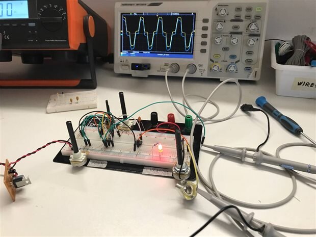

To complete the vintage design I have used a 5V old-style voltage regulator based on LM7805. As shown in the above image, the first result was really depressing. Both output signals of the module was producing always the same waveform. Not only identical on both the oscillator and PWM output of the second NE555 but always identical, I mean. No matter what changes on the controls like in the two screenshots below. The biggest delusion is that I got no sound on the output.
First I tried to see if my living bible Jan Cumps was having some idea; we tried to see if the values of the discrete components were wrong, maybe the potentiometers, etc., always with the same result, no sound, just changing the shave of the two, always identical, waveform. Then, after another night chatting with a friend in Italy studying the datasheet (I never experienced a so stupid and blocking issue with this IC) and making changes I finally discovered that in my original design I totally forgot to connect the trigger pin 2 of the NE555 to the pin 6 (trigger). Added two wires the board worked like a charm.
The two screenshot above show the kind of waveform I was expecting when the two oscillators interact together.
Above: the two-NE555 module assembled on a breadboard for testing.
