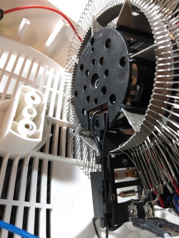

I recently purchased a 2kW electric fan heater for $12 (it was on sale). This was an offer too good to refuse, especially as the latest Project14 competition is hardware hacking.
These fan heaters, like any other personal heater, are great for the winter months.
However, as I have on the very odd occasion left an oil heater on over night (it is very easily done), I certainly wouldn't want to do the same with an electric fan heater.
So I want to add in some "smarts" or electronics to ensure that it can automatically turn off if I leave the room etc. and it would also be handy to remotely adjust heat and fan speed.

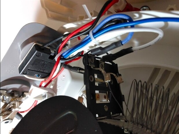

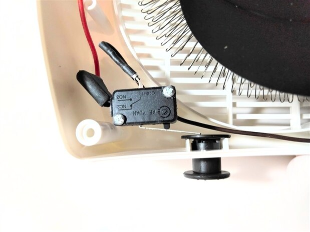

The nice thing about this particular fan heater is that it has a safety cut off switch, should it tip over. I thought that this would be my starting point for my project, as this part can be readily enhanced.
The part I am struggling with is how to or what electronic options could I use to hack the heater settings switch, which is mechanical. How could I do this electronically, bearing in mind we are dealing with mains voltage.
{gallery:autoplay=false} Heater Settings Switch

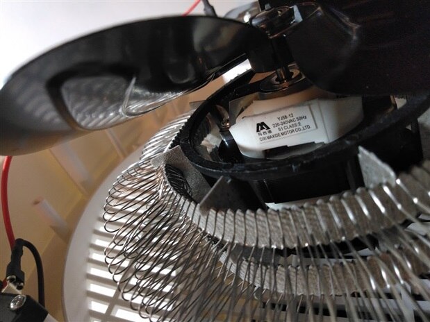

And the other question is what options are out there on how to hack the fan speed controller... this also is mains voltage, so I'm out of my depth in terms of using a digital potentiometer, for example.
Any suggestions / ideas would be greatly appreciated.

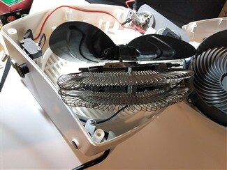

  • BigG
    BigG over 6 years ago in reply to shabaz +1
    I am still unpacking and tearing it down myself to understand the wiring and the rest. I've yet to sketch out a wiring diagram and it's quite hard to capture the key elements in photos. It looks like two…
    shabaz over 6 years ago in reply to BigG +1
    Hi Colin, I was looking at your photos earlier, and think that's a bimetallic strip (it bends when it gets hot, and self-disconnects). the rotary control just adjusts the point it occurs by moving it closer…

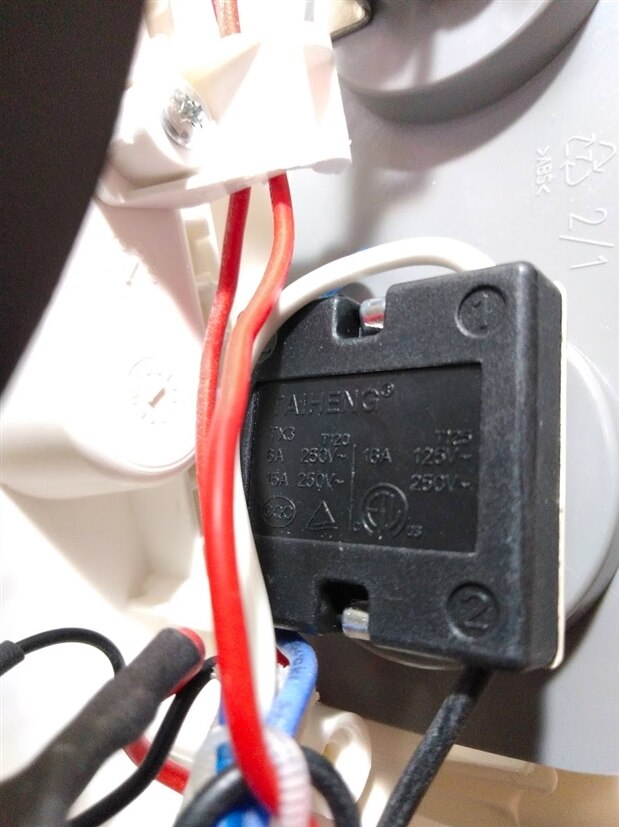

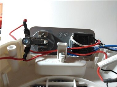

    I'm assuming the switch on the heater is a 4-way 2 pole switch, similar to this more robust version: https://uk.farnell.com/schneider-electric/k1f013qch/rotary-switch-2-pole-5-6a-230v/dp/3108333
    As such, I started looking at 4 way double pole power relays and I found that there are a few options available, such as this one:
    https://uk.farnell.com/schneider-electric/rxm4ab2jd/relay-4pdt-250vac-6a/dp/2056435
    Looking at the photo of the fan switch, it looks like there are two ratings one at 6A and the other at 15A. Now, if I went for a 4PDT relay rated at 15A, the price shoots up for that rated current and for the price of one 4PDT relay I could buy two fans.
    So I am wondering if I could craft my own hybrid relay circuit using a suitably rated DPDT or SPST power relay, where one is for 15A and the other one is for 6A. This could saves quite a few bob but the circuit wiring will need thought as I wouldn't want a case of two relays turning on at the same time.
    Any suggestions?

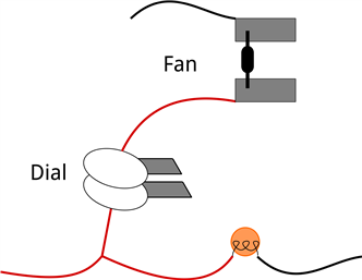

  • BigG
    I've worked out a possible logic table for the fan and the two heater elements.
    So I think 2 x SPST (NO) 16A relays (not sure if this could be combined somehow) and then 1 x SPST(NO) 6A relay would work in this context.
    Would this be correct?
    It's hard to say, I'm not sure I understand the existing wiring unfortunately : (
    It might be two separate elements, but I've never taken apart a modern fan heater.
    Heaters are quite high-power, so might need some care if modifying, since wires could get hot.
    This is quite an advanced mod, not sure how it will be implemented, will the relays and circuitry be installed inside the heater? It could he hard to install everything in there.
    It could be way easier to use a remote controlled mains socket adapter, but it may take some of the fun out of the project too, if the aim was to modify the heater product itself.
    So, not really sure what to suggest : (
  • BigG
    It looks like two separate elements to me based on the wiring.
    This is quite an advanced mod, not sure how it will be implemented, will the relays and circuitry be installed inside the heater? It could he hard to install everything in there. Will the relays and circuitry be installed inside the heater?
    No the idea is to remove this top covering and then have the control hardware outside of the enclosure. Not sure just yet as to where to place. As you say, the wires can get quite hot.
    It's actually quite neatly designed, in my opinion.
    {gallery:autoplay=false} Motor

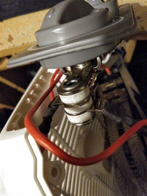

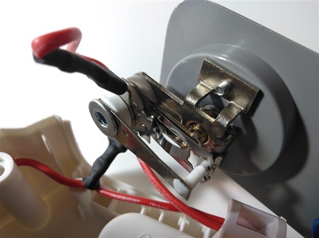

    The part that has me perplexed is the mechanism behind the dial:
    What is this component called and how does it work. It looks to me like a beefy potentiometer with an on-off switching mechanism, but not sure has cannot confirm via google (and how did I survive before googling).
    Hi Colin,
    I was looking at your photos earlier, and think that's a bimetallic strip (it bends when it gets hot, and self-disconnects). the rotary control just adjusts the point it occurs by moving it closer or further away by a fraction.
    These were popular in older thermostats (nowadays it will be a semiconductor or perhaps a thermistor, and an electronic circuit, but the older (but quite reliable) designs had the bimetallic strip.
  • ralphjy

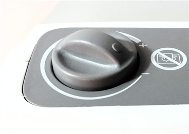

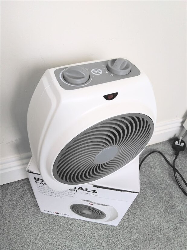

    Also meant to ask - what is the meaning of the symbol in the picture?
  • BigG
    BigG over 6 years ago in reply to ralphjy
    Thanks. Yes, not sure how far I'll get by July 14 for the Project 14 hardware hacking deadline as this project requires a cautious "spark free" approach. I believe that symbol indicates that you should not hang clothes over the fan heater.
