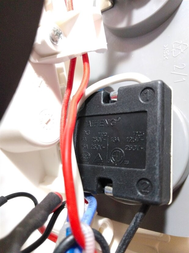

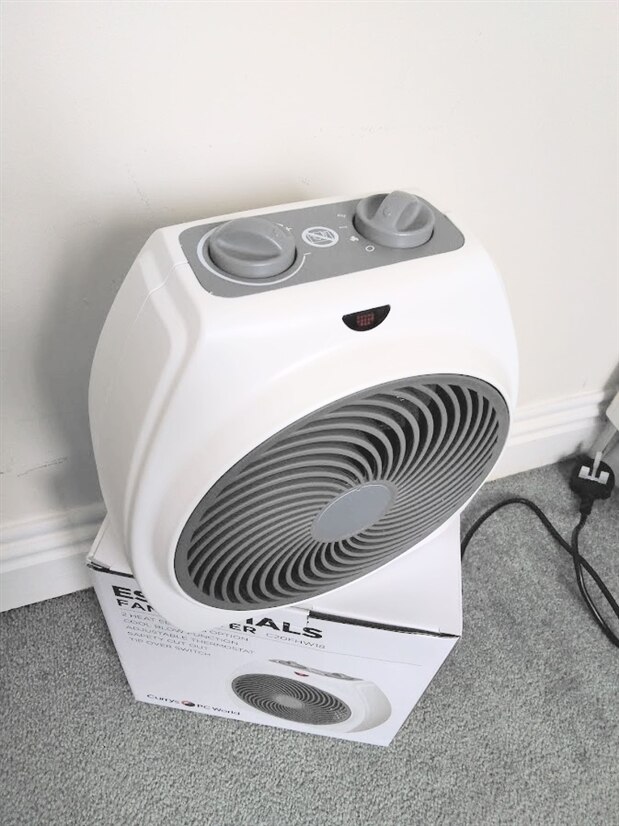

I recently purchased a 2kW electric fan heater for $12 (it was on sale). This was an offer too good to refuse, especially as the latest Project14 competition is hardware hacking.
These fan heaters, like any other personal heater, are great for the winter months.
However, as I have on the very odd occasion left an oil heater on over night (it is very easily done), I certainly wouldn't want to do the same with an electric fan heater.
So I want to add in some "smarts" or electronics to ensure that it can automatically turn off if I leave the room etc. and it would also be handy to remotely adjust heat and fan speed.
The nice thing about this particular fan heater is that it has a safety cut off switch, should it tip over. I thought that this would be my starting point for my project, as this part can be readily enhanced.
The part I am struggling with is how to or what electronic options could I use to hack the heater settings switch, which is mechanical. How could I do this electronically, bearing in mind we are dealing with mains voltage.
{gallery:autoplay=false} Heater Settings Switch
And the other question is what options are out there on how to hack the fan speed controller... this also is mains voltage, so I'm out of my depth in terms of using a digital potentiometer, for example.
Any suggestions / ideas would be greatly appreciated.

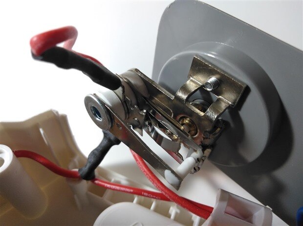

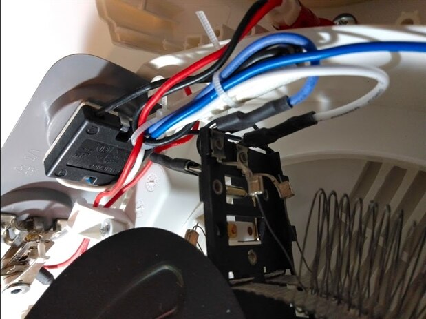

    I am still unpacking and tearing it down myself to understand the wiring and the rest. I've yet to sketch out a wiring diagram and it's quite hard to capture the key elements in photos. It looks like two…
    shabaz over 6 years ago in reply to BigG +1
    Hi Colin, I was looking at your photos earlier, and think that's a bimetallic strip (it bends when it gets hot, and self-disconnects). the rotary control just adjusts the point it occurs by moving it closer…

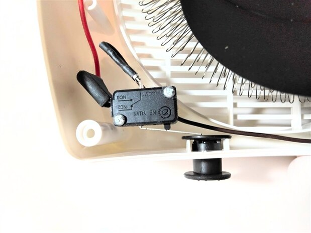

    Yes, I'm exploring triacs! Thankfully, I've ticked that off the list - i.e. know your power ratings etc. So I basically just want to use one triac for now to remotely turn the device on and off. I decided to place the triac above the microswitch as shown (will be snipping that red wire).
    That's the plan anyway. I'm working through element14 as there are plenty links on triacs.
    Now when looking at my design process, I've zoomed straight onto snubber capacitors (I have a habit of doing that... zoning in on something that's probably not necessary but just want to understand).
    And, while searching online I came across these guys. They are reasonable price wise but are they appropriate... and if so, how do you choose.
    http://www.capacitorguide.com/mica-capacitor/
    Not sure what other bells and whistles are needed to look after the triac and the circuit for switching high loads. I'm basing my max load off 24A RMS (to cover the 6A + 16A).

    Triac circuits are not safe to build without a dedicated PCB. SSRs are not cheap (there are low-cost ones but some can burst into flames). Both of these options need heat-sinking too, and you don't have anywhere for that - and it's another problem you're creating for yourself to do that externally and then having to worry about earthing any exposed metal or screws.
    If you're ok with just switching the individual elements and fan off and on and don't want to try to control the amount of power more granularly than that, then relays might be the easiest option, for instance one relay per element, and one to control the fan. It won't need 24A capability, because the max will be 13A (UK mains).
    This finder relayfinder relay seems nice - it has spade connections which will be less awkward than PCB pins, and far easier to crimp on the connections although there will be effort to design and make up your wiring harness. It's a reliable brand too. I used a different relay in their range to power on/off a waste disposal unit (maybe 500W motor) and it's been functioning for 12 years like clockwork.
    I hate to say it, but personally I wouldn't hack this project, due to the cost and complexity to keep it safe. I don't want to be negative : ( but equally don't want to be too positive to mistakenly give you give the impression that it's something moderately achievable either, and then struggle with it. Hope you understand..
