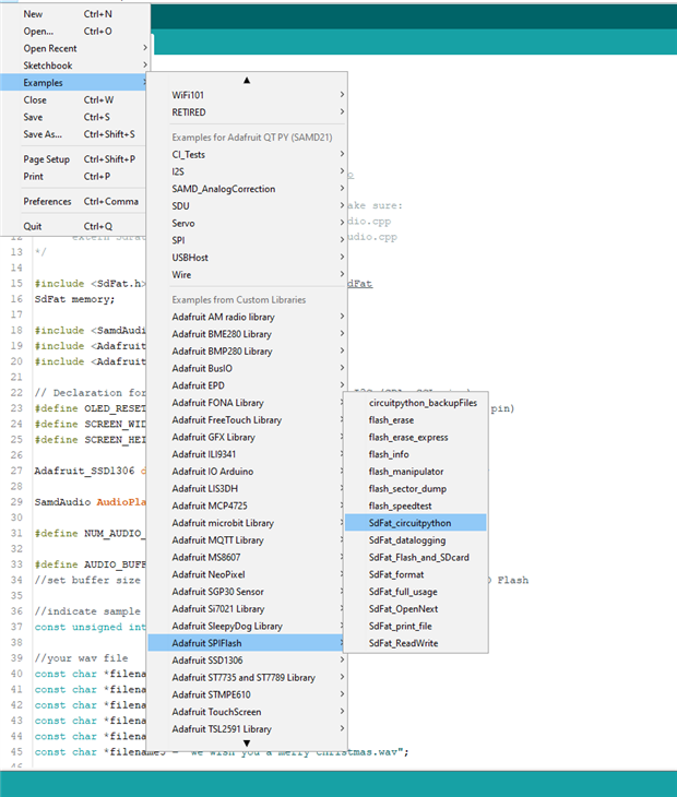

The fatfs library setup that is used with the Arduino IDE is not compatible with CircuitPython, so a different library setup is required to be able access files that are transferred with CircuitPython.  Adafruit has provided a CircuitPython example of the fatfs library to use with the Arduino IDE.   After you include the Adafruit SPIFlash library the example is available - SdFat_circuitpython.

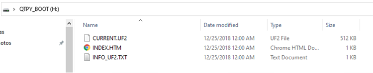

The current version of the bootloader creates a drive instance that you can use to upload programs simply by dragging and dropping the uf2 file onto the drive instance (this works for any uf2, not just CircuitPython).
If you aren't in bootloader mode, you can enter it by doing a quick double press of the reset button on the QT Py.
Here is what the drive looks like in bootloader mode:
If you want to save the current firmware that is programmed you can just copy the CURRENT.UF2 file.  This allows you to reload that firmware easily after using CircuitPython (this is the internal flash, not the external one).

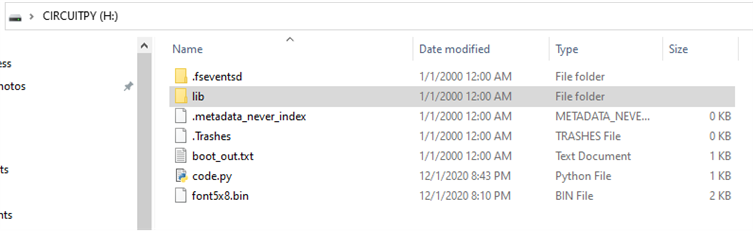

Transfer files to external flash

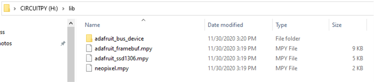

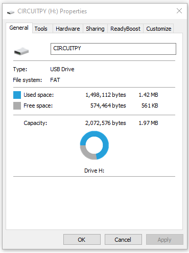

When CircuitPython runs it will present the external flash as a drive that you can drag and drop files to and from the host computer.
Here is what my drive looks like: (I have files there from using CircuitPython previously programming the OLED display)

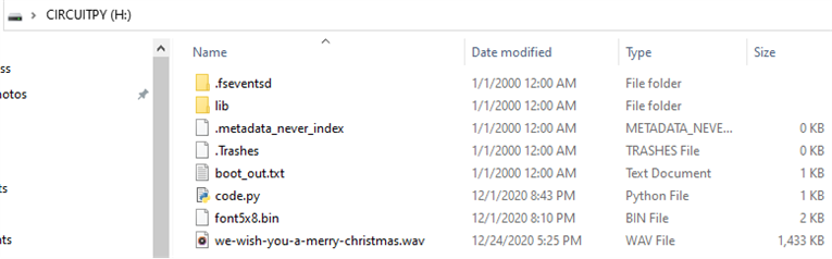

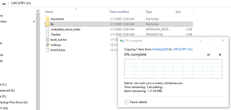

     So, I proceeded to drag and drop the WAV file onto the drive and the transfer started.  Not having done this with a "large" file before I wasn't sure how long it would take.  The copy window popped up immediately.
     After about 5 minutes of the status not changing, I was worried; after 10 minutes really worried.  I guess using this method that this status window stays at 0% until it's done.  After about 15 minutes it finished.

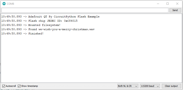

     Verify Arduino program can find the file
     QT_Py_SdFat_circuitpython.ino    derived from SdFat_circuitpython.ino example

     Program output on Serial Monitor:
Almost done.  I'll do a final post with a demo when everything is integrated and working.
