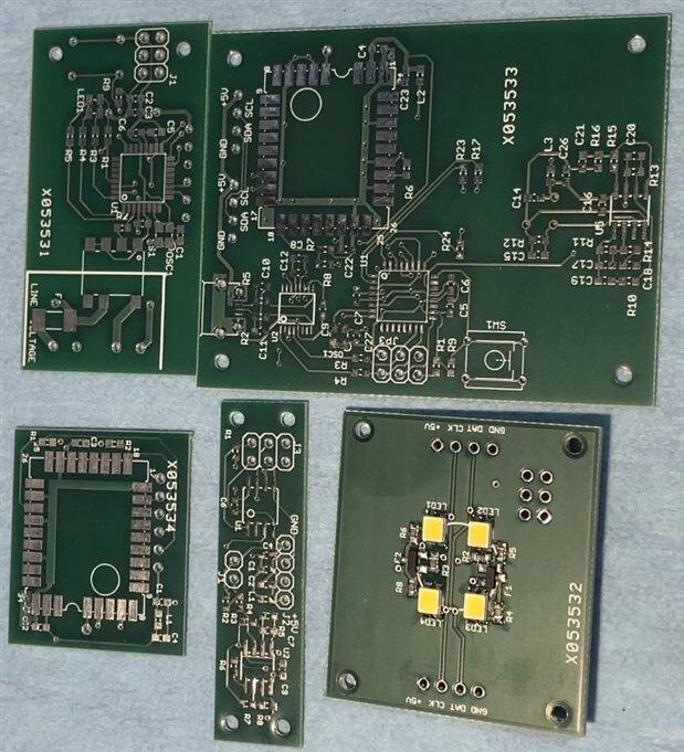

The new PCBs have arrived and I could not wait to try out my new LED board (I soldered up the 10 new LEDs boards last night and earlier to day, so I had no blank boards left for the picture)!  Five new shiny PCB types to play with (from the upper left corner, clockwise, we have the following:
Load controller, Master controller/PIR, 4-LED driver, Light Sensor and EnOcean Transceiver board to support the load controller).

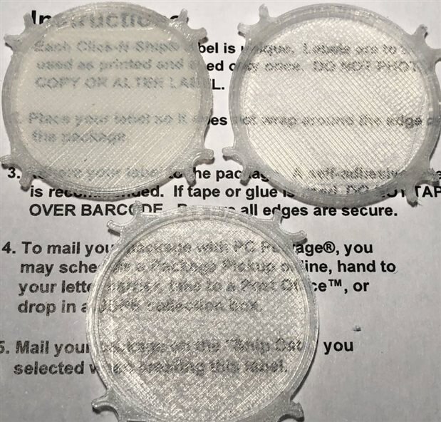

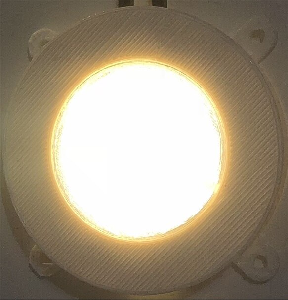

I was excited to try out the new 4-LED design to test out my other recent changes.  I have been working on improving the light output of the current design, attempting to further reduce the losses of the light cover/lens.  To that end, I have redesigned the cover/lens to thin it out further.  Additionally, I have added a little texture (semi-prismatic) to diffuse the light a bit. Starting in the upper left hand corner and moving clockwise, we have the earlier cover/lens, a thinned version of the cover/lens and a thinned and textured version of the cover/lens.  All three of these cover/lenses were printed with the same clear PLA filament.  The earlier version shows some yellowing of the background and a resulting attenuation of the lighting (approximately 1168 Lux @ 10").  The thinned out cover/lens yielded a higher light output (approximately 1295 Lux @ 10").  And the latest version, with the additions of a light prismatic texture, yielded a slight improvement (approximately 1348 Lux @ 10").  This was all welcomed improvements in light output, but I still wanted to to see where this would go with the new LED board.  Well, I just added connectors to one of my new boards and did a little testing.  The new LED board, with the new thinned and textured cover/lens produced a light output of 1715 Lux @ 10".  This an improvement of ~269% over the existing lighting.  Not to bad for a couple of weeks work.

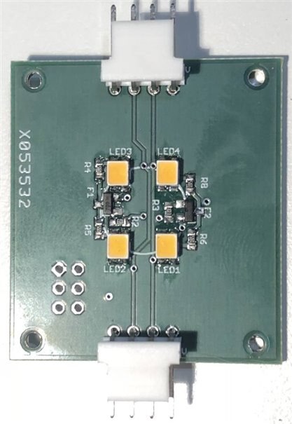

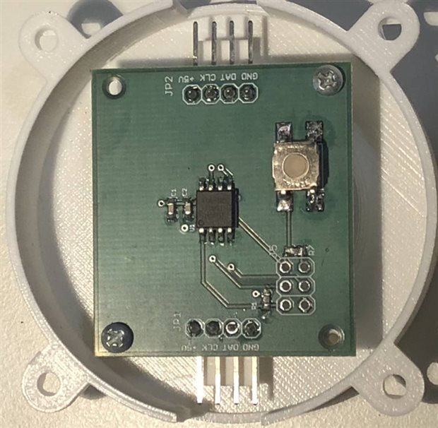

The new Light Pucks are coming along nicely.  Below are the new PCB (top and bottom) and the fully assembled light puck turned on and shining brightly.
