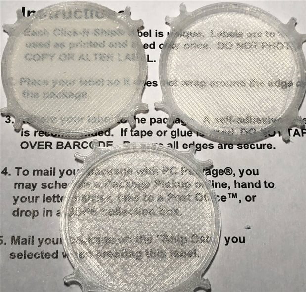

I was excited to try out the new 4-LED design to test out my other recent changes.  I have been working on improving the light output of the current design, attempting to further reduce the losses of the light cover/lens.  To that end, I have redesigned the cover/lens to thin it out further.  Additionally, I have added a little texture (semi-prismatic) to diffuse the light a bit. Starting in the upper left hand corner and moving clockwise, we have the earlier cover/lens, a thinned version of the cover/lens and a thinned and textured version of the cover/lens.  All three of these cover/lenses were printed with the same clear PLA filament.  The earlier version shows some yellowing of the background and a resulting attenuation of the lighting (approximately 1168 Lux @ 10").  The thinned out cover/lens yielded a higher light output (approximately 1295 Lux @ 10").  And the latest version, with the additions of a light prismatic texture, yielded a slight improvement (approximately 1348 Lux @ 10").  This was all welcomed improvements in light output, but I still wanted to to see where this would go with the new LED board.  Well, I just added connectors to one of my new boards and did a little testing.  The new LED board, with the new thinned and textured cover/lens produced a light output of 1715 Lux @ 10".  This an improvement of ~269% over the existing lighting.  Not to bad for a couple of weeks work.

I still have a lot to do, assembling the new PCBs and then writing a bunch of firmware.  This has been an exciting journey up to this point, but it feels like it is going to get crazy soon.  In addition to this project, I have another exciting project getting ready, a new shop.  Since moving to Texas (almost three years ago), I have been without a real shop.  All of my tools have been sharing space in the garage with my wife's car (and almost a ton of pre-mix concrete in sacks), which makes it really difficult to do anything with my tools.  I have a bunch of prep work to do while I am waiting for my final approval from my home owners association.  All that, and my Mom is coming in to town next week to visit with us and her great grandchildren.
