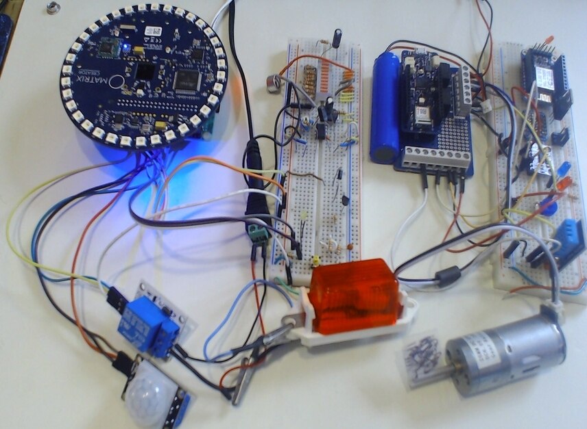

Overview
Although the time has passed to submit to the Home Automation challenge, issues seen previously during the project work have been resolved. In the last post for this project, the GPIO features of the MATRIX Creator were to be shown however there were issues with getting the values consistently from openHAB.  These have since been resolved so now the GPIO ports from P2 on the MATRIX Creator can be used to set and collect port states from the openHAB Basic UI.  The main issue was sending Exec (executable) commands from openHAB to the Python helper script passing multiple parameters. For some reason openHAB would not allow for this, so to resolve the issue, the parameters were packed into a since string to the Python script and then unpacked before sending to the main script to issue commands to MATRIX Creator.   This is the same basic method that was used to send the RGB values from openHAB to the Eveloop LED array on the Creator.  Since this issue was resolved, it is still a valid part of the project and is included, although not expected to be considered as part of the submission.

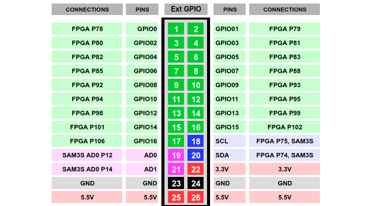

MATRIX Creator GPIO P2 control in openHAB

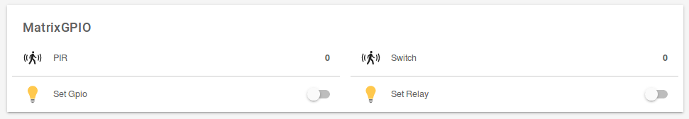

Sitemaps
Sitemaps in openHAB are used to assemble the Items and Things into a structure that can be viewed using the Basic UI, Android openHAB app and other interfaces. This allows the user to interact with the Things using an Switch,  Color or related type or view data in Text type items to display things such as sensor data, environmental values or other related items and things.  The main format structures are the Frame and Label where items can be grouped into a collection of common items.  Here the GPIO Items are collected under the Heading of MatrixGPIO.
GPIO .sitemap definition
Frame label="MatrixGPIO" {
Text item=GetMatrixPIR label="PIR [%s]" icon="motion"
Text item=GetMatrixSwitch label="Switch [%s]" icon="motion"
Switch item=SetMatrixGpio label="Set Gpio" icon="light"
Switch item=SetMatrixRelay label="Set Relay" icon="light"

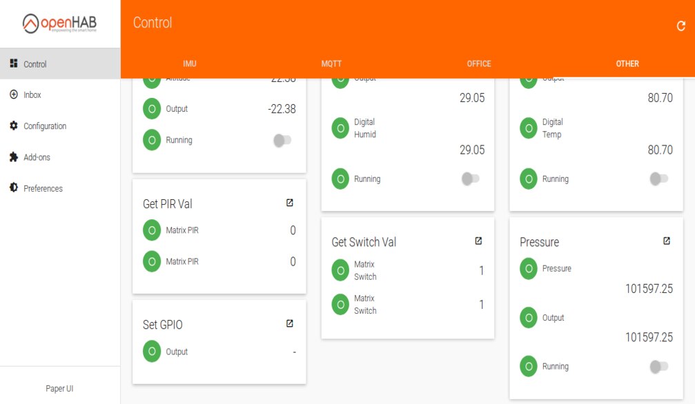

Basic UI view
PAPER UI Control View

Config used
   MATRIX Creator GPIO Port Mapping
GPIO #Device ConnectedFunction
GPIO08RelayOUTPUT
GPIO10PIR SensorINPUT
GPIO14LEDOUTPUT
GPIO15Push ButtonINPUT
MATRIX Creator Expansion GPIO
https://matrix-io.github.io/matrix-documentation/matrix-creator/resources/pinout/
Connection Mess
Video Demo of openHAB control of the MATRIX Creator GPIO
