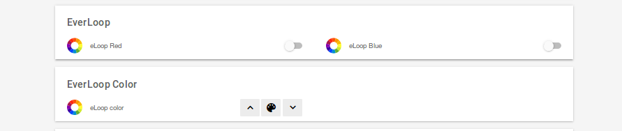

openHAB Items config
Switch SetELoopRed "EverLoop Red" { channel="exec:command:eloop_color_red:online" }
Switch SetELoopBlue "EverLoop Blue" { channel="exec:command:eloop_color_blue:online" }
Color SetELoopColor "EverLoop Color" <slider>
openHAB Sitemap config
Frame label="EverLoop" {
Switch item=SetELoopRed label="eLoop Red" icon="colorpicker"
Switch item=SetELoopBlue label="eLoop Blue" icon="colorpicker"
Frame label="EverLoop Color" {
Colorpicker item=SetELoopColor label="eLoop color" icon="colorpicker"
openHAB Rules

  openHAB Basic UI Everloop Controls
Well, that is about it.    This has been interesting, and as always I wished I had more time to get more done, but I at least I was able to this much configured.   There is still a whole host of things that can be done with this config and I will continue to work with it.  I'd like to thank Tariq and element14 for providing me with the MATRIX Creator and Raspberry Pi 3 A+ for the project.
