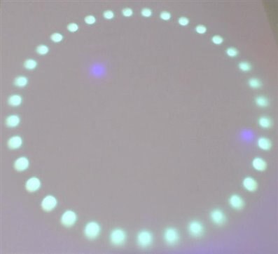

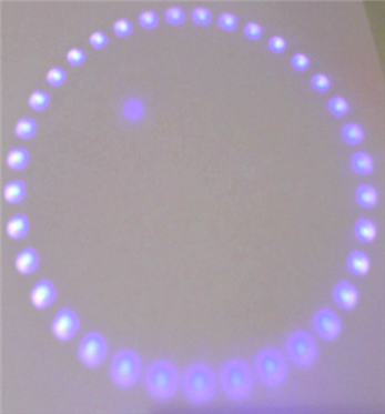

Run the swigExamples.py script to test that the matrix-lite-py has been installed correctly.
NOTE: This does require Python 3.0.
python3 swigExamples.py INFO: [/dev/spidev0.0] was opened
['SwigPyIterator', 'SwigPyIterator_swigregister', '__builtin__', '__builtins__', '__cached__', '__doc__', '__file__', '__loader__', '__name__', '__package__', '__spec__', '_matrix', '_newclass', '_object', '_swig_getattr', '_swig_property', '_swig_repr', '_swig_setattr', '_swig_setattr_nondynamic', 'cvar', 'everloop', 'everloopImage', 'everloopImage_swigregister', 'everloop_swigregister', 'gpio', 'gpio_swigregister', 'humidity', 'humidity_struct', 'humidity_struct_swigregister', 'humidity_swigregister', 'imu', 'imu_struct', 'imu_struct_swigregister', 'imu_swigregister', 'led', 'led_swigregister', 'pressure', 'pressure_struct', 'pressure_struct_swigregister', 'pressure_swigregister', 'uv', 'uv_struct', 'uv_struct_swigregister', 'uv_swigregister']
If successful, the Everloop LEDs should all run Blue.
A piece of paper was used to cover the MATRIX Creator to show the LEDs more clearly.
The swigExamples.py script has code in it run examples for the other sensors but are comment out.  To run these, just comment out the appropriate code to run another example.

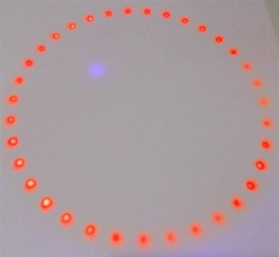

For my project, to get the Sensor values to display in OpenHAB, I took the basic swigExamples.py script and modified it by creating a MatrixSensors class and associated methods for each sensors. Also, I added argparse to the script so that a arguments can be passed to the script to retrieve the sensor values without having to edit the script each time.  A dictionary is used to change the colors on the Everloop based on predefined values.   Eventually this will be modified so the intensity and colors can be adjusted dynamically.
I guess I need to set-up a github repo for this but this is what I have thus far.
#!/usr/bin/env python3
# -*- coding: utf-8 -*-
import sys
import os
import build.matrix as hal
from time import sleep
ledMatrix = {'red': {'ledr' : 1, 'ledg' : 0 , 'ledb' : 0, 'ledw' : 0},
            'green': {'ledr' : 0, 'ledg' : 1 , 'ledb' : 0, 'ledw' : 0},
            'blue': {'ledr' : 0, 'ledg' : 0 , 'ledb' : 1, 'ledw' : 0},
            'white': {'ledr' : 0, 'ledg' : 0 , 'ledb' : 0, 'ledw' : 1},
            'off': {'ledr' : 0, 'ledg' : 0 , 'ledb' : 0, 'ledw' : 0},
# Print exported objects/functions
#print(dir(hal))
class MatrixSensors(object):
    Setup Matrix Sensor  Python examples
    def __init__(self):
        self.leds = []
        self.everloop = hal.everloop()
        self.imu = hal.imu()
        self.gpio = hal.gpio()
        self.uv = hal.uv()
        self.humidity = hal.humidity()
        self.pressure = hal.pressure()
        self.gpioIN = 15
        self.gpioOUT = 14
    ## LED Example ##
    def runEverloop(self, color):
        print ("Color: %s" % color)
        for i in range(self.everloop.ledCount):
            #led = hal.led(0,0,0,0)#led.r led.g led.b led.w
            led = hal.led(ledMatrix.get(color, {}).get('ledr'),
                          ledMatrix.get(color, {}).get('ledg'),
                          ledMatrix.get(color, {}).get('ledb'),
                          ledMatrix.get(color, {}).get('ledw'),
            self.leds.append(led)
        self.everloop.set(self.leds)

Everloop Example
/usr/bin/python3 matrixSensors.py -e "green"
Color: green
/usr/bin/python3 matrixSensors.py -e "red"
Color: red
That is all I have at this point for the Python interfaces.
